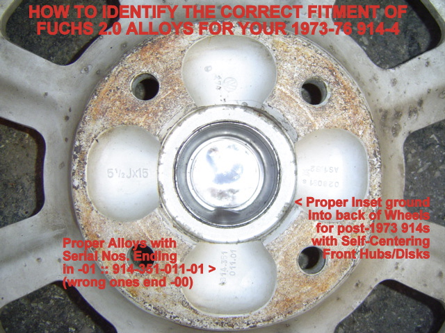

Richard - either or both could be painted factory wheels, so pull one or all & check for part nos. in the cupped insets in the back for ones starting with 914-xxx-xxx-01.
Fuchs 2Ls would be correct for your 73 2L, unless you have a Certificate of Authenticity or original window sticker &/or dealer sales invoice stating it had opted for the Mahle baby-gas-burners. If no Porsche 914 p/n, then they're repros.
Here's a pic of the Fuchs p/n on backside -

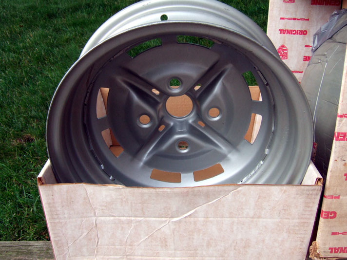

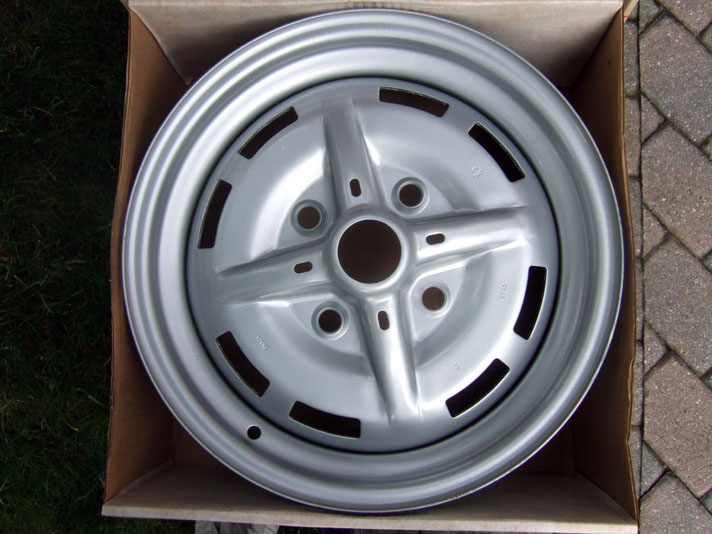

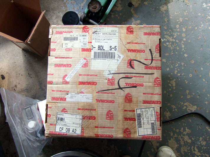

Last two that were available from Porsche. 74 + style steel wheel. Date code of 1/80 on them.
RFoulds
post Jul 8 2011, 08:42 AM
Post #327
914Rennsport
Posts: 871
Joined: 10-August 09
From: La Quinta, CA
Member No.: 10,656
Wow! Interesting that the backs are not black as most of our originally equipped wheels are. In refurbishing mine, I would have preferred to finish them as yours are.

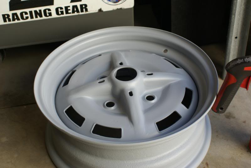

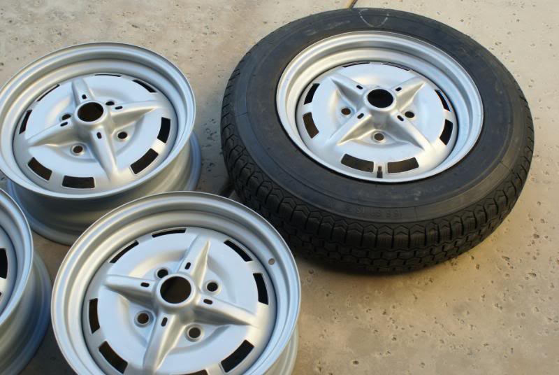

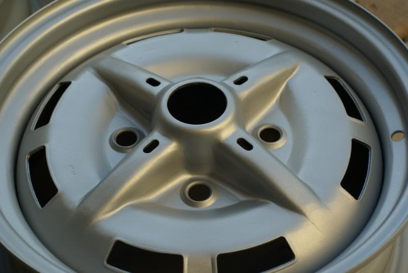

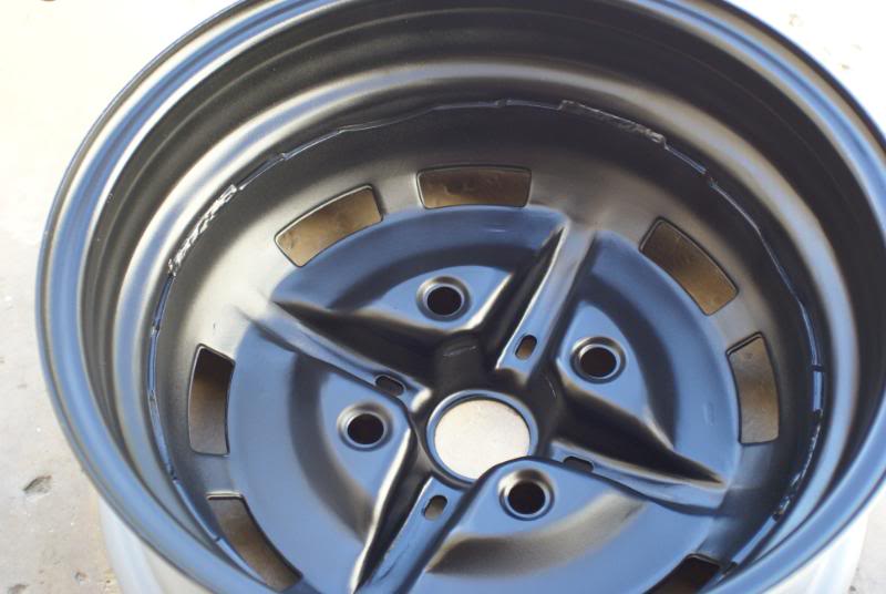

For Tires, I went with the Vredesteins, purchased from Coker Tires.
The wheel process was simple. I had a body shop media blast and then prime them for me. Thye did an excellent job, and all 4 wheels was only $100.
(IMG:http://www.914world.com/bbs2/uploads_offsite/img.photobucket.com-10656-1310142307.1.jpg)
Next, I sprayed the backside with 3 light coats of Wurth Satin Black, being careful to get as little of the black on the face side, to avoid any uneven buildup when I spray the face. I smoothed out any small runs or debri on backside with 0000 steel wool.
(IMG:http://www.914world.com/bbs2/uploads_offsite/img.photobucket.com-10656-1310142307.2.jpg)
Then, I cleaned the face again with a very light 0000 steel wool, and sprayed 4 light coats of Wurth White Alloy. Between each coat, I lightly rubbed them with 00 steel wool, just enough to smooth out any imperfection.
(IMG:http://www.914world.com/bbs2/uploads_offsite/img.photobucket.com-10656-1310142308.3.jpg)
After final coat, I slowly smoothed it with more 0000 steel wool, and checked the backsides to be sure there was just enough of the overspray look. All 4 wheels looked just like the spare.
(IMG:http://www.914world.com/bbs2/uploads_offsite/img.photobucket.com-10656-1310142308.4.jpg)
At that point, I was tempted to spray clearcoat on them, but since the OE didn't have clear, I resisted. Instead, they got a light buff with "3M Perfect-it" light hand rubbing compound, and a finish polish with 3M glaze.
(IMG:http://www.914world.com/bbs2/uploads_offsite/img.photobucket.com-10656-1310142308.5.jpg)
After that, I checked that the Vredesteins had no blemishes, cleaned them with a very mild soap and water to avoid stains, and then had the tire shop very carefully mount then on the wheels.
Thats it!

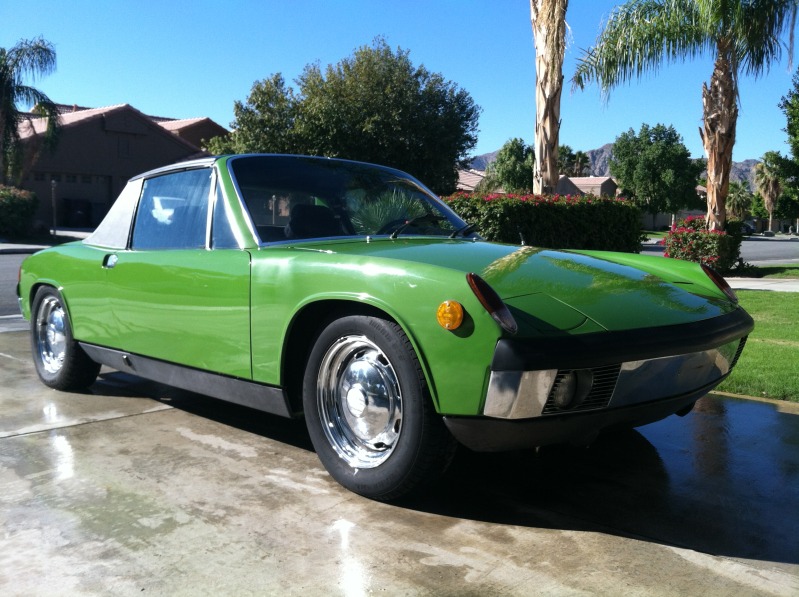

Here I go with wheels again. Different car. 1971.
Any chance a chromed, steel wheel with hub caps was an option?
(IMG:http://www.914world.com/bbs2/uploads_offsite/img.photobucket.com-10656-1352868828.1.jpg)

PM Pat G, he can give you the lowdown & probably ID those wheels.
RFoulds
post Nov 14 2012, 11:22 PM
Post #339
914Rennsport
Posts: 871
From: La Quinta, CA
Member No.: 10,656
he did indeed an early year dealer installed option
