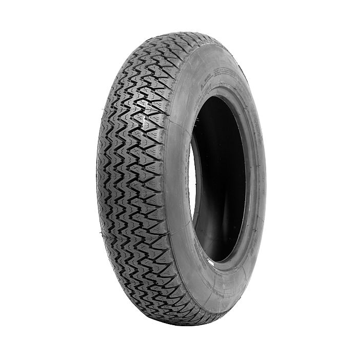

I've been updating folks on the current classic/vintage tire options available now in 2021 at some other posts/topics - so I thought that I'd better put them here in O&H Wheels & Tires Topic too.
A simple google/bing search for 165/80R15 tires for SR, TR & HR or VR speed rated tires - or 155/80R15 for the 1.7L & 1.8L owners only needing SR or TR rated tires - & it now again turns up a variety of serviceable passenger tires in reasonably budget conscious prices from all over - even Tire Rack is again carrying them.
Currently there are the somewhat less budget conscious Vredstein Sprint/Sprint Plus in 155 & 165 & 185 sizes in SR & HR & VR speed ratings which are available a bunch of places - so just google/bing search for your size & type tire to find the best prices & locations for you.
FYI - this Nexen tire is very similar to the 195/65HR14 tires that I've been running on my `85 BMW 325e E30 Coupe with the 2.7L I-6 & 5-spd, and they're excellent all around tires on a heavier coupe with similar power-to-weight & handling to our 914s (which was why I picked it new in `85, when my 914 was whacked). So I'd expect it to handle well in all weather & wear well on our 914s too, but I've not tried them myself. They come up available at many places.
https://www.prioritytire.com/nexen-sb-802-1...CyABEgJtofD_BwE
In the repops of traditional OEM tires that came on our 914s of /4 & -6 flavors - there are Michelin, Pirelli & Blockley's version of the old Dunlop SP57 tires that came on our 914s from the factory.

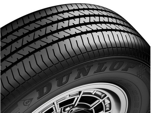

While there aren't any Dunlop made SP57 repops (see Blockley below) - but there are some "not quite classic 60's-70's tread" style "Dunlop Sport Classic" - as well as similar 80's style "Classic" Continentals in the 165/80/R15, 155/80R15 & 185/70R15 tires, as well as in the 14 " wheel sizes for those running 5 lug Fuchs. These look more like the Michi's that came new on my `85 BMW 325e E30 Coupe - so not period correct look - but I'm sure would handle well on the 914s as well in the 155/80R15, 165/80R15, 185/70R15, etc sizes.
https://www.cokertire.com/tires/dunlop-spor...-80r15-87h.html
https://www.cokertire.com/tires/dunlop-spor...-70r15-89v.html
However, the Conti's don't seem to be availble in the USA - so it may be a UK/Euro/Down Under option - or else shipped to the US from there:
https://www.vintagetyres.com/shop/continent...2-165-80r15-87t

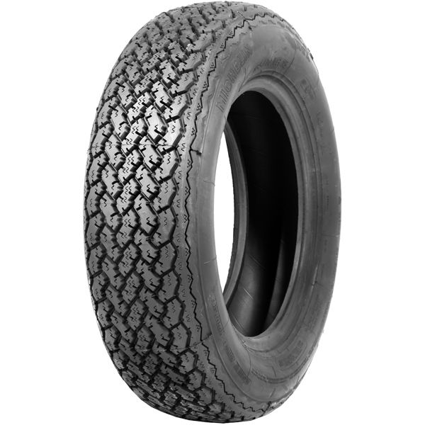

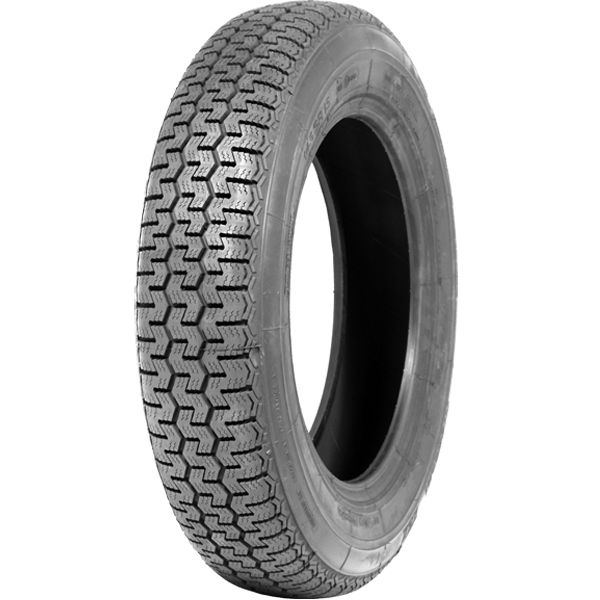

Michelin XAS 165/80VR15, XZX 155 & 165/80SR15 (for 1.7L & 1.8L), XVX & their XWX 185/70VR15 are among my top choices for reshodding my 914 when the resto/renno/repairs are done.
https://www.cokertire.com/tires/michelin-xas-155hr15.html
https://www.cokertire.com/tires/155hr15-michelin-xas-ff.html
https://www.cokertire.com/tires/165sr15-michelin-xzx.html
https://www.cokertire.com/tires/michelin-xvs.html
https://www.cokertire.com/tires/185-70vr15-michelin-xwx.html
Check with Coker or Michelin if you can run the ones noted at Coker as "Tube Type" - without the tubes in a "J" type tubeless tire rim (all of the factory 914 steel, Fuchs, Pedrini & alloy rims are "J" tubeless rims).
However, these XAS Michi are tubeless type, available in our 914 sizes, are Porsche tested "N Rated" & were excellent handling tires back in the day - and even better with the repop's modern rubber compounds. They're the ones that you'll find on the current Porsche AG/PCNA Tire Reccos for our 914s, & are a stock size befitting both 914/4 & 914-6 (also in 185/70VR15).
https://www.cokertire.com/tires/brands/mich...ial-n-code.html
Coker Tire, Universal, Lucas Tires, etc. are all good places to look for the various radial tire options available here in the USA, & Longstone in the UK - but go factory direct for Blockley (see below).

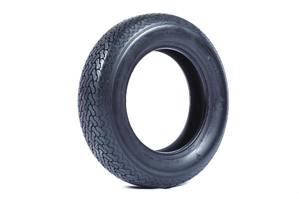

I've also looked at some classic Dunlop-SP57-look Blockley 165/80VR15 & 185/70VR15 with the SP57 & XWX style dogbone tread - but don't know if I can get them here in the States - & OZ may have them. Read their About page to see his attempts to get Dunlop to repop their OEM SP57 tires, & why he ended up doing them for himself.
https://www.blockleytyre.com/product/165vr15
https://www.blockleytyre.com/product/185-70vr15

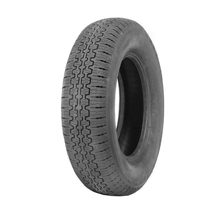

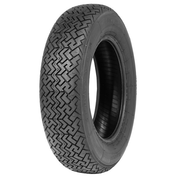

There are also Pirelli Cinturato Classic tires in the USA & UK (& probably OZ & NZ too) -
https://www.cinturato.net/pirelli-classic-tyres.html
USA - Lucas Tires Long Beach in SoCal:
https://www.lucasclassictires.com/Pirelli-Collection_c54.htm
UK - Longstone Tyres:
https://www.longstonetyres.co.uk/pirelli-collezione.html

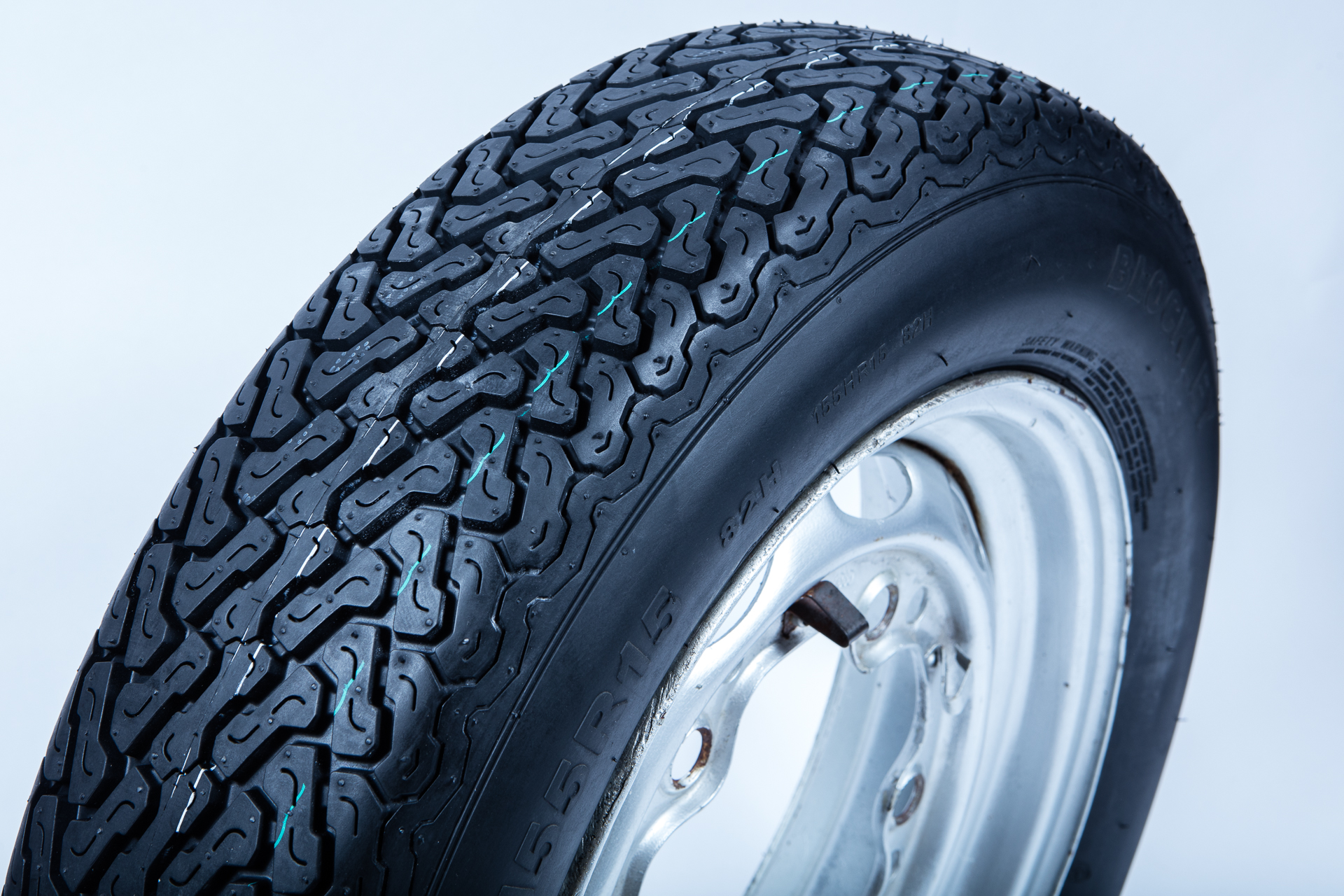

Here's a 3/19/21 pricing update for the Blockley Tyre "Dunlop SP57-look" tires that I referenced in my post above:
<snipped & edited w/ US$>
Hello Thomas,
Yes, these are both tubeless.
All information on these tyres can be viewed on their relevant web pages.
QUOTES BELOW:
Quote 1 for 165/80VR15 for stock 2.0L 165HR15 (/80):
5x 165VR15 Blockley Tyres @£99.00 each = $137.31 as of 3-19-21 Exchange Rate
(comparable to Vredstein etc. prices for 165/80HR15 here in the USA)
For 5 tires = £495.00 = $686.57 as of 3-19-21 Exchange Rate
1x Delivery Charge = £220.00 = $305.14 as of 3-19-21 Exchange Rate
Total = £715.00 = $991.71 as of 3-19-21 Exchange Rate
Quote 2 for 185/70VR15 optional factory upsize:
5x 185/70VR15 Blockley Tyres @£139.00 each = $192.79 as of 3-19-21 Exch. Rate
(comparable to Vredstein etc. prices for 185/70VR15 here in the USA)
For 5 tires = £695.00 = $963.97 as of 3-19-21 Exchange Rate
1x Delivery Charge = £240.00 = $332.88 as of 3-19-21 Exchange Rate
Total = £935.00 = $1296.85 as of 3-19-21 Exchange Rate
<end snip>
I'm not sure if they will charge the local State Sales Tax, or if you will have to report & pay it yourself (California requires it at your annual Tax Returns).
If you're in the UK or EU - then you'll have to check with them for how they're doing the VAT now post Brexit, so check with them for anything else for you other ROW buyers.
They also sell the stock 155R15 in HR - for those wanting to keep their 1.7L or 1.8L914/4 looking stock, but I didn't get prices for them.
https://www.blockleytyre.com/product/155hr15
(IMG:http://www.914world.com/bbs2/uploads_offsite/www.blockleytyre.com-10181-1616203474.1.jpg)
This is why Blockley & not Dunlop is making these:
https://www.blockleytyre.com/page/blockey-t...company-origins
https://www.blockleytyre.com/page/our-products
https://www.blockleytyre.com/category/radial-tyres
(IMG:style_emoticons/default/type.gif)
Contact Lee Hillsdon at Blockley Tyre (dot com) for more info & orders:
"lhillsdon.blockleytyre" <lee@blockleytyre.com>
Hopefully this helps those looking for the original Dunlop SP57 look tires on their 914s - in either the stock 155 (1.7L & 1.8L), or 165 (2.0L flat 4 & 6), or
Cheers! (IMG:style_emoticons/default/beerchug.gif)
Tom

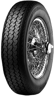

FYI for Comparison - here are pix of the various Classic tread design tires (excluding the generic & non-period tread design tires available) - ignore the non-914 wheels ....
Michelin:
XAS -
XZX -
XWX -
Pirelli:
CN36 -
CA67 -
Blockley:
(similar to former Dunlop SP57 & Semperit M401/M501 "dogbone" Tread):
Dunlop:
(Closer to 1980s era Dunlop Sport)
Classic Sport -
Vredestein:
(Closer to 1960s-70s era Jaguar XKE, Austin-Healy 100/3000, etc. Brit sports car tires to my eye)
Sprint Classic -
You'll need to check both the load rating (2-digit number) speed rating (Letter - with the "R" in "HR" etc. indicating Radial Tires) on all tires of all brands to make sure that they'll be adequate for your particular 914's rated top speed & their +/- 2270 lbs total weight ( divided by 4 - or by 2 if you want to be safe jacking on one wheel for axle weight).
The Speed Ratings were for the 1.7L & 1.8L /4's good with SR or higher, & the 914-2.0 & 914-6 good with HR or higher - & VR is higher than HR - and technically the "T" & "U" speed ratings that came along later are okay for the 914-2.0 top speed rating, but not for the 914-6.
Tire Rack Speed & Weight Ratings Tech Page:
https://www.tirerack.com/tires/tiretech/tec...e.jsp?techid=35
Tom

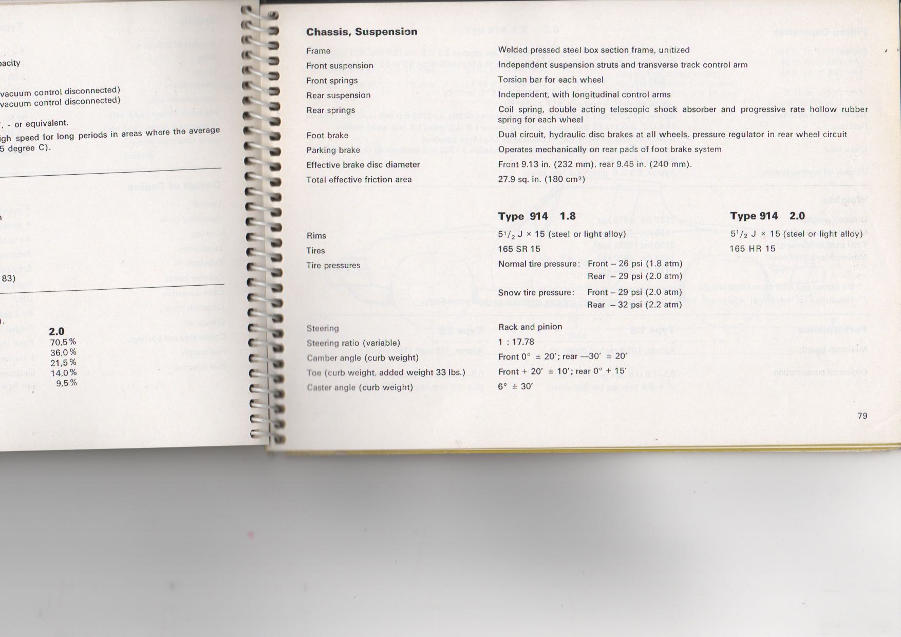

74 owners manual with rim/tyre specs.

Thanx for the update & manual specs pic Wonki.
So I update my 1974-75 914-1.8 OEM specs above to 165SR15 (/80) - for those looking for OEM spec tires, or you can also go with HR & higher speed rated tires too, as I'd noted in prior posts above.
Note that Wonki has a USA 74 914-1.8 bought out of Chicago years ago, so the manual page is from his USA owners manual FYI.

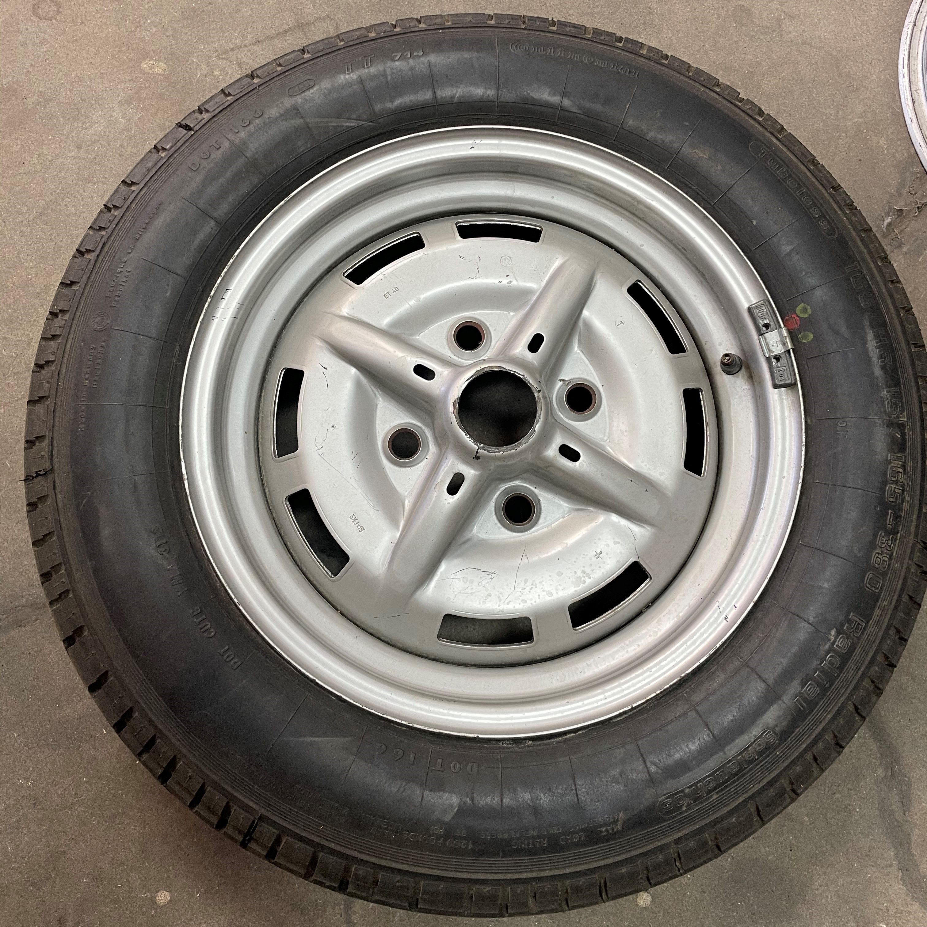

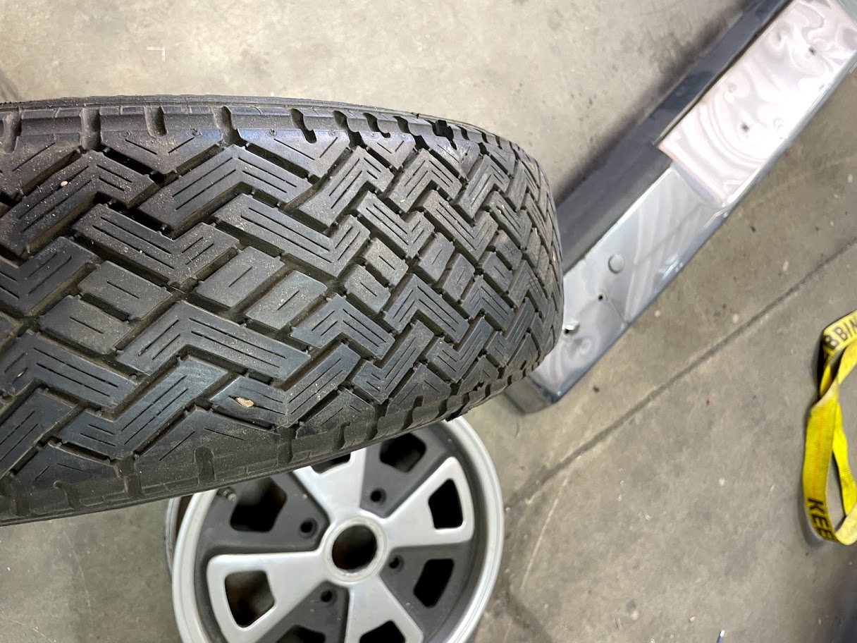

914 OEM Continental TT 714 Tires
ID Photos for 914 OEM Continental TT 714 Tires in 165HR15 (/80) Tires from a recent 914world classified for this never uses spare, for those who had them:
Note that this tire above is mounted on the factory OE 1973-76 "Star" or "Mag Style" Steel Wheel, and was believed to be a never used spare, given the still intact casting nubs.
Former O&H Forum Moderator Pat Garvey had Continentals on his 72 914/4 (1.7) when he bought it new - so maybe he can confirm if these were the same as on his 914 from the dealer. The tires & wheels in his pic below are not the originals.
And if I've got the wrong OEM original factory fitted Continentals, then please post pix of the originals in here.
Tom

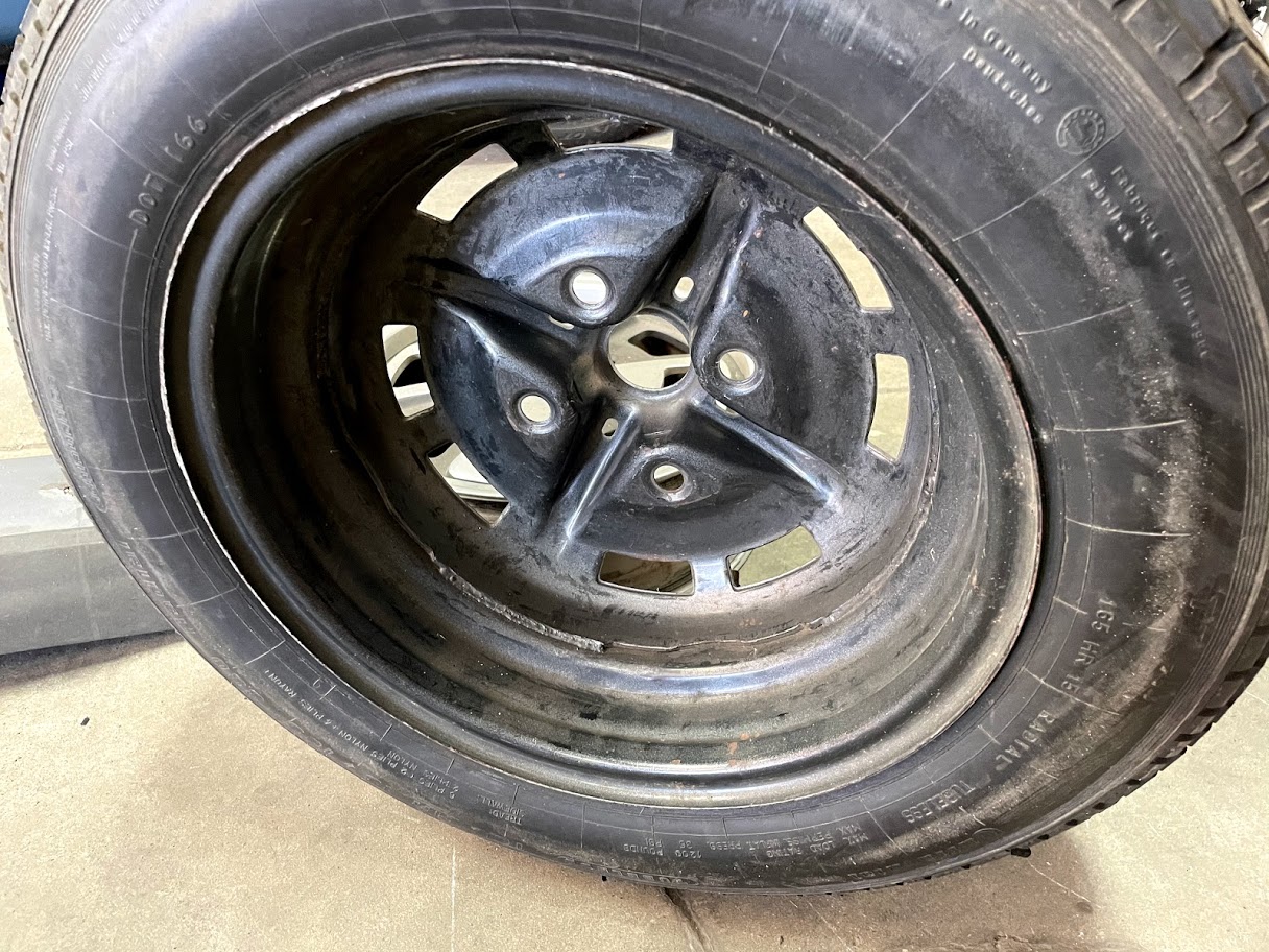

While I can afford to put original spec tires on my BB, the two other cars developed flats on left rear. All tires are well out of date. I never really like the 165 size, and have gravitated to 185 for 30 years. So today I purchased some Continentals in the 185/65 HR15, and will have to suffer the smaller diameter and the non-originality, but they were under CAD100 each. Somehow they will have to protect the Fuchs from damage. And yes, I realize I am the moderator of the originality forum, but sometimes feel the need to tweak things.

QUOTE(davep @ Mar 24 2021, 08:19 PM) *
Dave,
Can you please post a link to those tires, & pic(s) of it for tread & sidewall id for the folks reading here for tires, & note if they're also available in the 155 & 165 & 185/70 flavors.
I wasn't able to find any current Conti's in the old school 155, 165, 185 sizes except in the EU sellers for my tires updates above.
Please also reiterate the ghost mileage warning in that post so that folks are aware, & use a tire size calculator to know what % it will be.

In addition to a modern tread Pirelli (always expensive from Pirelli), there are several 185/70R15 economy priced tires from Radar, as well as other Dimax Classic sizes - at this link:
(IMG:http://www.914world.com/bbs2/uploads_offsite/s3.amazonaws.com-10181-1616704377.1.jpg)
I don't know if these are available in Canada for Dave & others up there.
I'm sure that searching online will turn up other more budget minded 185/70R15 tires for that that don't want to break the bank, as with the top line Michelin, Pirelli, Dunlop, Continental, etc. big name brand tires, or of the 2nd tier ones like Blockley, Vredestein, etc. tires.
