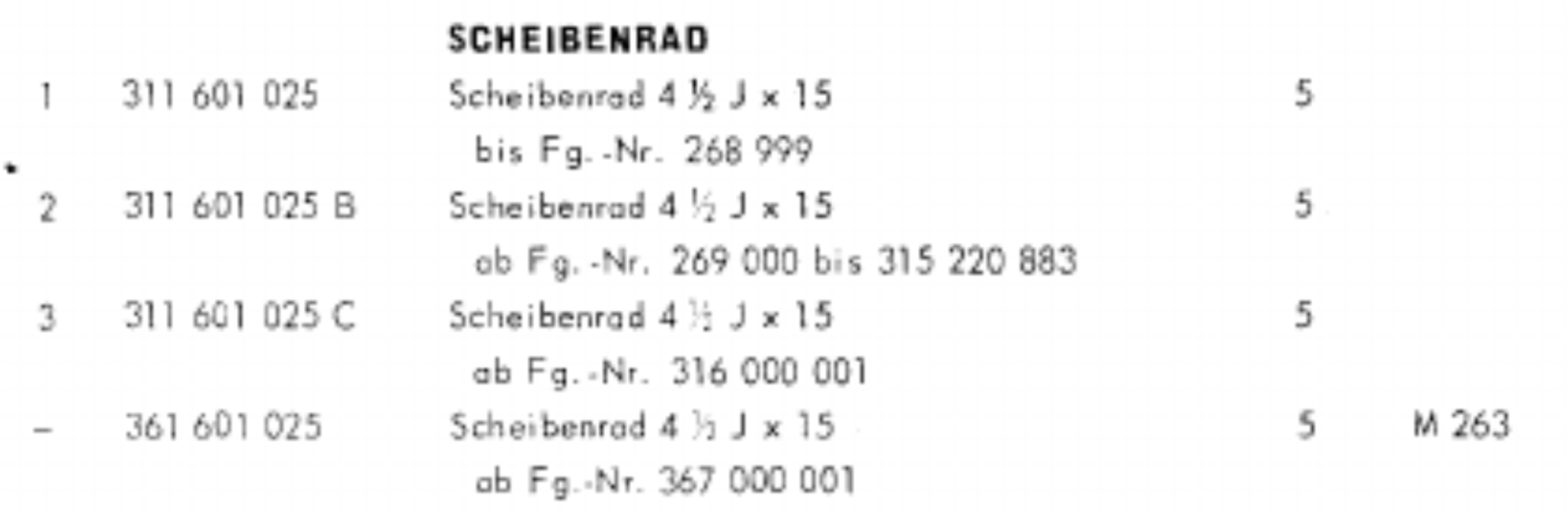

It took me awhile to figure out about the 4.5 inch early steel wheel offsets and I think I have it here. Looks like they are the same as 69 – 74 Ghia wheels, a 46mm offset. I wish they had type 3 wheels listed as I think they are actually from the type 3, not sure which years. Part number 311 601 025 C.

nice chart @nathanxnathan .
i think the 4.5s are type 3 wheels as you surmise. they are listed as 311 601 025J in the parts catalogue for the 914. not sure what variation or version J means. just minor update is all?
when you go on VW classic germany and look up the parts catalogues for type 3s the wheels are listed as 311 601 025C. same wheel on a 411/412 as well. i think it stops at C on those catalogues just because they are older catalogues they have on line which only go to the c version listing. but anyway 914 catalogue says its J version.
after that the wheels are all 5.5s with 40mm offset. same for star steelie version.

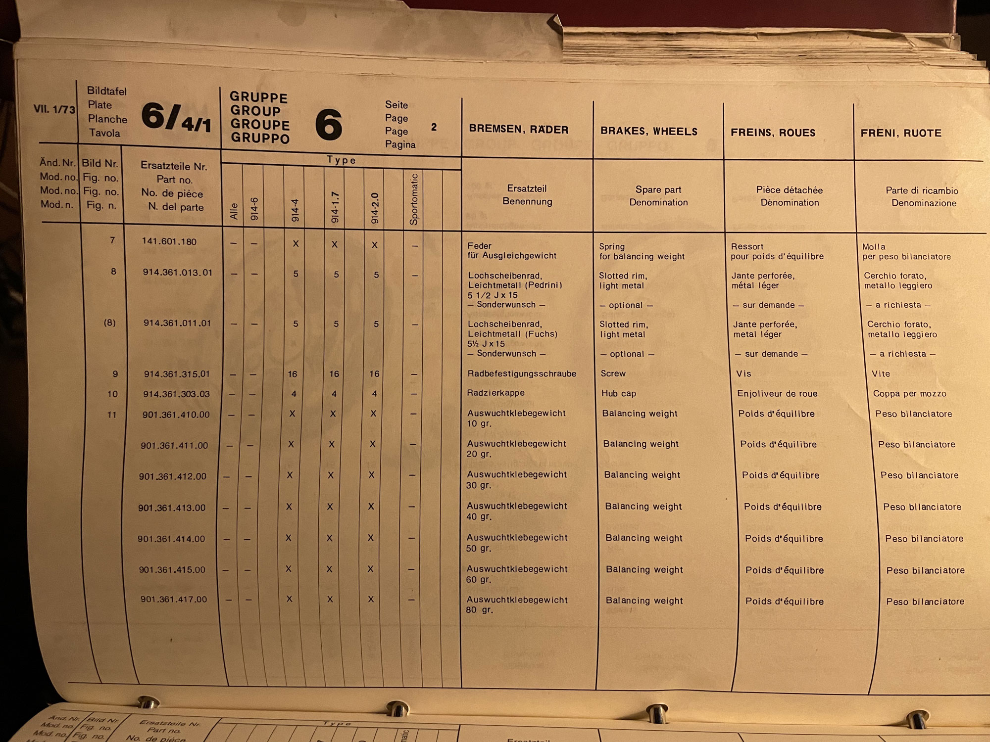

On page 5 of this thread (15 years ago lol) DaveP said
QUOTE(davep @ Sep 23 2007, 08:37 AM) *
We have the 4.5" & 5.5" early steel painted, 5.5" early steel chrome, late styled 5.5" painted, Pedrini, Fuchs and Mahle alloys, Pedrini and Fuchs for the non hub-centric as varieties, and two LE varieties of the Mahles for the 914/4. I'm not sure how many of the early steel wheels were tube type rims; the 'J' designation is for tubeless varieties. I believe everything from at least 1973 MY on had tubeless rims as standard.
I think later it was stated that there are some safety concerns about running radials on anything pre 73, the J wheels for tubed tires, but I'm not super worried. I'm looking for some 4.5 J x 15's for my project. My ocd side is willing to wait for a 8/69 – 7/70 date matched set but we'll see what comes up and keep looking for now (IMG:style_emoticons/default/smile.gif)
Edit — I thought you were talking about the J in 4.5 J x 15 — but you meant in the part number. I'm assuming you have a vintage copy of the 914 parts catalog?

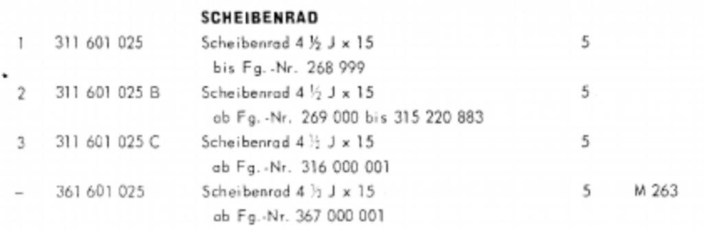

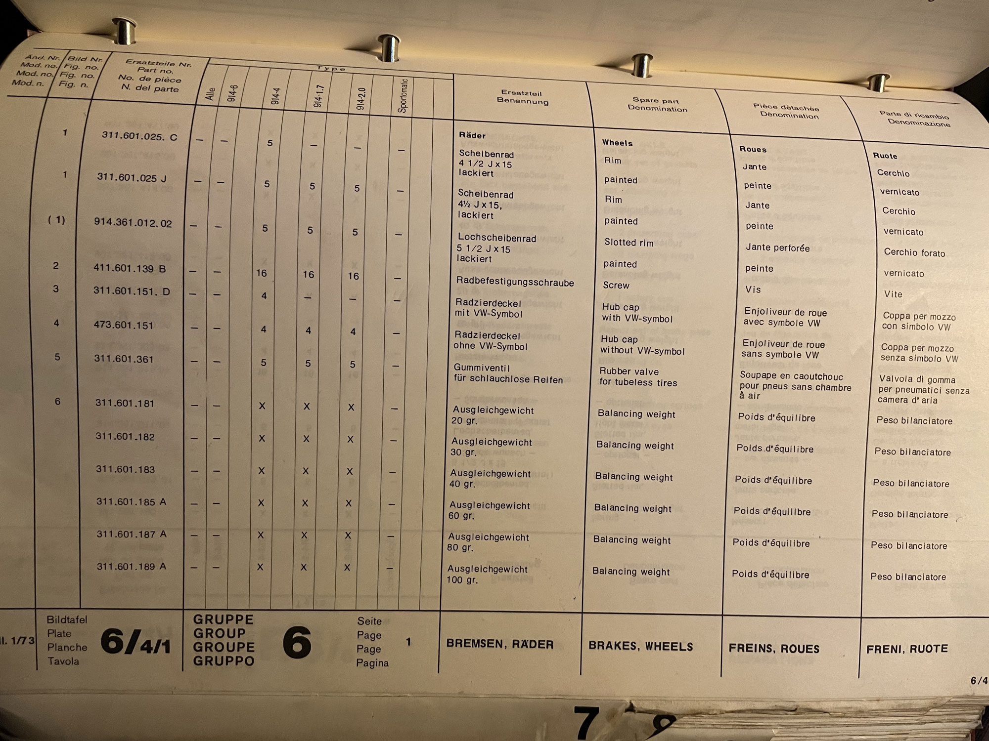

Ah, nice! I didn't realize the German Classic Parts site had "Ersatzteilkataloges"! After looking at the type 3 one, I realize the "TL" and "Variant" at least do refer to Type 3's — I'm still a bit confused about the name of type 3's, like they call a notchback a "1500" (which is an engine size I would think), a squareback is a "variant" and a fastback is a "TL".
Here's the listing of the wheels in the type 3 catalogue
1 and 2 you can see are wide bolt pattern in the pic
So 3, which is "C" part number and the "–" are the ones. The "–" means not pictured and is for M 263 which ocr traced and translated is
M 263 powerful truck mounts for required payloads 361-388 from chassis no. 367 030 001
316 000 001 is august '65. They don't list 367 030 001 specifically, but it's between August and December of 70.
That catalog only goes to the start of the 72 model year and type 3's were produced until 73, so there's some info missing, but it is helpful.
I got pretty good at interpreting the catalogs when I did the "Sliced Bread" bus part finder site.

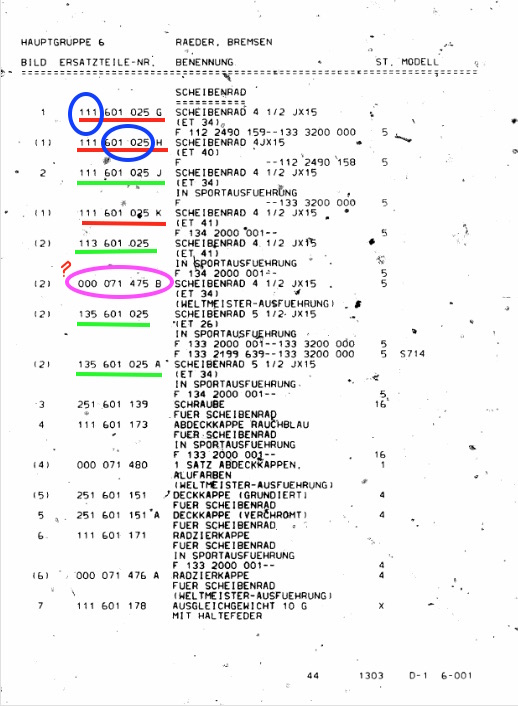

Since I posted I hooked up with the parts catalogue with illustrations — I'm kind of a nerd for this stuff.
It's not as good as I'd like — the VW parts catalogues have like bolt sizes and more info generally. Still it has some interesting info. Here is the only 4 lug wheel illustration. It's weird that they only show a Pedrini and it's dated 1/73 which would be up to 73 model year. They have the 2L Fuchs in the description, the second #8, but not the 4 lug Mahles which I thought they did have in 73.
Anyway it turns out there IS a "J" version — so weird they skipped every version from C until J? Seems the C version was available previous to 73 model year when they just had 914/4, and then they got the J version once they started differentiating 914 1.7 and 914 2.0 which was I think 73 my. I was thinking that may be when they started making the wheels hub centric, though I thought that was just the alloy wheels — perhaps the change was for that.

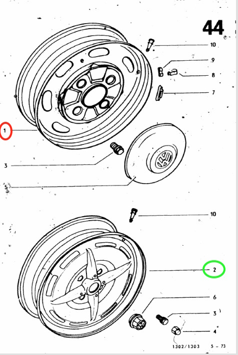

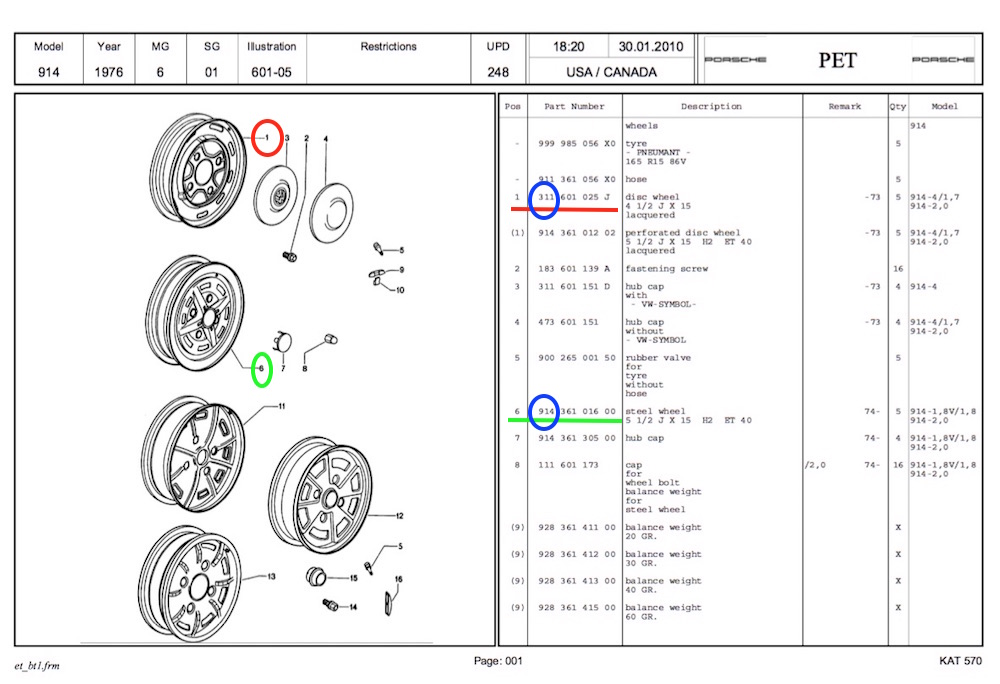

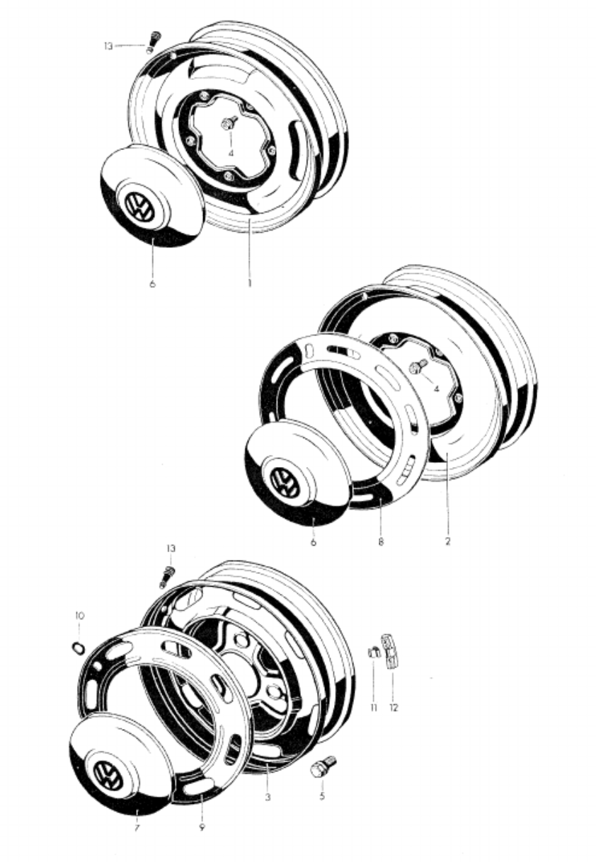

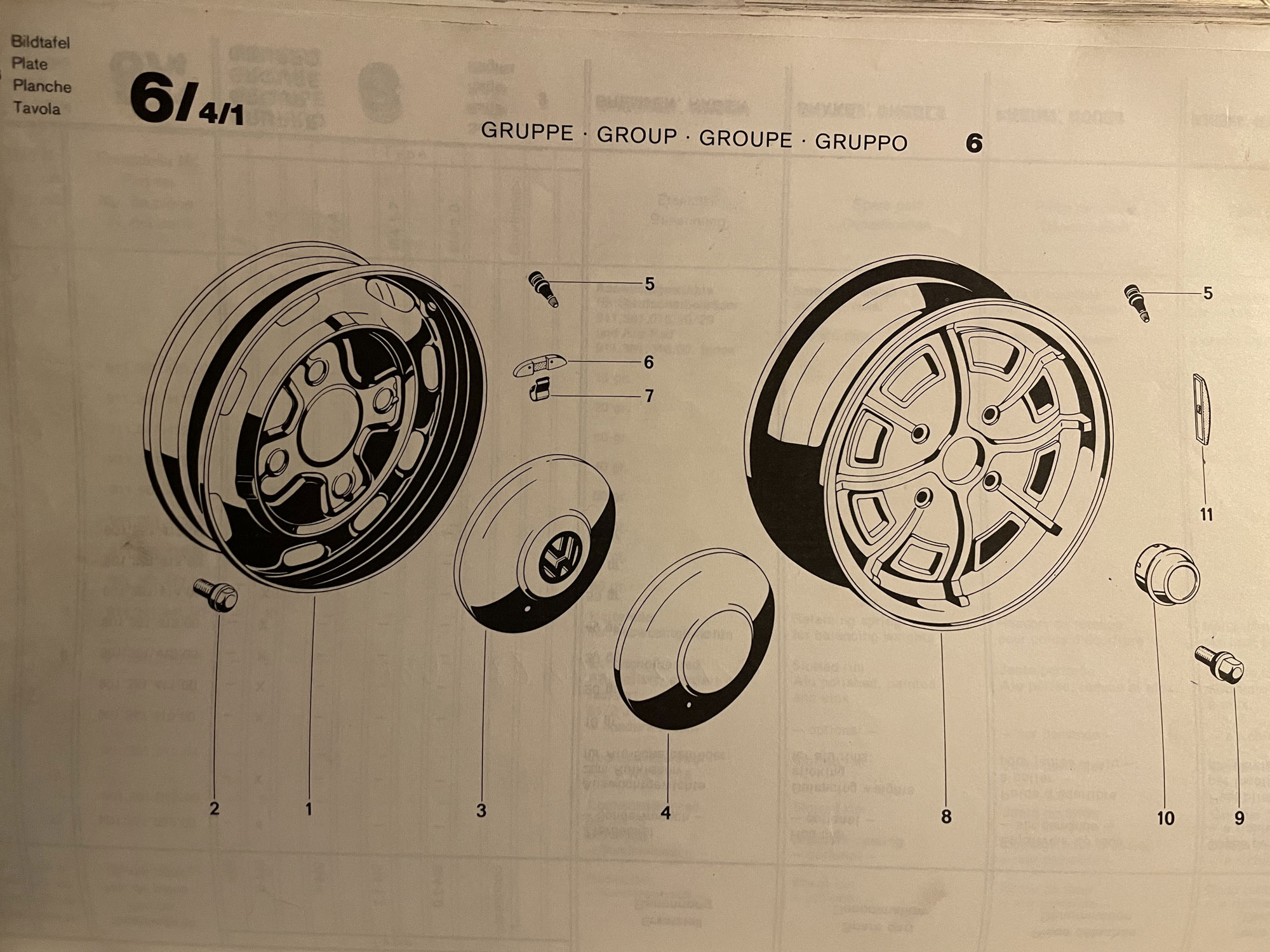

1) i believe that the first three numbers of the parts number sequence are the model the part is first used on. so if its a beetle its a 111. or if a type 3 for instance its 311.
so that is the first thing that can throw you out. some of the missing numbers of the wheel variants are because they have a different first three numbers depending on which model that particular steel wheel was first on.
2) the second bunch of two lots of three numberss describe the part. ie steel wheel.
for the most part the steel wheels in all their variations carry these numbers.
601 025.
i say for the most part, because there are some funny exceptions in there which i cannot explain. these are minor exceptions.
3) the letter at the end denotes the chronological sequence in the evolution or variations of the wheel. no letter = first. A = second.
posted below the pages from catalogue for one of the beetle variants. i think this is from the 1303 catalogue.
whats interesting is the star steelies follow on chronologically from the standard steel wheels with hub cabs. same part number. just a different letter at the end.
when you look at the 914 parts catalogue the star steelie does not get a VW part number - it is given a specific 914 part number. what that means is that particular star steelie went on the 914 first - and is unique to the 914. offsets etc. it is not shared with other VWs. as a result its got a porsche parts # not a VW parts #.
wheels from beetle catalogue
wheels from 914 catalogue
you can see a lot of the variation letter sequence between D and L is there in the beetle parts catalogue. not all. but most. the remaining missing ones are probably in other beetle parts catalogues (there are several) or possible in the bus catalogues?
re type 3s and 1500s and 1600s.
not sure what type 3 s were badged as in the USA for marketing.
but this is how it goes and how we got them in australia where we had the same range as the german market cars right through the production run, including the panel vans.
1500s were the first version for about three years or so.
two models. the notchback and squareback.
the real early ones had a single carb and were awful.
very quickly there was a 1500 twin carb introduced.
maybe only one year of single carbs. 1963 or 64, something like that.
then the 1600 came in.
twin carb. bigger engine.
the fastback was introduced.
1967 or 68. around then.
full range down here was notchback, fastback, squareback (called a variant here).
all had the same engine. twin carb 1600.
towards the end they got extended noses. around 70 or 71.
some D jet fastbacks were sold in australia.
marketed as the most expensive and luxurious version.
called a TLE. the notchback and variant did not get D-Jet.
i used to know a bit about type 3s but it was half a life-time ago.
trivia. the nickname for the fastback in australia was "the pastie".
or pasty as sometimes spelt.
https://en.wikipedia.org/wiki/Pasty
L-Jet914
post Dec 22 2022, 11:57 PM
Post #414
Posts: 419
Joined: 24-October 12
From: Davis, CA
Member No.: 15,080
QUOTE(wonkipop @ Jul 16 2022, 04:11 PM) *
@nathanxnathan
don't apologize for being a nerd.
step up from a wonk. (IMG:style_emoticons/default/smile.gif)
looks like you enjoyed cruising around in the VW classic website catalogues.
they have limitations. all in german so you got work your google translator or speak german! and they are not all up to the very end of the model in some cases and they do not seem to cover particular USA market variations. for instance the USA 412 L-Jet is not there.
you got some good stuff on your files.
interesting variation of parts catalogue you have there.
you got a hard copy?
can help you out with some things re the A B C D E and so on variations i think and maybe how the parts numbers work in chronological sequence.
and its typical VW inside out and back to front thinking.
but it made sense to them probably.
601 025.

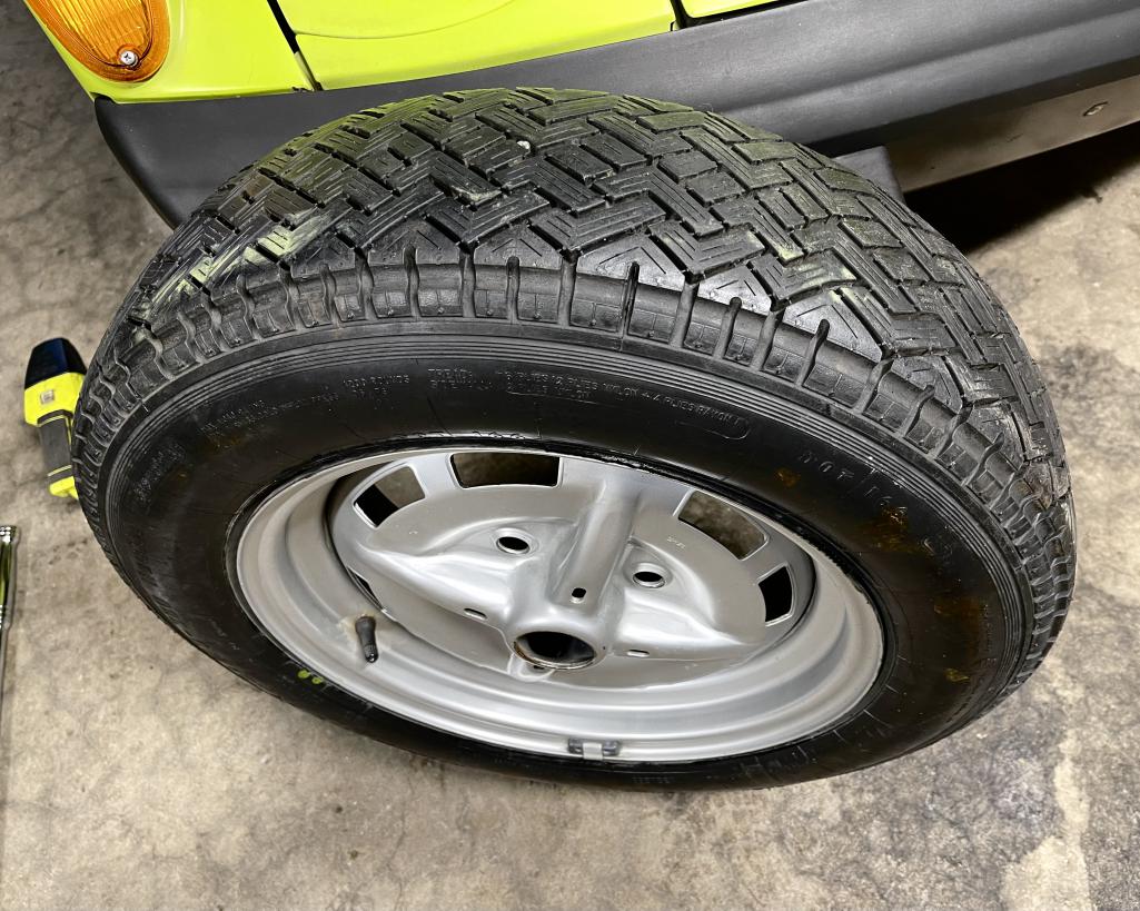

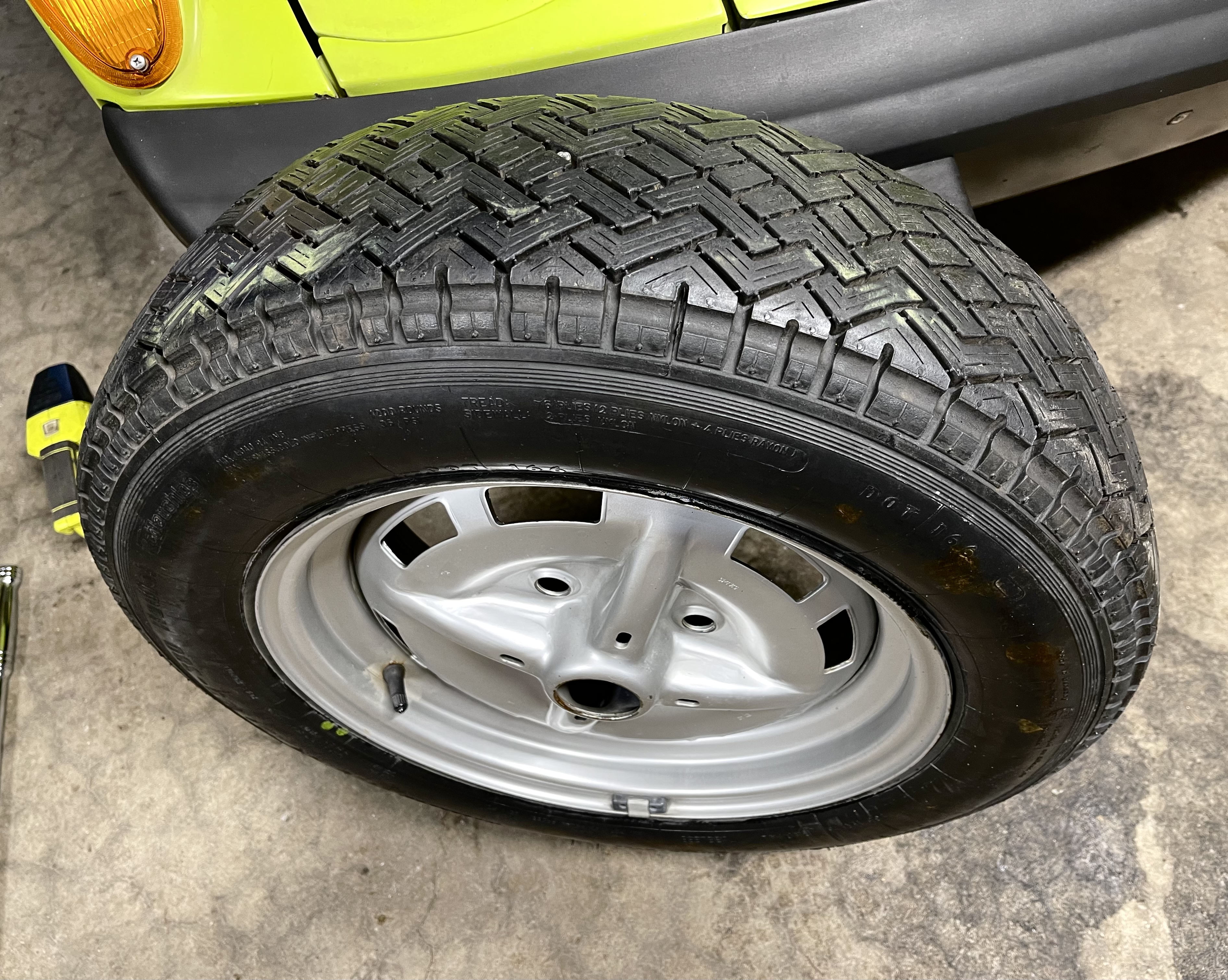

Here’s the spare from my 74. I don’t think I’ve seen these weights before. Is there name for this wheel. The rest of the wheels have been painted black and have old 205/65 tires. They will be refinished in silver and going with 185 Vredestein classics or cn36’s.
wonkipop
post Jan 17 2023, 12:34 AM
Post #416
Posts: 5,693
Joined: 6-May 20
From: north antarctica
Member No.: 24,231
QUOTE(skota23 @ Jan 16 2023, 10:44 PM) *
VW steel wheel from 1974 on.
you have the correct wheels for the car.
commonly referred to as VW sport wheel.
offsets etc particular to 914.
beetles of same era had similar with different offsets.
(see posts above with info on that).
nice choice of tyres for the wheels.
keep those wheels.
they never used to be appreciated but they are so good.
i have a set on my 74 as well and have never been tempted into replacing them with alloys. (IMG:style_emoticons/default/beerchug.gif)
slang for the wheels in USA = star steelies.
here in aus the VW folks called them X rims.
highly sought after by aussie vw nerds as were never on any australian VWs.

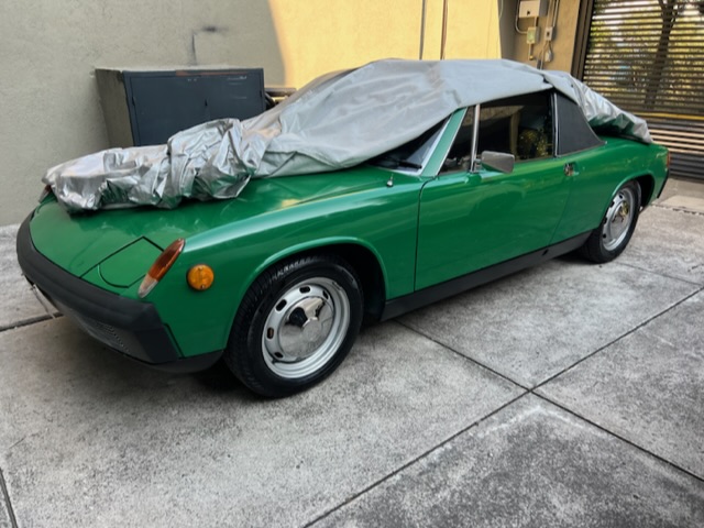

post Jan 27 2023, 09:52 AM
Post #418
Posts: 2,097
Joined: 1-July 03
From: McMinnville, TN
Member No.: 874
What is the correct color and type of paint (metallic, non-metallic, single stage, etc.) used on 5.5 x 15 sport steel wheels aka "star steelies" on a 74 2.0? Also, are the flat plastic center caps for these NLA? Thanks!
wonkipop
post Jan 27 2023, 01:02 PM
Post #419
Posts: 5,693
Joined: 6-May 20
Member No.: 24,231
QUOTE(914rrr @ Jan 27 2023, 09:52 AM) *
outer face.
silver - VW color L97u Grey Aluminium.
or RAL 9007. ask a paint shop for RAL 9007 you should get it mixed right.
(straight up single stage - it was a semi gloss or satin finish originally).
rear face.
black or very dark grey.
the centre caps are flat black plastic press ins.
Pelican Psrts used to have them but look to be NLA on their website.
the diam is 56mm outer.
these might work. close to the very plain originals.
https://www.amazon.com.au/56mm-Black-Wheel-...s/dp/B073SR3Q9J
this variety are available from VW classic parts retailers.
but its the one for beetles. looks like a fake nut.
not what 914s had. but it would fit.
https://www2.cip1.com/vwc-111-601-171-set/
wheel bolts had plastic press on covers. "fake bolts"
pelican still has them.
https://www.pelicanparts.com/More_Info/1116...&DID=201382
also available from VW classic parts retailers
https://www2.cip1.com/stock-steel-wheels/
914rrr
post Jan 27 2023, 03:14 PM
Post #420
Posts: 2,097
Joined: 1-July 03
Member No.: 874
QUOTE(wonkipop @ Jan 27 2023, 02:02 PM) *
outer face.
rear face.
Thanks for all the info !! BTW, if somebody has a couple of the center caps I'd appreciate it !! Condition unimportant.
I did see earlier in this thread where rattle can Wurth or Wyeth White Alloy paint is correct or close.
http://www.914world.com/bbs2/index.php?sho...4857&st=320
I was asking since I have a set of rusty star steelies that I want to put on my car during resto, along with a set of quasi-matching tires that hold air, plastic bolt caps and plastic center caps so it doesn't look quite so janky in the garage when the garage door opens. I currently live in a gated community / leased townhome and need to keep the neighbors happy.
I'd like to put a "10 footer" coat of rattle can paint on the wheels that is "close" to OE but doesn't cost $30 per can. Any tips on a lower cost alternative rattle can paint would be appreciated.
