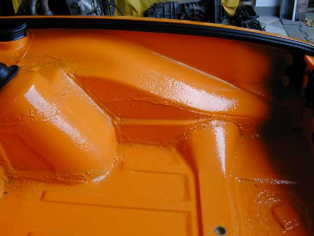

> need your critic eyes: is this a good /6 ?
Gustl
post Aug 21 2007, 12:37 PM
914 enthusiast & historian
Posts: 12,097
Joined: 16-June 04
From: TIROL / Austria
Member No.: 2,212
Region Association: Austria

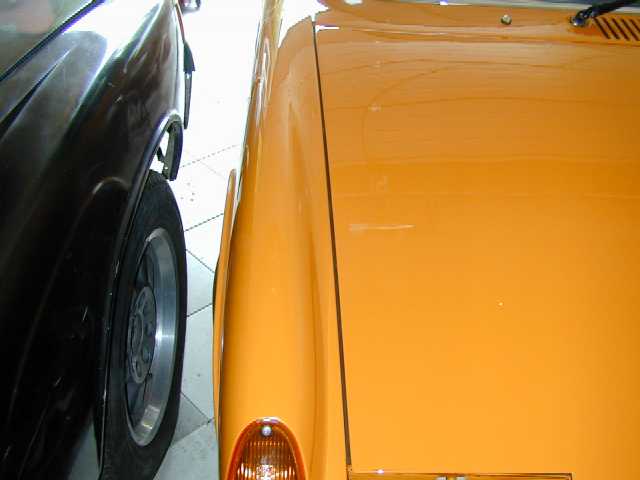

In general this would be a /6 like I want it: MY'70, signal orange, nice overall condition. But as a matter of fact, I'm not good in finding the "not so good areas" of a car. The guy who offered it to me sent me a couple of photos.
I have all of them in high res, but I don't want to waste too much space, therefore I shrinked them.
So, if you need a detail in full size, just tell me ...

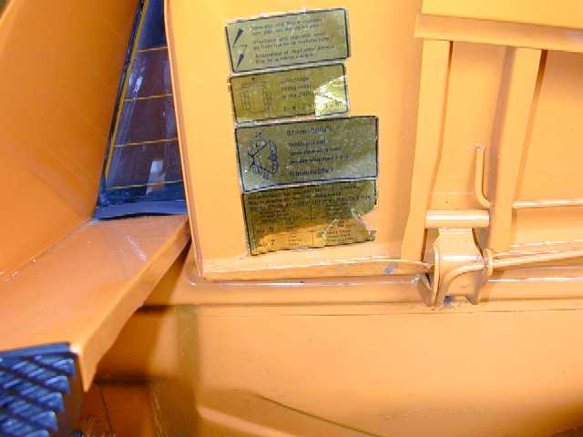

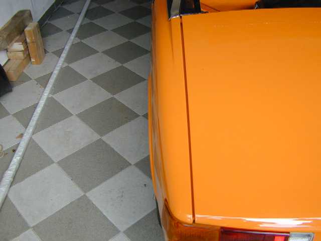

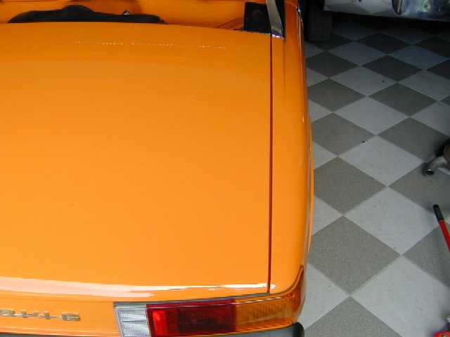

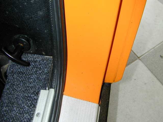

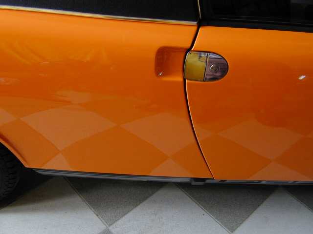

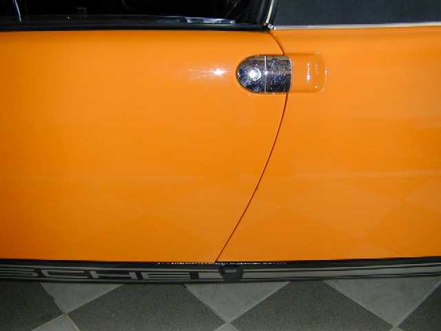

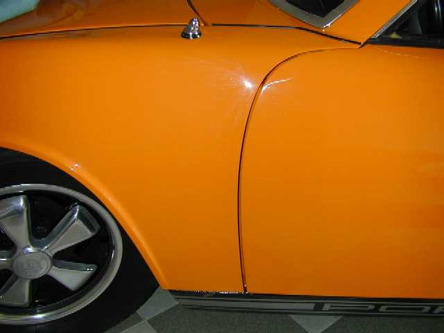

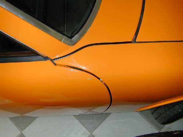

both doors seem to be lowered - is this just an adjustment thing ??
Attached Image Attached Image Attached Image Attached Image Attached Image Attached Image Attached Image Attached Image

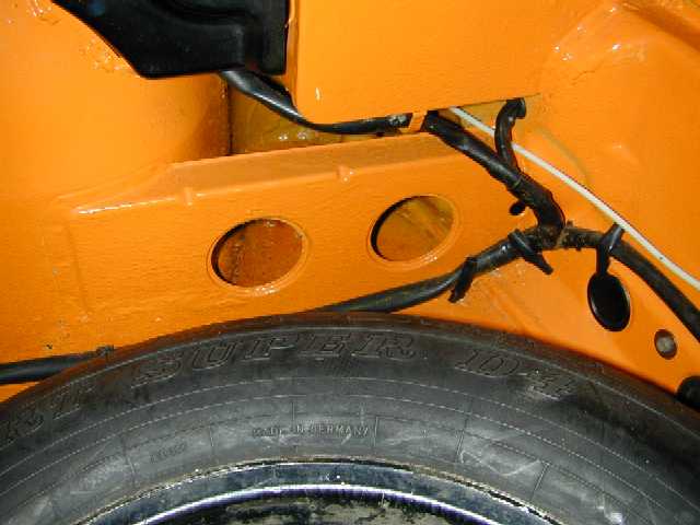

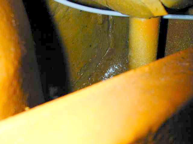

Any pictures of the "longs"? The door sag could be from worn out door hinges or a buckling body, but i dont think it's the 2nd option from the way the hell hole looks it looks more like a heavenly hole.

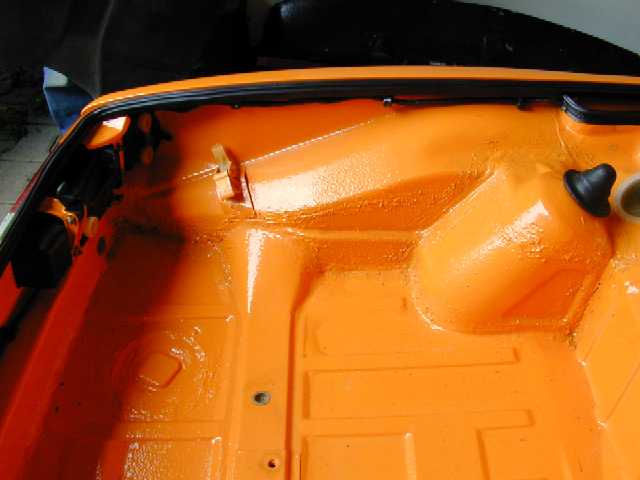

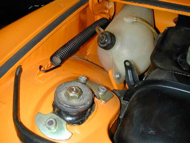

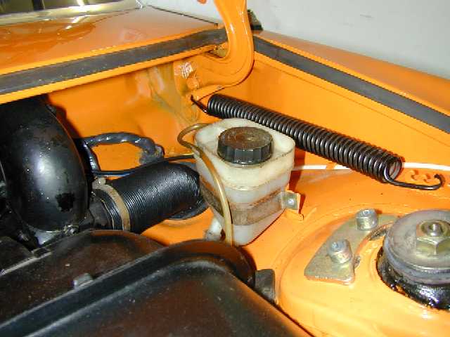

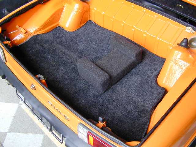

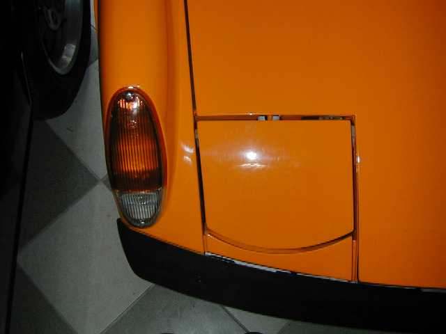

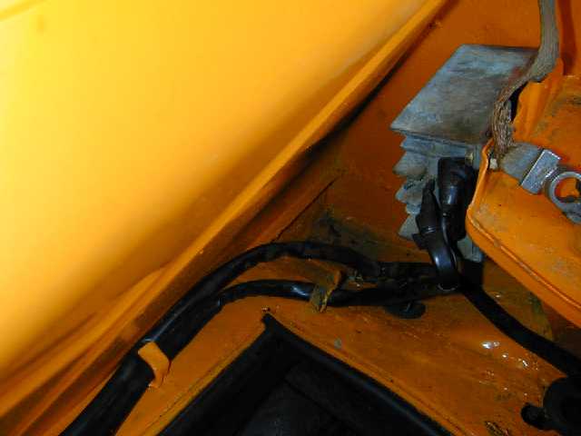

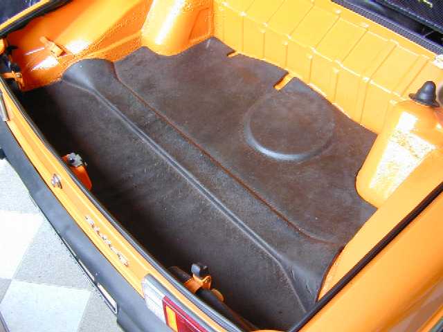

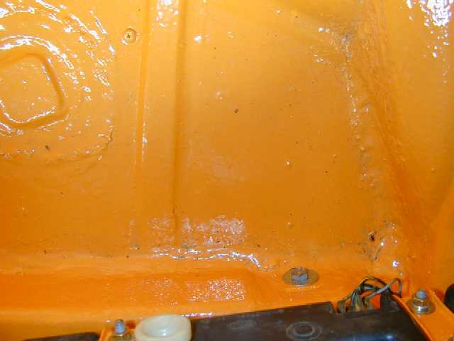

some front trunk
Yes, you simply adjust the longitudinals! (IMG:style_emoticons/default/biggrin.gif)
Looks good on my first pass. (IMG:style_emoticons/default/thumb3d.gif)

QUOTE(dlo914 @ Aug 21 2007, 07:44 PM) *
unfortunately not yet
the guy told me that he has got a car lift, but it currently doesn't work
he will send me additional photos when the lift works
then he will remove the rocker panels to get a better impression of the longs

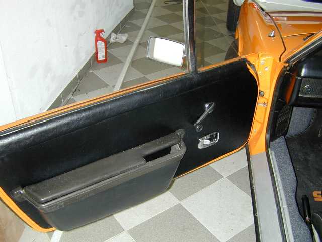

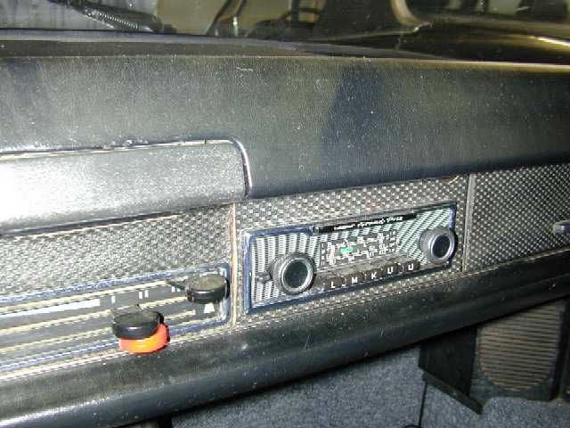

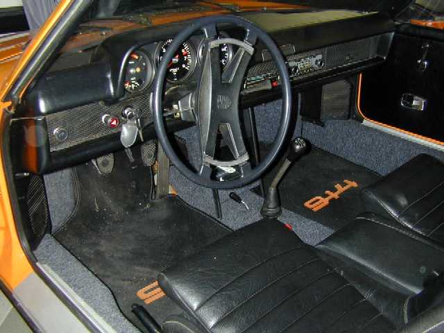

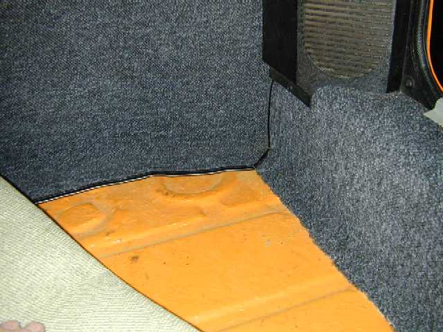

some interior

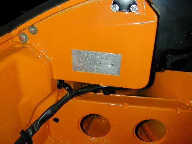

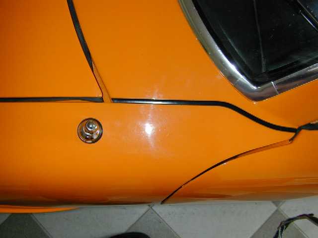

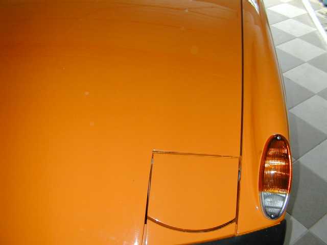

Looks like it has had a extensive full repaint. I would guess any metal work on the longs was done at that time. Nothing jumps out as bad, but door alignment is weird.
Ferg (IMG:style_emoticons/default/beerchug.gif)

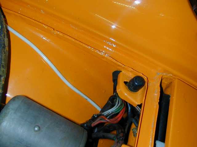

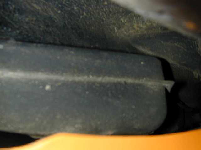

jtf914
post Aug 21 2007, 01:00 PM
Posts: 428
Joined: 31-December 02
From: Burlington, CT
Member No.: 58
(IMG:style_emoticons/default/agree.gif) Definite repaint.

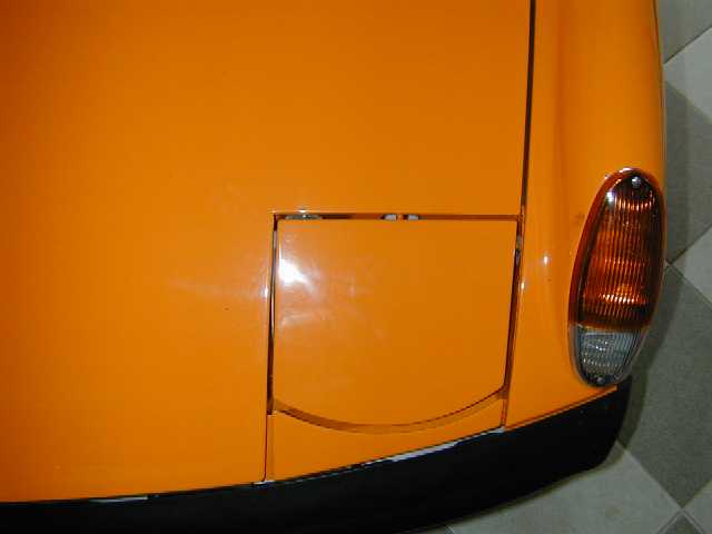

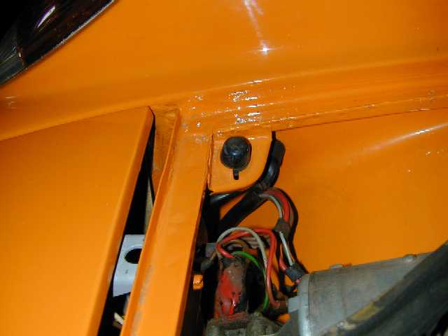

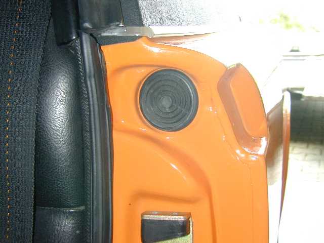

Looks nice, but since you are asking, what's this, repair to the trunk hinge?

Door alignment scares me. You MUST find out why they are like that. If it has structural damage that is making it sag, or if it had damage that was repaired and they didn't line things up correctly during the repair, then that would be a serious concern of mine.
I know first hand about POs being able to hide rust damage and crappy repairs. If I buy another 914, I'm making damn sure it's solid for real.
Gustl
post Aug 21 2007, 01:04 PM
Posts: 12,097
Joined: 16-June 04
Member No.: 2,212
QUOTE(Justin Fischer @ Aug 21 2007, 08:00 PM) *
Looks nice, but since you are asking, what's this:
I've no idea ??
here's the high res photo:

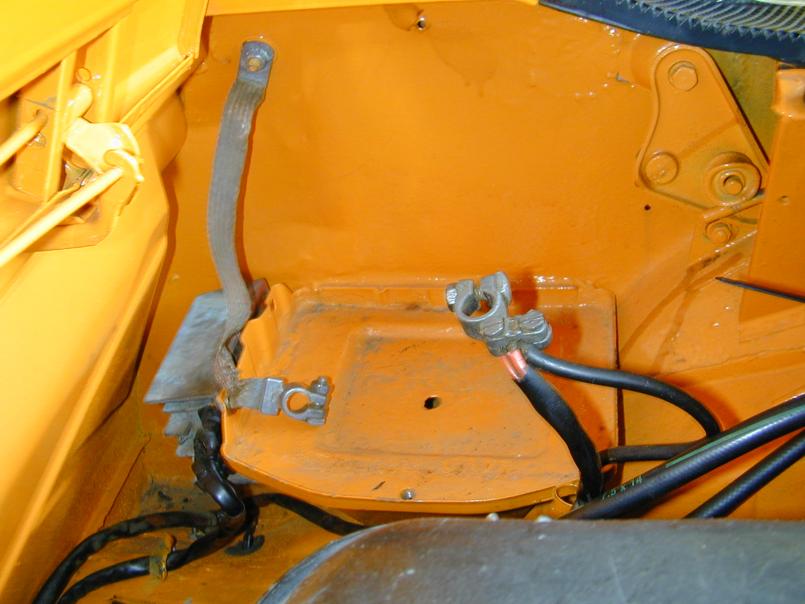

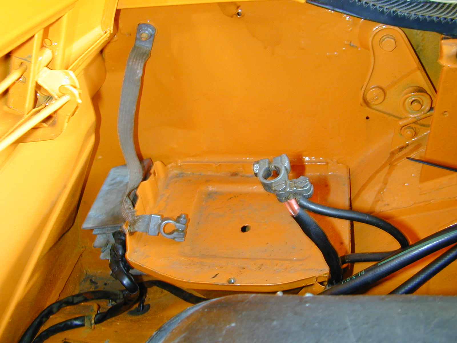

BTW, the battery is missing. (IMG:style_emoticons/default/biggrin.gif)
Looks good from 7000 miles away.

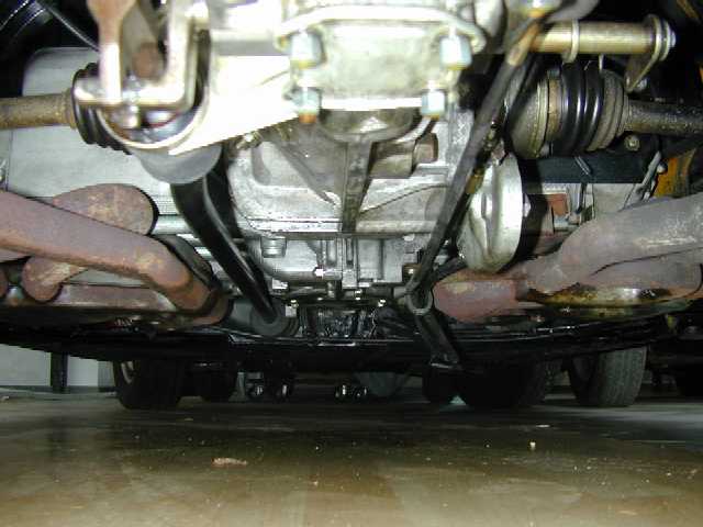

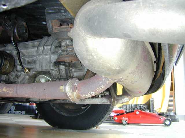

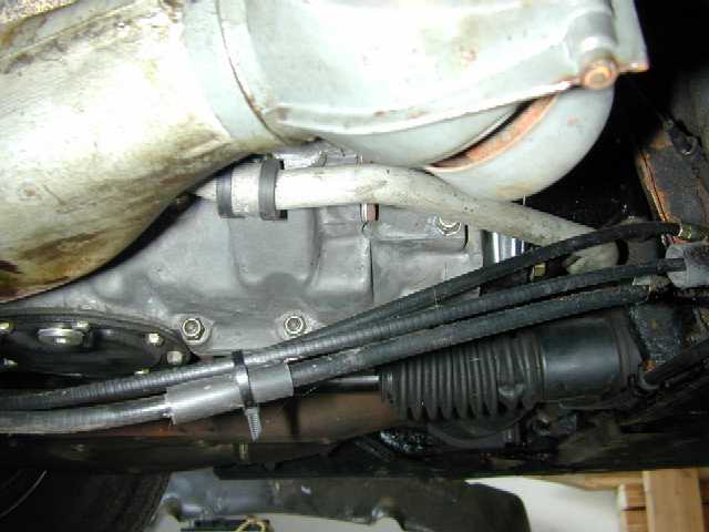

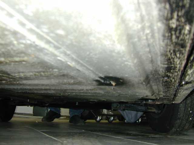

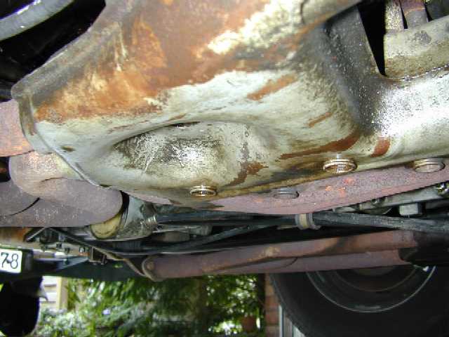

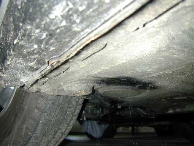

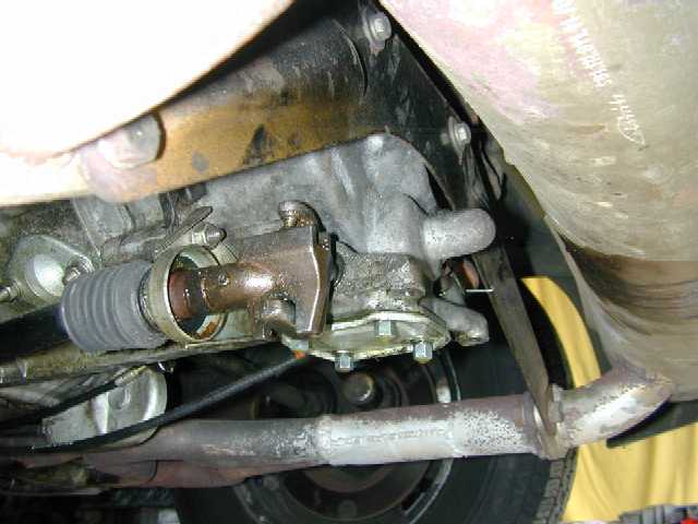

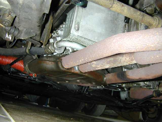

a little "under the car" - without car lift ...
Attached Image Attached Image Attached Image Attached Image Attached Image Attached Image Attached Image Attached Image Attached Image Attached Image
dr914@autoatlanta.com
post Aug 21 2007, 01:11 PM
Posts: 8,233
Joined: 3-January 07
From: atlanta georgia
Member No.: 7,418
I would say that this car was a poor whitewash at best by someone who did not know the cars. I would really worry Still worth 20 grand though

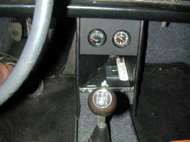

It has been repainted- trunk hinge wheel should be white plastic, not sprayed Orange. Noticed there's no foglight switch on the dash as well. There's still that red six in Richmond I have yet to check out... $25K US

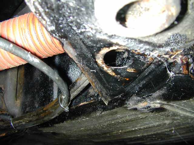

All that after market undercoat, is a big flag that this car "must" have a up close inspection on a lift. Not a car I would buy without really spending some time going over it.
I know prices are more over there, but agree, this is a low to mid 20's six in the states. Assuming all the rust was addressed.

QUOTE(Johny Blackstain @ Aug 21 2007, 08:17 PM) *
that's o.k. - it has additional high beams
that was standard in Germany
front fog lights were available at additional cost

I would want to know why it was repainted and when and possibly by who. Maybe you can contact them to get the real story.
Those door sags bother me. The interior does not look particularly well cared for either.
