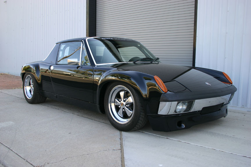

> Does anyone know where to get a front bumper like this, looking for chrome front bumper that fits to gt apron

I have seen a couple of cars with bumpers like these over the years. I think they are SWEET! I am hoping that someone here could tell me where to pick one up.

is it custom (IMG:style_emoticons/default/confused24.gif) ?

If you are talking about the oil cooler opening of the bumper then it is just cut out of a normal bumper and had a plastic trim piece placed around the cut end. If it is something else then I missed it completely.

Yep its a GT bumper and FG is the only other way to get one

Does anyone know a good place in N. California for that kind of fab work on the chrome bumper... then someone to replate it after its done?

that front spoiler is nice too...
anyone recognize where it comes from....
It sure don't look like a regular LE spoiler....

The air dam is called a "Deep LE" and has brake duct holes in it. Several people still sell them. I bet AA has them. I bought mine from AIR about 20 years ago.

If it were me I would get the spoiler or valence and install the FG spoiler with the
cutout and the bumper. Now mark the bumper where the cuts need to start so
the cutouts will meet perfectly. Complete the tracing on the bumper ( I would
make a template from the spoilers cutout.) and find a metal shop with a plasma
cutter. Will come out clean and smooth. Maybe a little attention with some
sandpaper and have it polished and chromed. (IMG:style_emoticons/default/smile.gif)
