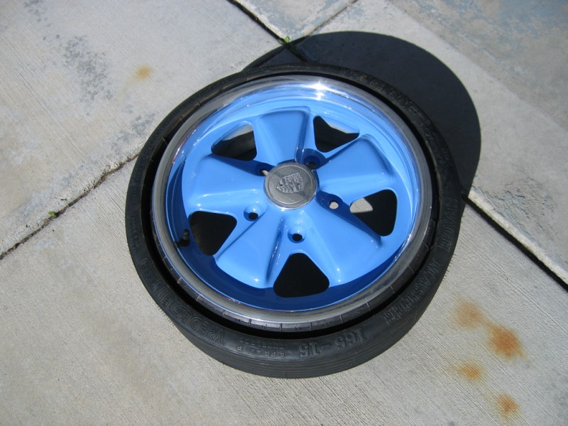

some alternatives to drab boring ......black
