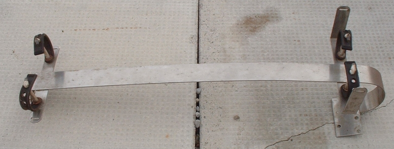

Could be for sale.Attached Image

Dave- how the hell does that thing mount onto the car & is that what the holes are really for?

Yes, they are for ski racks. The one shown is the length-of-the-car kind which uses either side where the 3 holes may be but the the across-the-roof one (made of two pieces) uses the 6 holes altogether.
Do this.
Look under the seal in the front header where the targa attaches to and you will ot two "pits". One long piece of the ski rack attaches to those two "pits" if you want to call it that.
Then the other long piece has attachments with triangular shaped ends that is
attached to those 6 holes (3 holes per triangular piece) by of course metric bolts.
I have a couple of the ski racks that's why I know. When not attached you then use the plastic plugs that comes with the car, either brown or black, to plug the holes.

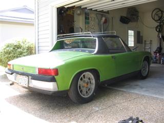

A different style ski rack shown on my friend Larry's car--maybe the type scotty b mentioned? (have to remove the top to install the front bar)
I also had a bike rack that used those same holes for the bracket that held the handlebars.

I don't know if the factory actually offered accessories to fit the car or not. However, that is precisely what the six holes and two receptacles are for. The roof does not have to be fully removed to install the rack, just pulled back about a half inch to expose the receptacles. The plastic cups are there to protect the paint and should not need to be removed. I only know of black cups. Once the nose of the rack is installed into the receptacle, then the roof can be locked into place again, and the rear of the rack can be bolted in place.

QUOTE(anderssj @ Aug 25 2007, 08:57 PM) *
(IMG:http://www.914world.com/bbs2/uploads/post-207-1188100646.jpg)
Do you know what wheels those are on Larry's car? They kind of look like ATS, but different than the ATS wheels I've seen in the past.

QUOTE(euro911 @ Apr 20 2012, 06:40 PM) *
They look like Ronal Kleeblatt wheels.
