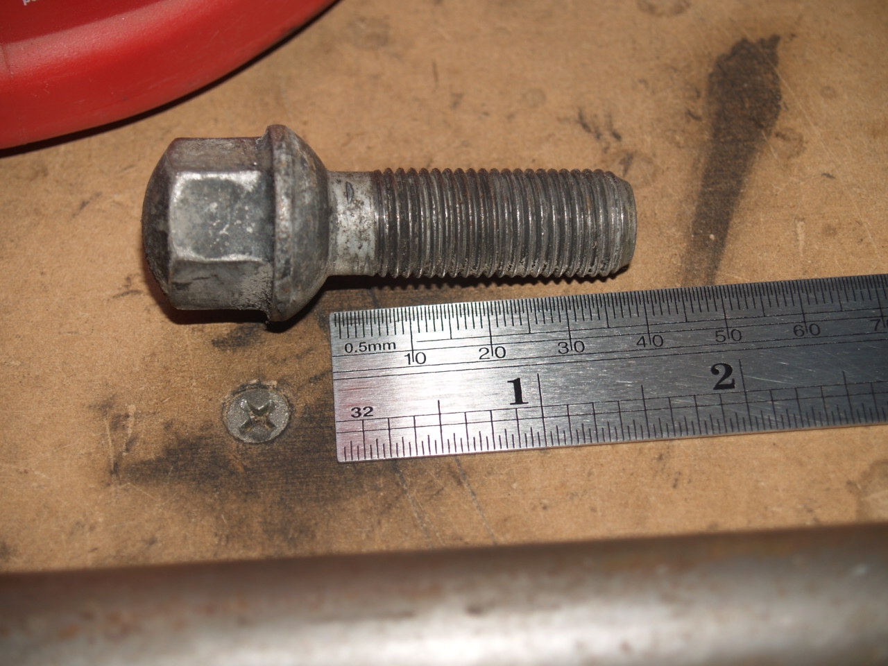

Here is a pic of a "long" alloy lug bolt. You can see that it is just under 40mm long. (IMG:style_emoticons/default/beerchug.gif)

When looking for a possible source, I found this:
http://www.boothedesign.com/boltsstudslugs.html
Looks like you have the 38mm bolts. I'll let you know how mine compare.
Thanks again.
QUOTE(hwgunner @ Sep 15 2007, 08:35 PM) *

QUOTE(HalM @ Sep 15 2007, 06:57 PM) *
Thanks again.
(IMG:style_emoticons/default/beer.gif) Glad to see that mine are the most expensive ones!!! (IMG:style_emoticons/default/beerchug.gif) Careful of cheap aftermarket ones on ebay and around. I think the ball seat is wrong and I also think there is a thread here somewhere about that. As for the bolts, I think I can come up with 16 if you need them but someone else will have to set the price. I sell on ebay so that I don't have to do that. (IMG:style_emoticons/default/headbang.gif)

Jonathan, looks like I have "shorts." So if you have a set of "longs" you are willing to sell, let me know what $$$ you are asking.
