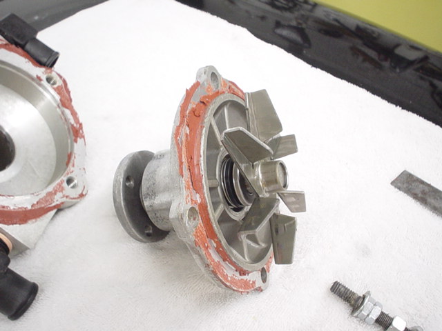

Who's water pump are you using? Since you didn't have bleed holes in your thermostat, there is a chance you damaged impeller if rpm exceeded 2-3000 before t/s opened.
Interesting because my first one from Renegade hit the fan (one of the impeller blades came off so I went to my FLAPS and they found me a replacement out of steel and not aluminum. The pump is a suspect being that the shaft that connects the pully and the impeller might be slipping.

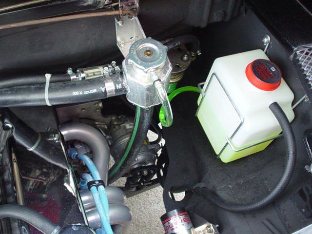

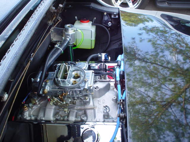

I'm not sure if you know what the function of the holes in the t-stat are for. I was always told the holes would allow trapped air to purge past the t-stat. If the system is air bound it will cause the over heating problems to persist.
Expansion tanks should be mounted higher than the water jacket if possible not lower like in the rear trunk.

(QUOTE) My expantion tank is mounted in the rear trunk. It seems to work properly and levels seem to be normal and consistant.
I would move expansion tank to engine bay and mount as high as possible. This will help eliminate air entering system during cool down. The long length of hose to rear trunk and its low mounting position is not the desired setup.

[QUOTE]Who's water pump are you using? Since you didn't have bleed holes in your thermostat, there is a chance you damaged impeller if rpm exceeded 2-3000 before t/s opened.
(QUOTE) Interesting because my first one from Renegade hit the fan (one of the impeller blades came off so I went to my FLAPS and they found me a replacement out of steel and not aluminum. The pump is a suspect being that the shaft that connects the pully and the impeller might be slipping.
Hmmmmm.......the first damaged impeller was most likely caused by not having bleed holes in thermostat and running engine above 2-3000 rmp before t/s opened. Since you just drilled holes in your t/s, you may have performed the same damage again to new impeller. Unless you measured your old impeller with the new one, I would question if the clearances (impeller to water pump housing) are the same. If they are not, the water pump will not work as designed. Go after this last since it is the hardest of what I'm asking you to do.
The expantion tank is right up against the engine/trunk wall and wouldn't get much higher if it were in the engine compartment. I would say that the bottom of the tank is at about the same level as the bottom of the intake.

It appears you have not been using the right procedure to bleed air from system. Armed with your new thermostat and knowing how to bleed system, you may have found your problem.
The extended distance expansion tank is located from fill point can cause air to enter system. If you used a clear hose to run from fill point to expansion tank, you'd see the air pockets that can form in hose using your method.
See attached:

I doubt your water pump impeller is slipping on shaft. My installed impeller as well as my spare are both made of steel. No aluminum used on impeller..........only water pump housing is aluminum.
