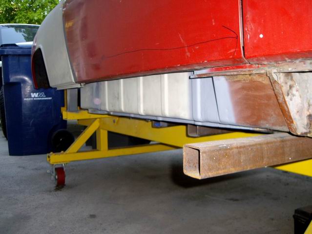

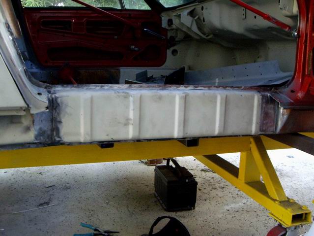

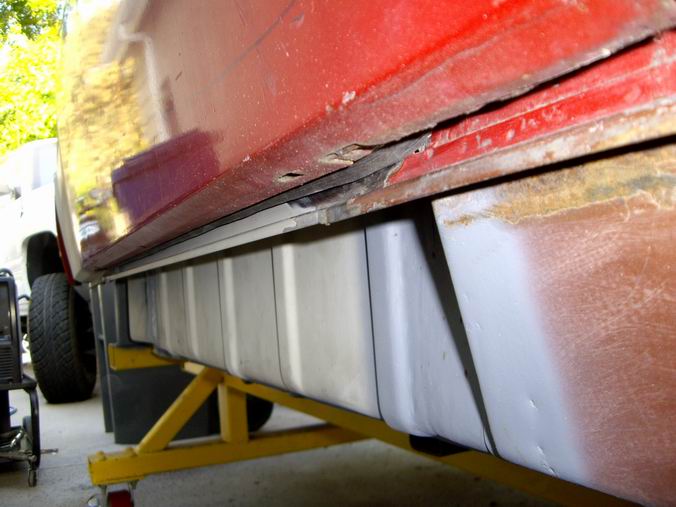

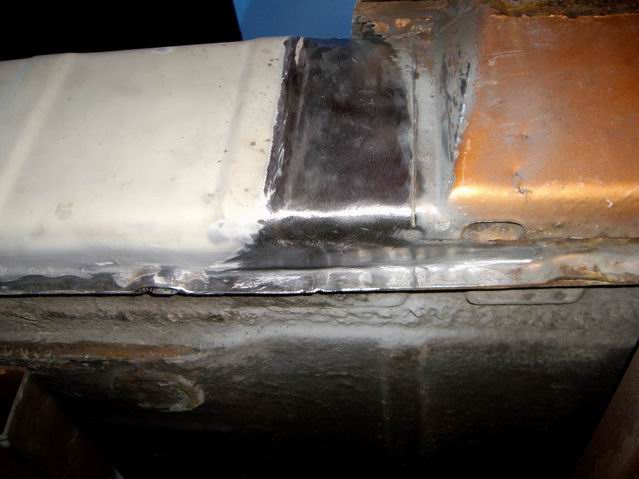

Welded up the right rocker. I plug welded the top from inside the car. No holes were punched on the new outer panel....the lower was done from underneath the car.
First -it's easier welding thru old steel into new metal
Second- no grinding a gazillion plugs on the exterior. No pin holes on the outside to leak.
Butt weld with a backer at the front and seam welded the rear outer wheelhouse (another area that is prone to water because the outer panel faces towards the front of the car)

Can someone clarify if this is what a 914 rocker is supposed to look like?
I am kind of new at this and mine originally came with the translucent iron oxide version! (sick 914 humor) (IMG:style_emoticons/default/av-943.gif)
I also misplaced some measurements I noted somewhere. Now where the hell did I put them? Body panels make great sticky notes! (IMG:style_emoticons/default/dry.gif)

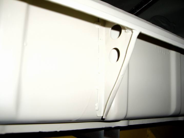

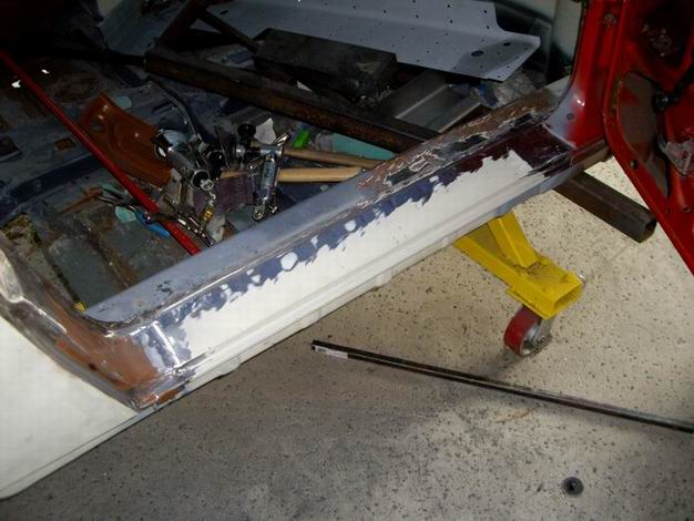

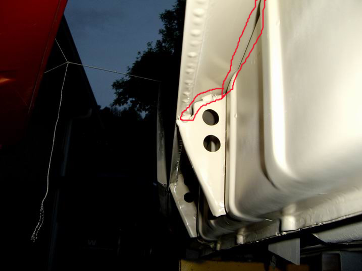

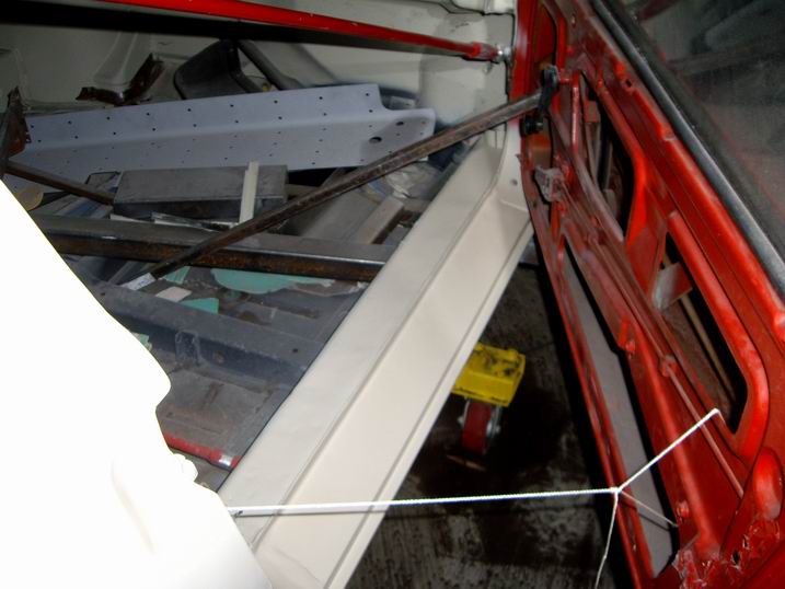

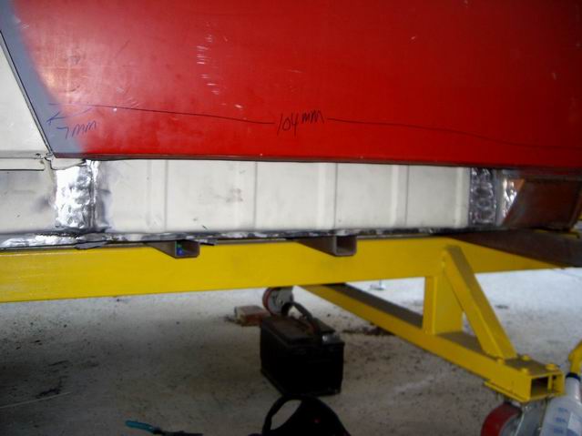

Passenger side sill plate is in.
Ran out of C02/Argon so I couldn't weld the sill triangles in.
Good tip....do not throw out those old weatherstrips. They are still important
when fitting parts such as the sill to make sure you get a proper seal on the door shell.

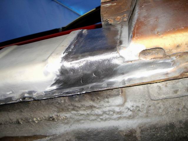

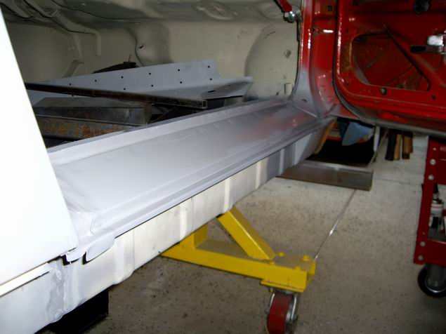

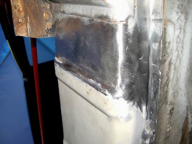

Lite duty this week. Carpal Tunnel sucks.

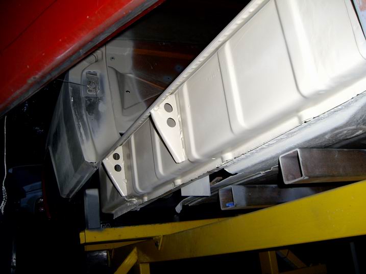

Welded in the sill triangles I fabricated and prepped the threshold area.
Jeff Hail
post May 3 2008, 10:26 PM
Post #245
Posts: 1,141
Joined: 3-May 07
From: LA/ CA
Member No.: 7,712
Tomorrow I will coat the gap where the rocker and sill plate meet with Wurth Seal Fix. WSF is closed cell sealer and semi rigid. Water and moisture will not get past it like the factory sealer.
Notice I installed the triangles flat side forward. The factory should have done this so as not to be a catchers mitt for road debris.

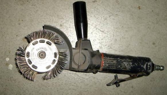

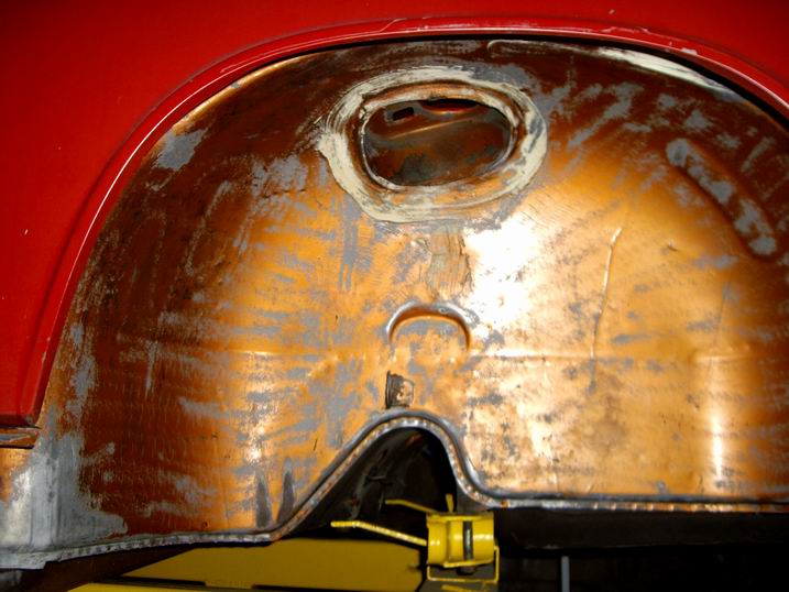

The right tool for the job.
Stripped the right front wheelhouse of its undercoating in about 3 minutes.
Elbow grease....Not!
(Brake Cleaner also works like a charm and strips about everything else in the process if you don't want to invest in one of these.)
What's that called again?
Jeff Hail
post May 4 2008, 02:08 PM
Post #249
Posts: 1,141
Joined: 3-May 07
From: LA/ CA
Member No.: 7,712
QUOTE(Eric_Shea @ May 4 2008, 07:55 AM) *
Wurth DBS 3500 (aka "the flail")

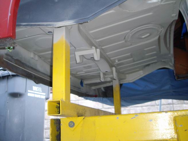

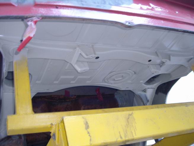

Stripped the underside rear of the tub to metal and epoxy primed.

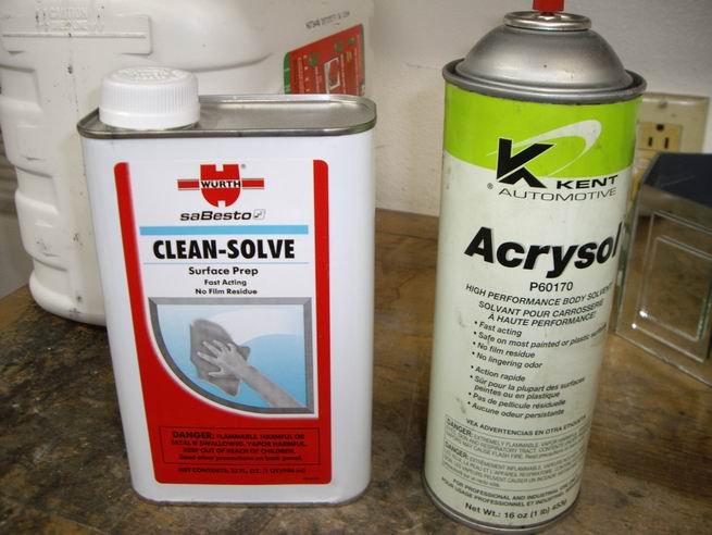

First I used the Wurth "flail" to remove the old undercoating. This also removed the majority of original paint. The rest I machine sanded with a Mini DA and a few spots I used Starblast media (transmount bracktets and crossmember). Then some good old fashion elbow grease hand sanding and some solvent.
I removed all of the seam sealer where the inner wheelhouse/ quarter panels meet the floor at the rear. Needed to see if any issues were under there. None found. (IMG:style_emoticons/default/aktion035.gif)
I did leave intact the sealer where the shock tower pockets are. Just took it down a little to have something to bite into and tidy it up.
The Kent solvent kicks ass.

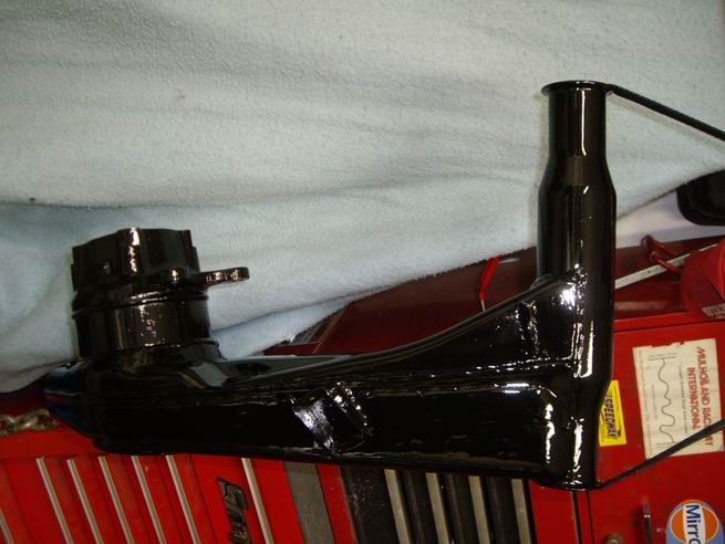

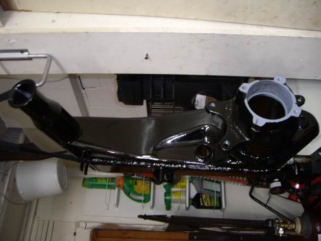

It's midnight and a knock at the door!
Who the hell is at my door at this hour?
Hey dude.... Whoa those came out bitch'n..........
What do I owe you?......A couple cold beer's!
It's nice when the Powder Coater is your bud! Price was right. 2 Stage Powder Coating rocks!

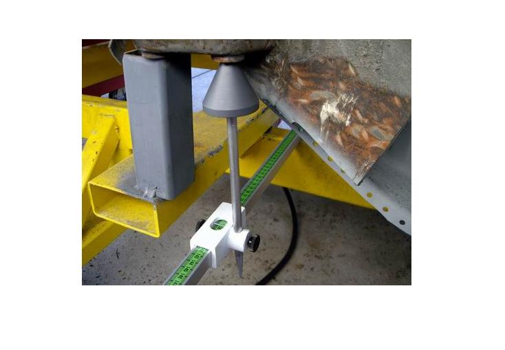

Jeff,
Something I've been meanign to ask...
Who makes this tram gauge?
It looks like something I could use.
Ken
