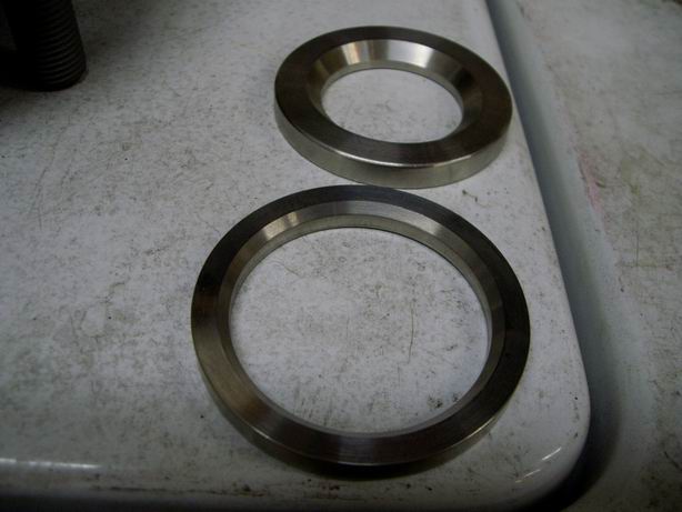

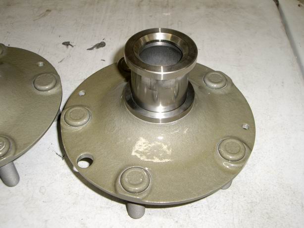

To back up a bit to last weeks intimate conversation. Here are the spacers for using the late Carrera hubs (one inner, one outer on each side of the 914 wheel bearing). Easy enough? Rotors are also Carrera. Depending on going 20mm or 24 mm appropriate caliper half spacers required.
By the way you spelled Carrera incorrectly. Two "R's always come before the single "R". I just wanted to point that out you know. I am sure the bartender or host will volley back with a good jab just for fun. Thats getting back for the Kings Lad thing.
