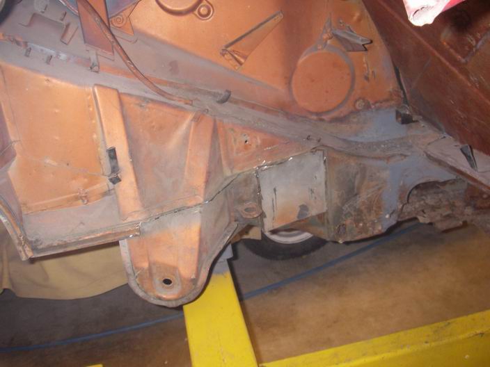

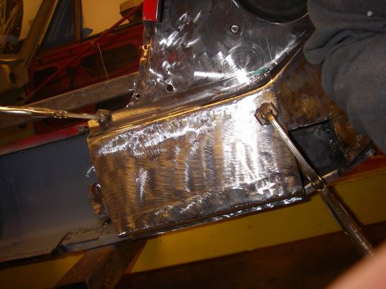

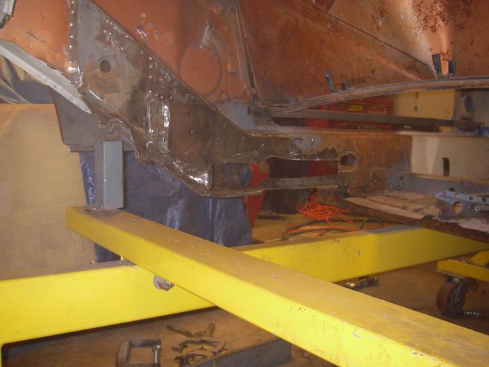

I forgot to post these before I went out of town. Boredom today and itching to burn some metal when I get back. I hate leaving in the middle.

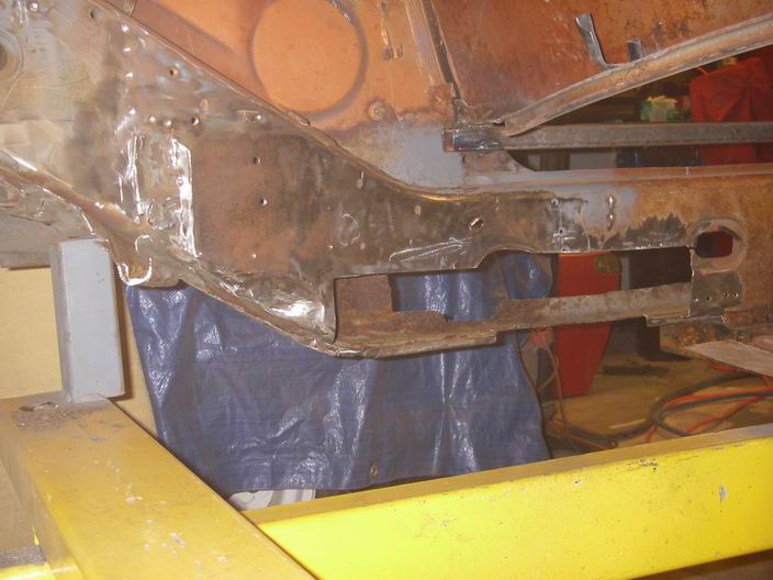

Left inner long: Typical rust at the bottom of the rail from the motor mount forward.
Exploratory cutting until I hit good steel. Fabricate the lower portion of the long, flange it and burn it in. It was easier to shape the rear upward angle after the front lower portion was tacked in. 16 guage tends to want to hold its memory.
Still not done here but had to leave in the middle. Lots of finish work and weld grinding to do. Need to add a piece at the rear of the motor mount recess area but will hold off until I see what Foleys raised pickup kit extends to.

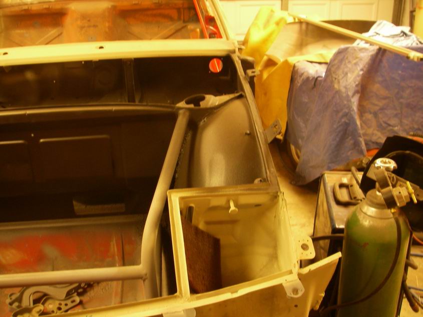

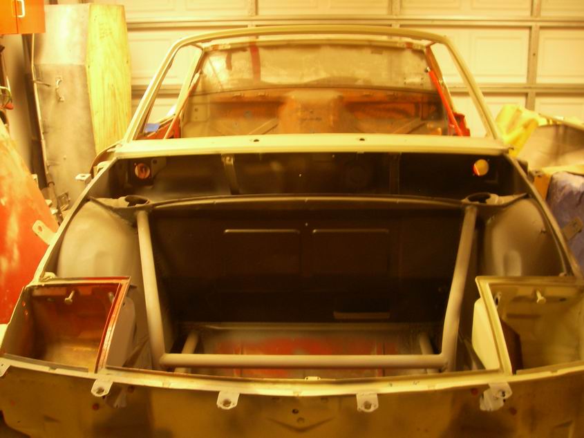

Front body is 98% done. Front bumper and fenders just need to be hung. Dzus fastener mounts are all located. Just need to complete the finish work on the left fender and basicly done.
I havent come to a conclusion on headlamps yet but I hate the pop up lids - so they must go. Considering the CA laws on lamps some ideas have come to mind. Just like a formula in racing its all really open to interpretation and the risk.

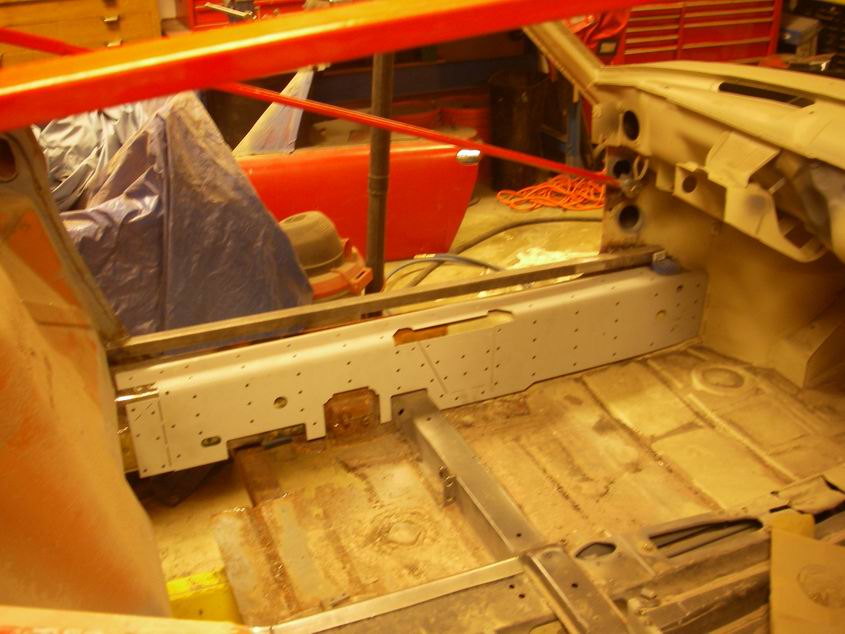

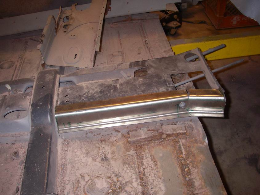

Working on the left inner long. Its done. Just need to replace the outer long and good to go. Threw the Engman stiffener on there for looks.
I am getting ready for the rear floor section and lower firewall installation. I'm excited.

Completed the tunnel repair patch for both sides. This will be plug welded once I install the floor. Fitment prior to floor cut and trim.
An afterthought! Porsche/VW should have made the tunnel the same height as the longs. Would have made a much stiffer platform. Shorten the shifter a bit and well.. it didnt happen.

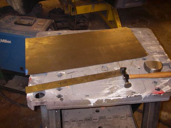

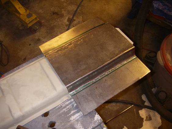

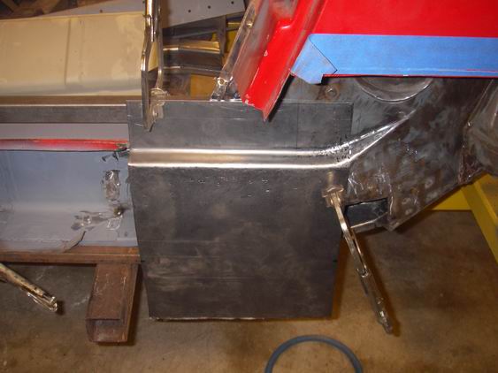

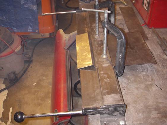

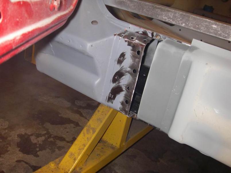

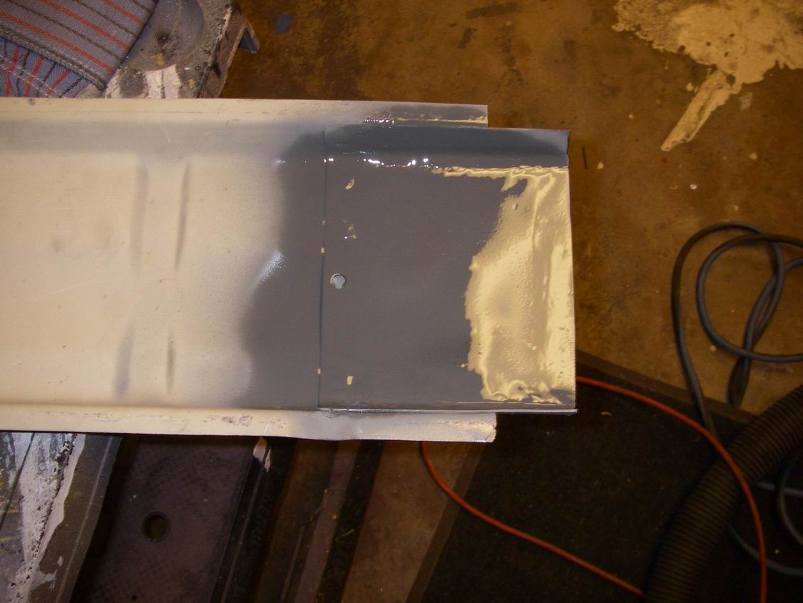

Fabricate the closing plate at the rear of the left outer long (rocker to us body guys)
Start with a big flat piece of 16 gauge steel. A little bending in the brake. Some trimming and there you go.

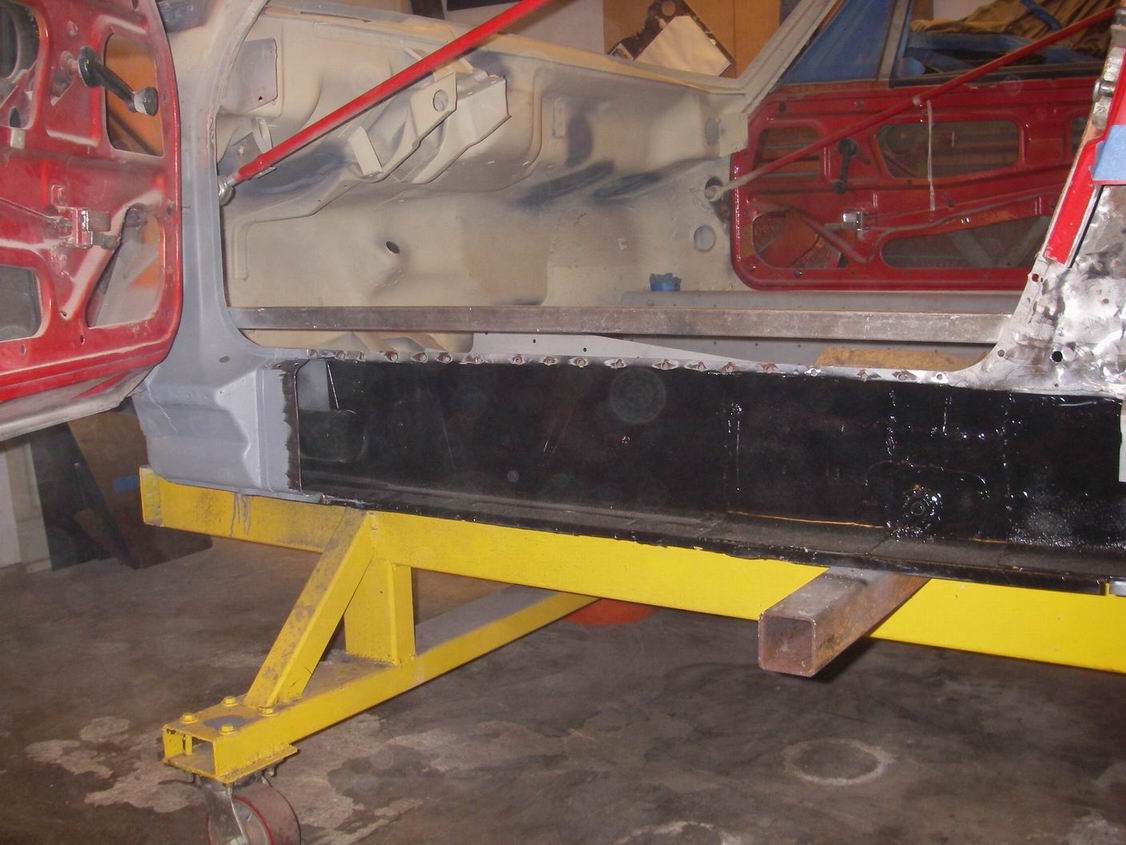

The Red Head has me really stirred up! And she probably still has the link I sent her 8 months ago. I do care about her.

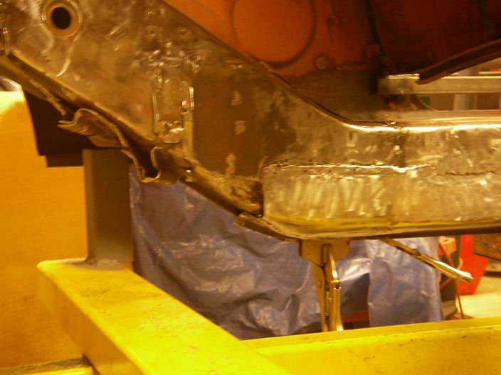

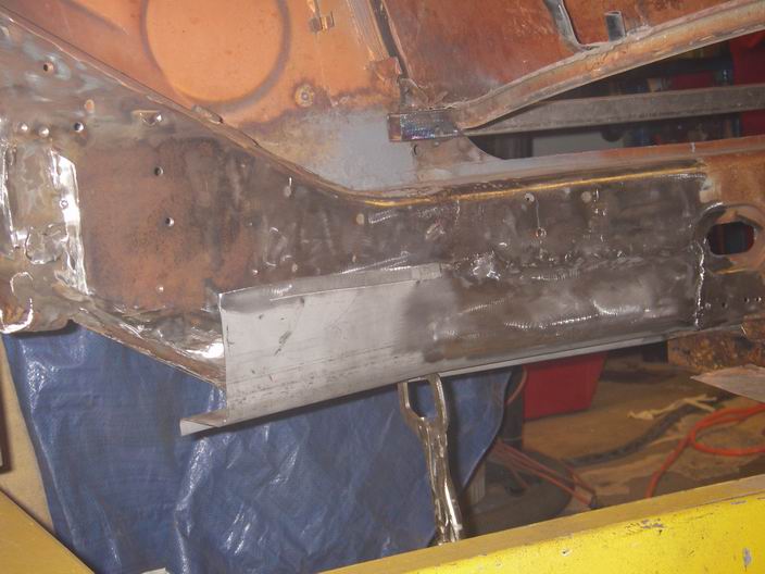

Left inner long has been repaired. Last will see of it. Should have signed my initials on the inside before I closed it up.

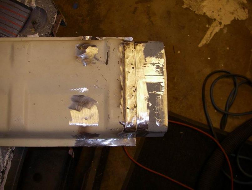

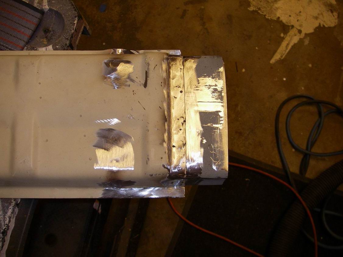

Next: Prepare the new outer long. Fit and add a sleeve for the infamous Hail butt weld. Sleeves make the joint twice as strong and provide a solid joint to burn in without blowing holes. A tight fitting backer is the key to a good structural joint. Really not a butt weld but a modified butt/ lap... kind of.
Jeff Hail
post Feb 21 2010, 10:48 PM
Post #450
Posts: 1,141
Joined: 3-May 07
From: LA/ CA
Member No.: 7,712

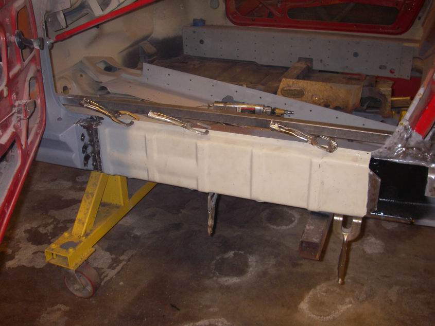

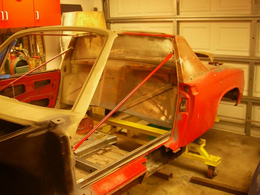

Test fit of the Left Outer Long. Check for level and top and bottom flanges.
Clamp in place.
Punch the requisite holes and grind the flanges as appropriate.

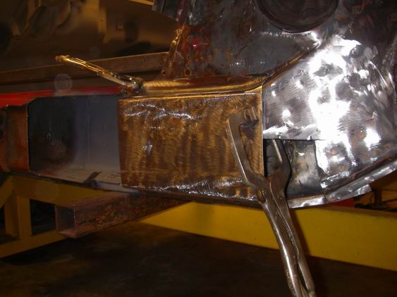

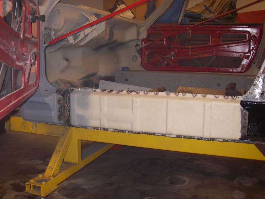

Lets burn some metal. Alchemy!!
Grinding the plugs is next. BTW.. the upper flange was welded on the inside as I pre-drilled the holes on the inner long. Makes for a better cleaner finished product on the outside.

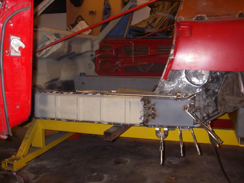

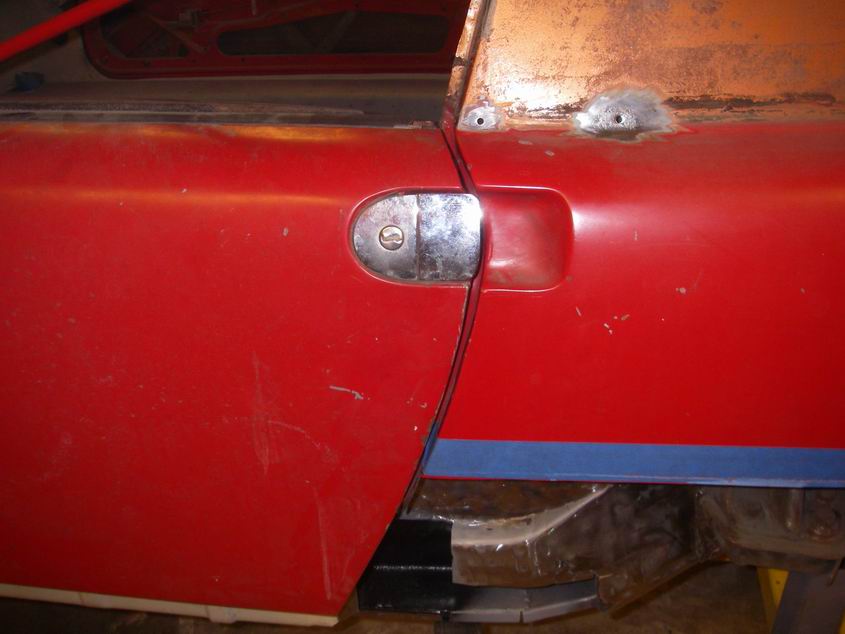

I removed the brace just above the inner long before I welded the outer together.
The door gap stayed perfect.
Lot of talk lately on the site about twisted chassis when welding in roll cages and long reinforcements.
The only conclusion is "Occums Razor".. aka welding to fast. I burned the outer long in about 45 minutes while piping in air flow with an air nozzle laying inside the long. Just a bleed of air flow to cool the metal as I plugged along.
I would say I generated the same amount of heat welding the outer long as installing an Engman reinforcement. Weld slowly! Take your time.

Did ya notice the hinges? Weight Watchers for Fat Girls style.
Jeff, What method did you use to get the support bar out of the hinge?
(nevermind...upon further inspection, it looks to still be in place.)

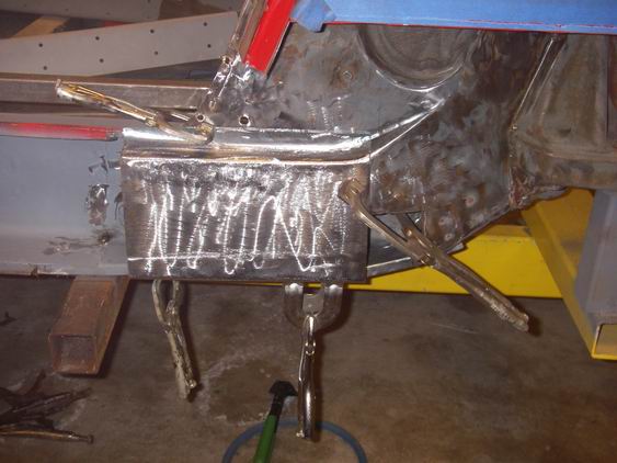

A few mnutes to play...

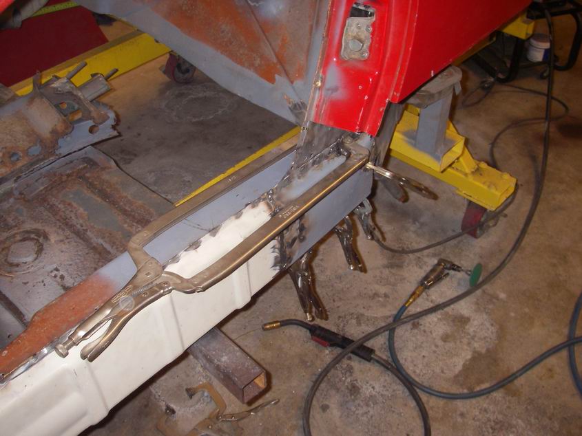

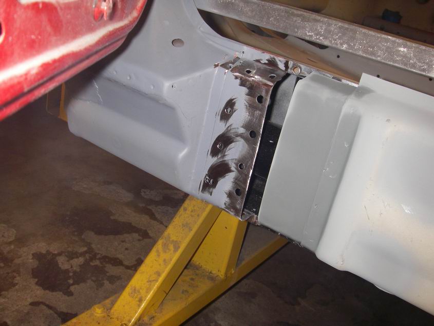

Final fitting of the rear outer rocker closing plate. Burn it in! I will grind all the welds down tomorrow.

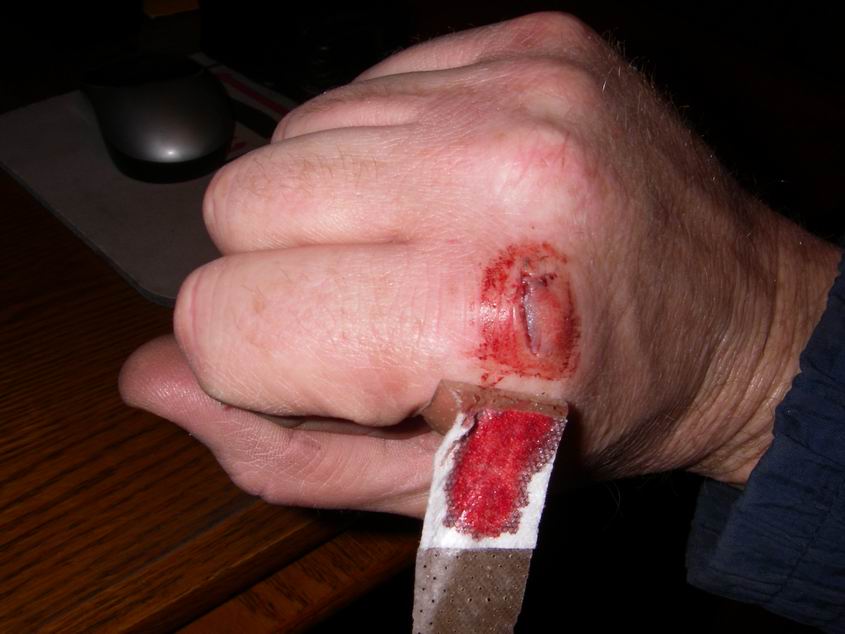

Ok shit that hurts. Anyone who works with sheetmetal is gonna get a "hurts donut" inevitably. Got this one when the vise grip slipped and banged my knuckle on the edge where the qtr panel is cut off for access. Yep it went to the bone and was a bleeder. Probably should have gotten 3-4 stitches. No time but cyanoacrylate closed it right up.

Nice work Jeff! (IMG:style_emoticons/default/thumb3d.gif) REAlly nice gash! (IMG:style_emoticons/default/chowtime.gif) (IMG:style_emoticons/default/biggrin.gif)

A little lemon and salt on there and I bet the vodka would go down really fast! Nice thread Jeff, lots of great info for peeps of all levels here. Thanks for all the extra time spent on pics and documentation. It takes enough time just getting the work done.
