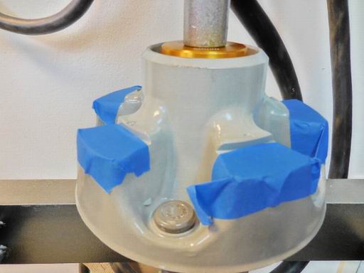

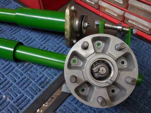

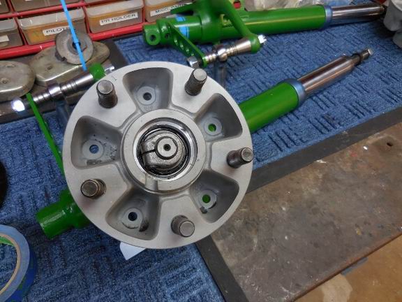

Ready to go. Races installed. Bearings packed. Installed on the strut assembly. I also replaced the often neglected hidden O-ring behind the bearing spacer.
I glass beaded the hubs to clean them up. I also sprayed a light coat of 600 degree engine clearcoat to keep them from oxidizing. Baked at 200 and 400 with 30 minute cool down cycles in between.
I thought these were clear anodized originally. I was wrong.. some sort of clear crud was applied from the factory. It came off to easy for it to be anodizing.

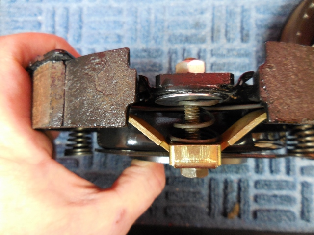

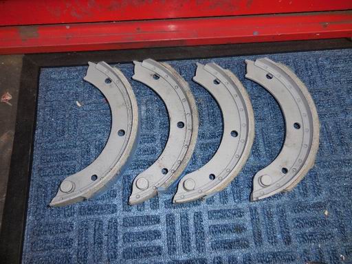

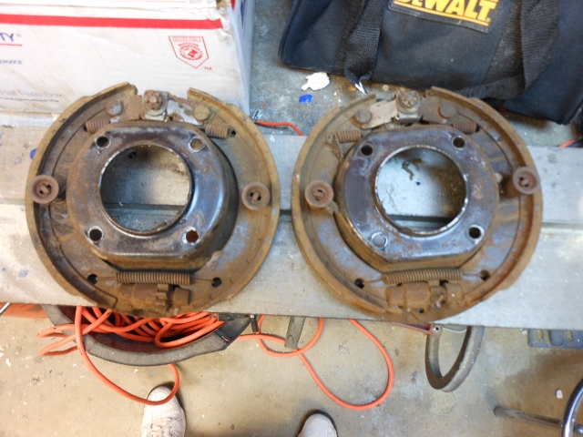

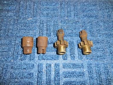

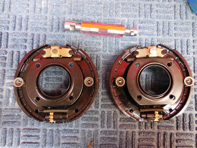

The art of restoration.

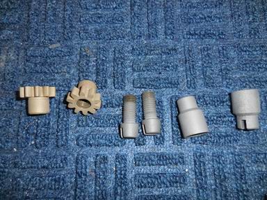

The only parts that are new are the spreaders and spring retainer cones. Everything else including the shoes were glass beaded and finished. The brass star adjusters were glass beaded and then polished.
From rusty to perfect.
Jeff Hail
post Nov 30 2014, 01:32 PM
Post #644
Posts: 1,141
Joined: 3-May 07
From: LA/ CA
Member No.: 7,712
I deviated from one thing on Foleys 911 e-brake mod. I cut the return spring in half behind the spreader (since only one spreader is used) and placed a washer where the cable passes through to provide a little extra push on the shoe retract.

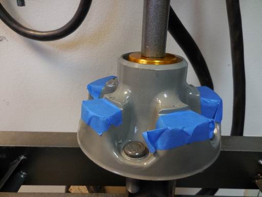

Pre-fit the motor mount and burn it in.

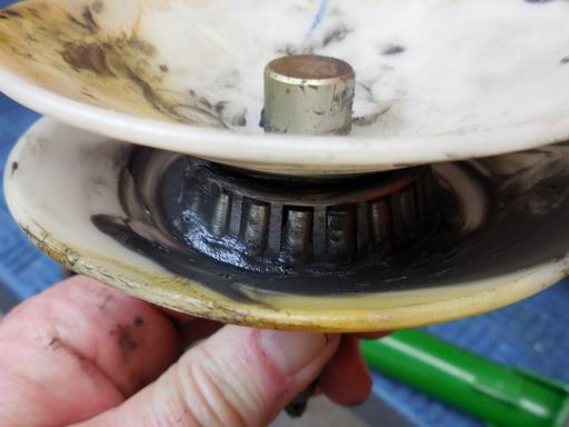

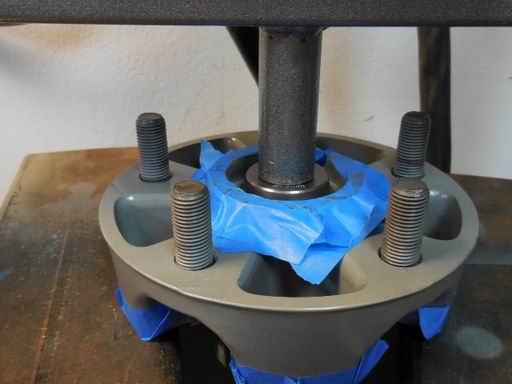

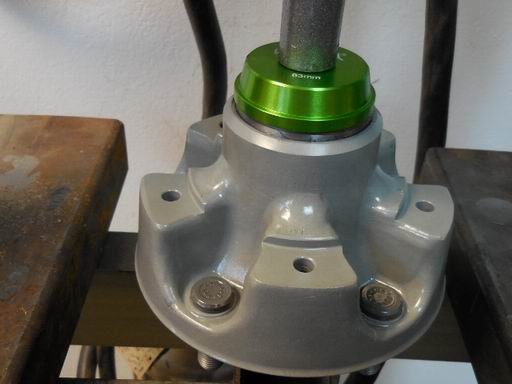

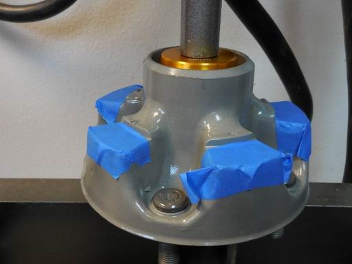

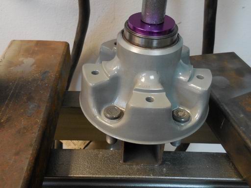

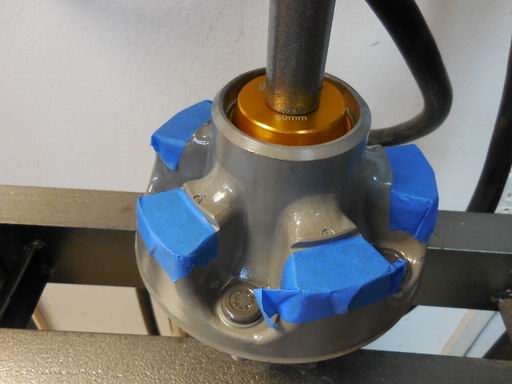

Completion of strut #2
Installing inner bearing race
Attached Image Attached Image Attached Image Attached Image Attached Image Attached Image
Jeff Hail
post Dec 24 2014, 01:16 AM
Post #650
Posts: 1,141
Joined: 3-May 07
From: LA/ CA
Member No.: 7,712

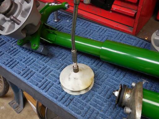

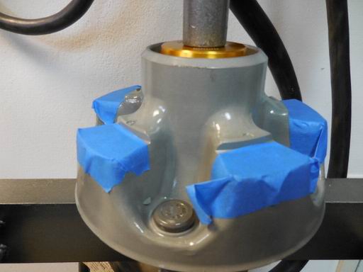

Installing outer race and pressure packing bearings.
Jeff Hail
post Dec 24 2014, 01:19 AM
Post #651
Posts: 1,141
Joined: 3-May 07
From: LA/ CA
Member No.: 7,712
Installing the seal then hub on the spindle.

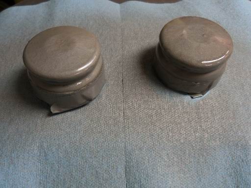

Grease caps glass beaded and epoxy coated.

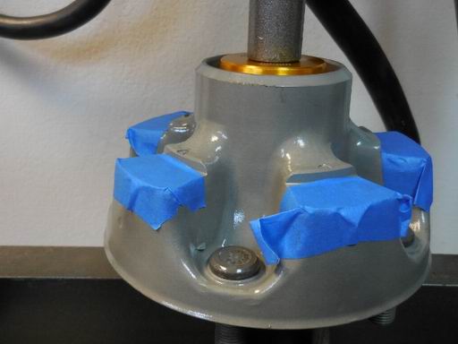

Poly Graphite bushings installed on the upper mounts.

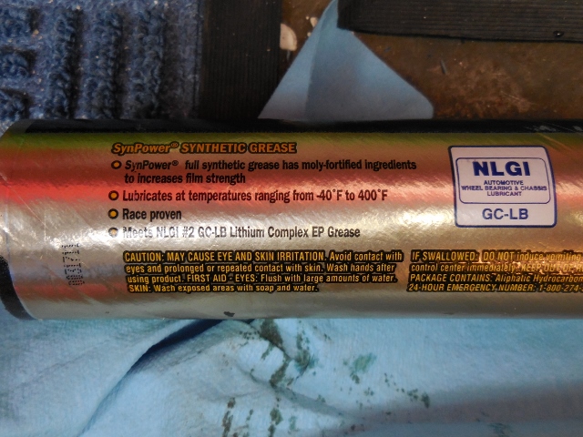

what are you using for wheel bearing grease? It looks like swepco cv grease.

QUOTE(mrbubblehead @ Dec 24 2014, 08:58 PM) *
Jeff,
Short answer -
I've used Mobil 1, Valvoline 985 or 986 and Swepco 101. Will always use Moly based. I've never had a wheel bearing failure ever. Between those 4 I cannot tell the difference which is better. I like the Valvoline because it will flow but not sling.
I won't use blue based name brands from what I learned from motorcycle racing.
NEO, Redline and Krytox are great stuff but at 3x the price I have not seen bearings last any longer.
Swepco claims 500 degrees on the high end. If tapered roller bearings are seeing temps approaching 200 degrees a different problem is present that has nothing to do with grease unless its dry. That's too hot and usually way to tight.
I always pressure pack the bearings and fill the hub cavity 25% with grease. Any more and you can get grease purge. The inner seal is a good design from Porsche and the o-ring behind the bearing spacer stops everything else.
Lots of opinions on w/b grease. Choose your poison.
First key is properly seating the races, good lubrication and next setting the bearing load.
Merry Christmas

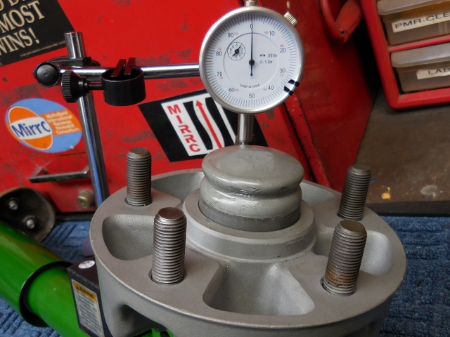

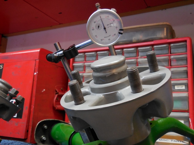

Post assembly fact checking aka anal retentive quality control.
Checking runout after assembly. Spot on right and left. I lost sleep last night. Woke up and thought I gotta double check these after I put them together.

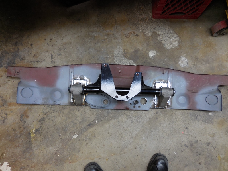

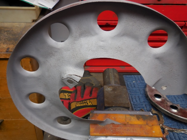

Way back Machine

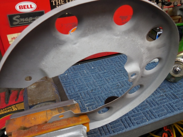

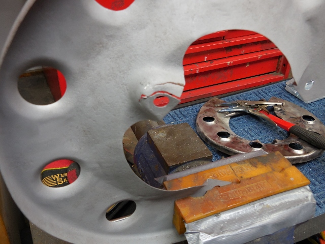

Have to weld up those trick rear backing plates. For some reason on 914's they are prone to fatigue cracks. This stuff is really thin. I measured it at 25 gauge at the thinnest area. My Miller 180 was turned down to under 1. About as low as it would go.
I'm not even going to use these on my car with the 911 rear parking brake mod.
Maybe someone here will end up with them? You never know? I might throw them in with the lot of parts going to the powder coater and then offer them up.
