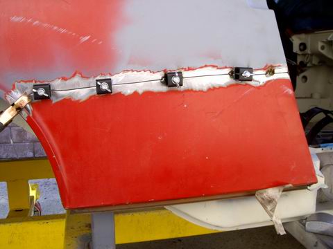

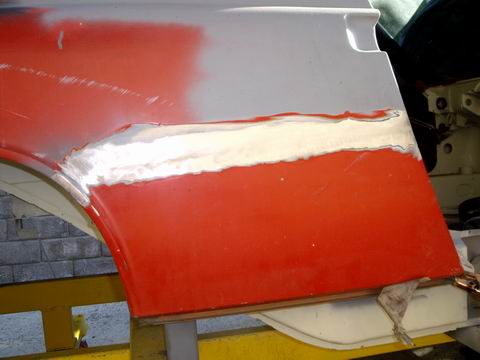

QUOTE(Jeff Hail @ Mar 23 2008, 09:07 PM) *
When butt-welding along with good weld penetration the key is the grinding and finishing process.
I begin with a spot weld grinding disc to take the crown of the weld down to just above panel height. Move slow and let the panel cool. A grinder will warp thin sheetmetal just like overheating while welding.
Then I use a 3 inch 36 grit disc on a angle die grinder to take the crown down a little more.
Then I switch to a 6 inch flat flap disc and follow the crown back and forth eliminating any high spots.
Question - How do you finish the seam on the inside of the quarter panel? I would imagine that getting in there to grind it smooth would be difficult. Do most people just knock it down a little bit, and leave it rough since it’s on the inside of the fender?
Jeff Hail
post May 7 2020, 09:35 PM
Post #714
Posts: 1,141
Joined: 3-May 07
From: LA/ CA
Member No.: 7,712
QUOTE(stevegm @ May 7 2020, 04:53 PM) *
Angled die grinder with a 2 or 3 inch disc. A 3 inch flap (water wheel type) will take the back side down. Just need to hit the high spots. The butt weld done right does not leave much of a proud weld on the back.
