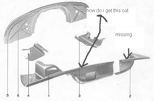

yellow1 I stuck my hand where the alternator is and found ... Oct 6 2007, 07:13 PM
eg914 If I remember from my last go at this, part 1 stay... Oct 7 2007, 12:32 AM
wertygrog well if it's a matter of the belt slipping off... Oct 7 2007, 01:01 AM
Bass Fisher Dave is right on the starter, but you can also use... Oct 7 2007, 10:37 AM![]() ![]() |
