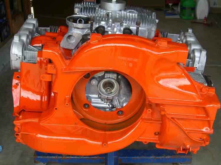

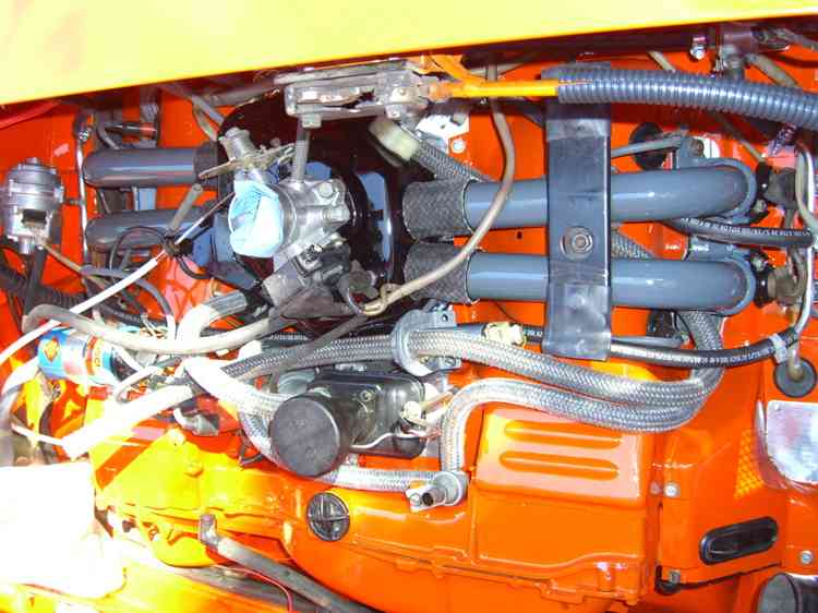

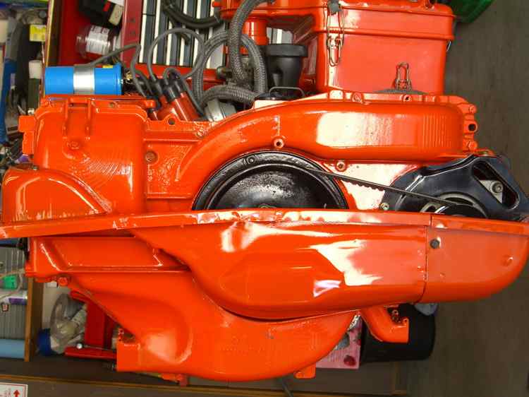

Dan (Almaden Valley)   I built a 2056 using 96mm KB aluminum pistons, and...   Oct 8 2007, 10:32 AM

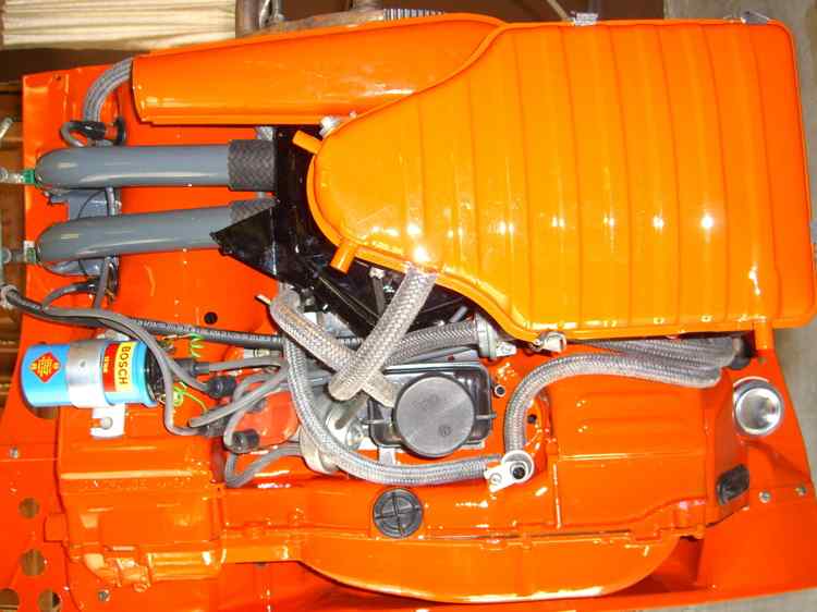

Dan (Almaden Valley)   and here is what it looked like before going back ...   Oct 8 2007, 10:35 AM

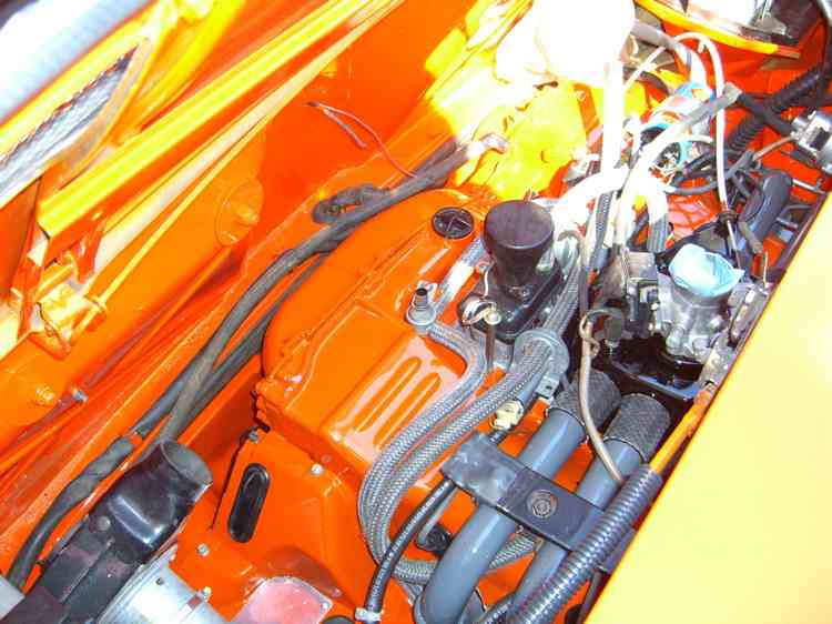

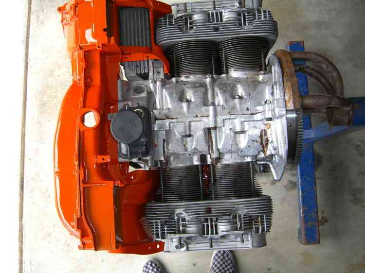

Dan (Almaden Valley)   and finally in the car   Oct 8 2007, 10:36 AM
grantsfo   I can attest to the fact Dan's car is very fas...   Oct 8 2007, 12:50 PM
Dan (Almaden Valley)   I can attest to the fact Dan's car is very fa...   Oct 8 2007, 01:03 PM
grantsfo   I can attest to the fact Dan's car is very f...   Oct 8 2007, 01:23 PM

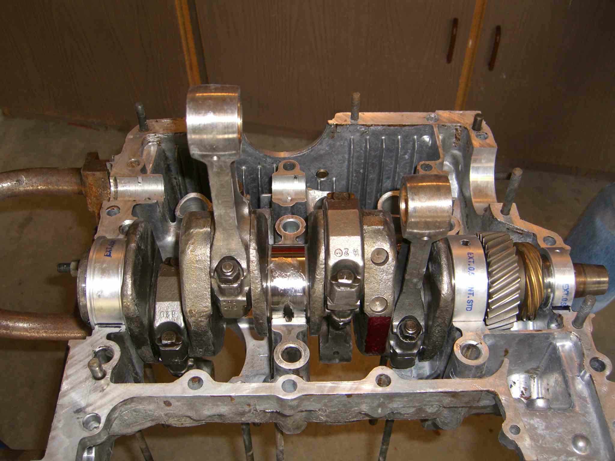

Inspector   For educational purposes is there any photos of th...   Oct 9 2007, 08:39 AM
Jake Raby   Nothing is the same between the two engines, they...   Oct 9 2007, 08:54 AM
cnavarro   For educational purposes, if you want to see pics ...   Oct 10 2007, 03:48 PM
