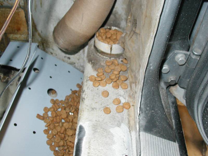

5. No heat; Ran fingers over the heat exchanges and discovered they were non existant. What to do? Scrounged through my junk pile found good heat exchangers that have literally lay out side in the Oregon rain for 10 winters that were in good shape. Put these on with the 5000 or so odd nuts and bolts without breaking an exhaust stud and took it for a test drive. Around 4000 rpm a typoon of dehydrated mouse turds, lint, assorted crap started blowing out the defroster vents covering me head to toe in this vile mess. The good news is I have heat.

Had a similar problem with a 79 MG I was working on, couldn't figure out why heat only came out of the driver side. Went over and opened up the vent on the passenger side and took off the flap and a whole bunch of mouse turds fell out.
Further inspection revealed a well established nest further up in the air hose that had to be cleaned out. Didn't get covered with the turds as you unfortunately did.
