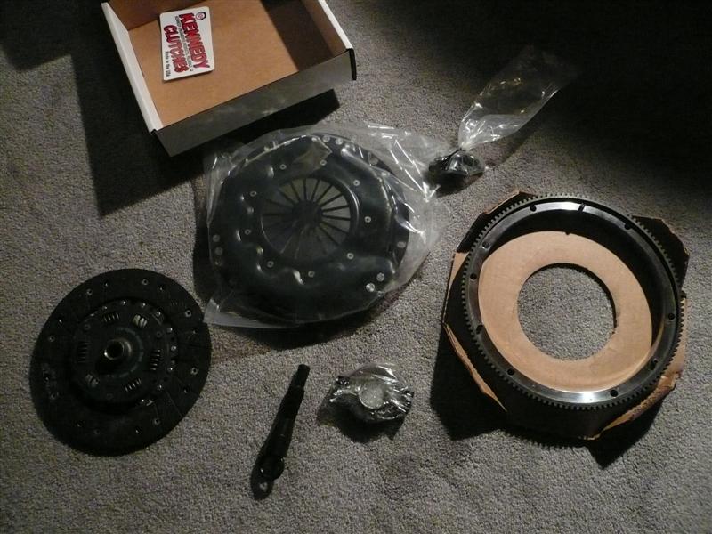

Just got my clutch kit.
KEP stage II pressure plate
ring gear adapter
clutch disc
throw out bearing
Need to do the oil cooler mods.
Anything else??
Oh, i probably should get a new pilot bearing.
Should I re- surface the flywheel even if there is no scoring?
