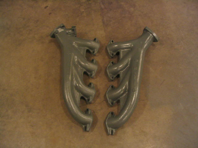

Incase anyone is still up. This is what I've been up to this weekend. Blasted and painted the exhaust manifolds.

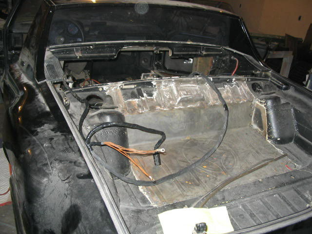

Most of the weekend was spent lengthing the wiring harness. I need the rubber boot on the fire wall to face to the right side of the car and run up the right side, across the top of the firewall and then to the relay board. I sectioned a harness from a parts car I had. (I don't throw away anything) Every wire was soldered with induvidual shrinkwraped then I covered the new harness with some big shrink wrap. I need to pick up some brackets to hold the new harness but it's ready to install.

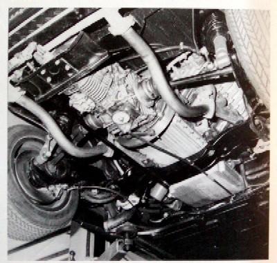

Ok, This is supposed to be a 914 with a 928 motor and a 928 transaxle... (IMG:style_emoticons/default/confused24.gif) You tell me...

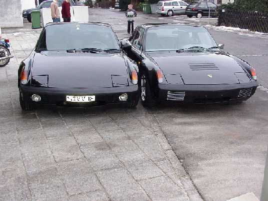

For our new German friends I call this double vision. One of these cars is a 4 cam one is an "S"
Just a little fun. Now back to work.
