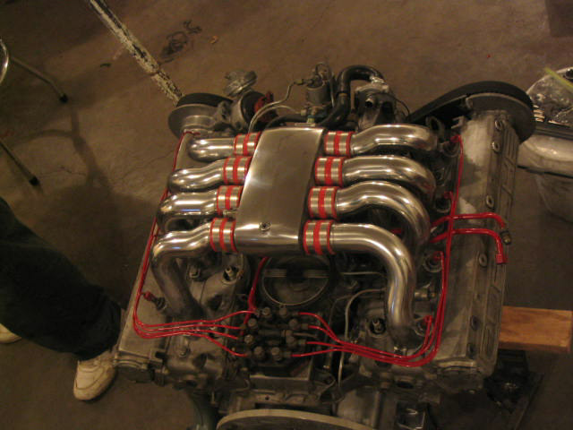

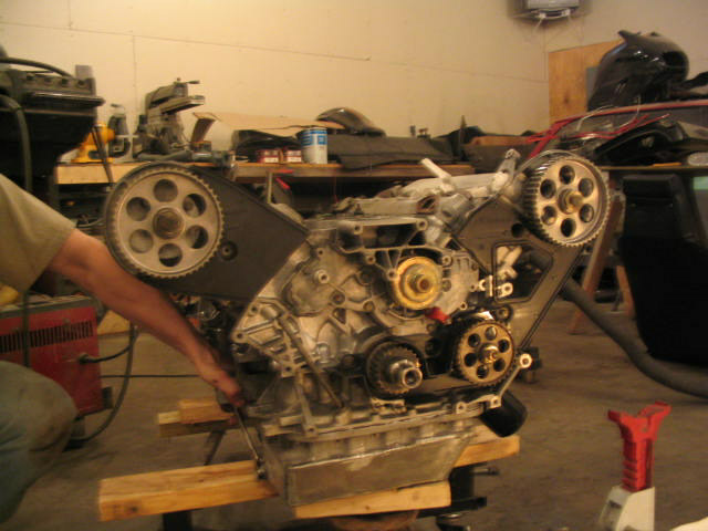

Modified oil pan is finally installed. (IMG:style_emoticons/default/smilie_pokal.gif) New cam, crank, and external oil pump seals installed. (IMG:style_emoticons/default/aktion035.gif) Discovered a few problems. the tensioner is siezed! I have to locate a used one ASAP! Engine bar is out for final welding and finishing.

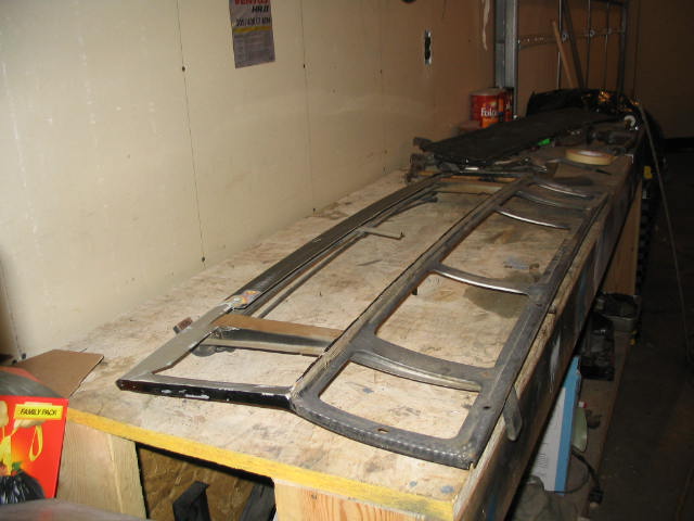

GT lid is almost finished... Mesh is fit. Lid needs paint before final mesh install. My GT style lid is not for cooling. It's to display the cool motor.

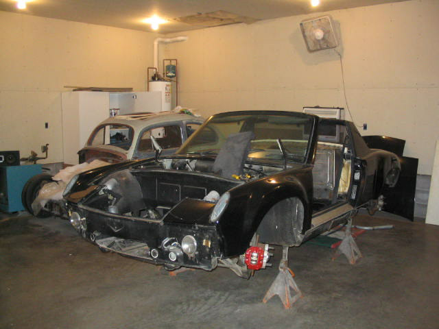

Body panels pulled off getting ready for the repaint.

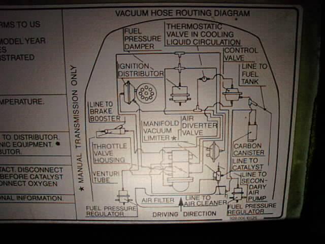

Top of the motor is on for good! I need a wire diagram and vacum hose diagram real bad! I took pictures but with everthing dirty... (IMG:style_emoticons/default/confused24.gif)

Someone with an early 928 can take a picture of the hose diagram from under the hood.

From an 81 928

Thanks, That's a great idea. That's the answer! (IMG:style_emoticons/default/smilie_pokal.gif) I'll post over on the 928 BBS. (Ya..right...) BTW guy's and gals. The 928 boards I've found have very little traffic. I have not been able to locate a real active board yet. Anyone with a 928 or 928 interest know of an active BBS?
Thanks for the later model diagram markd@mac.com. I think a few of the hoses are still the same. I'm getting closer.

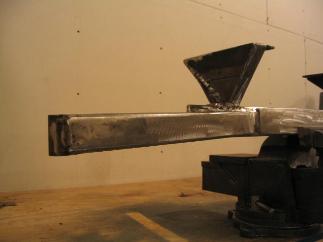

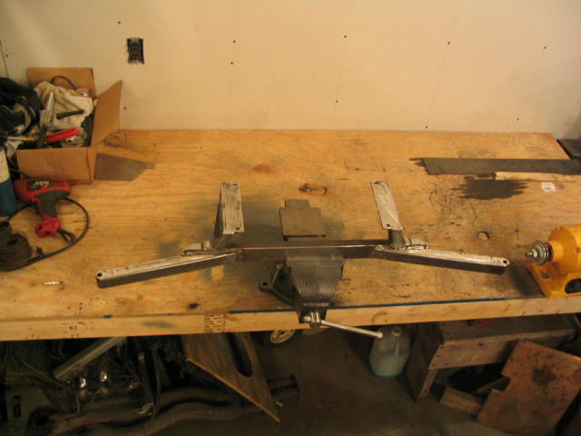

Custom cross bar welded, ground, and ready to sand blast in the morning. Then bondo on the welds and paint.

another shot....
