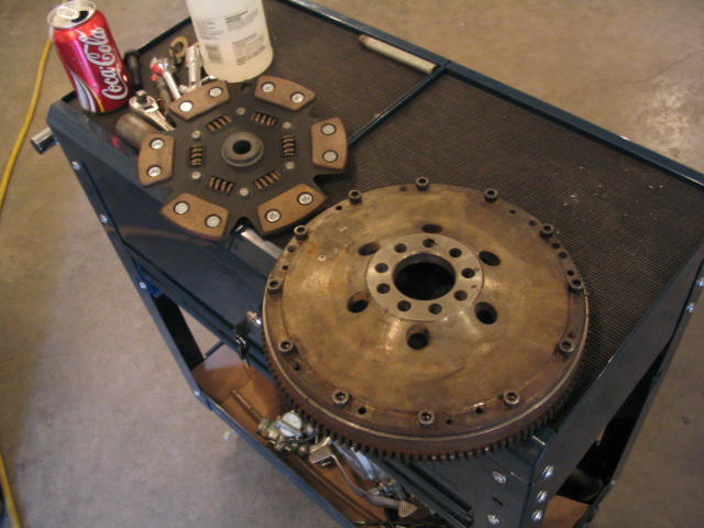

I picked up the custom flywheel from the engine balancers today. It took very little work to balance.
I went to install the custom disc and realized that the center hub on the 928 side hit the pilot bearing mount. It held the disc away from the flywheel about 3/8 of an inch. I figured I may as well try to fix it or I was going to have to eat the thing.
Well after about 30 minutes on the bench grinder I managed to fix the thing. Here's a photo of the repaired disc next to the stock 928 disc.
The best thing; After assmbling the clutch and installing the transaxle I pulled out the booster charger and cranked the thing over!
The motor and transaxle are no longer a test mule. They are connected with a clutch and the starter cranks it! COOOL! (IMG:style_emoticons/default/aktion035.gif)

Here is the clutch prior to grinding.

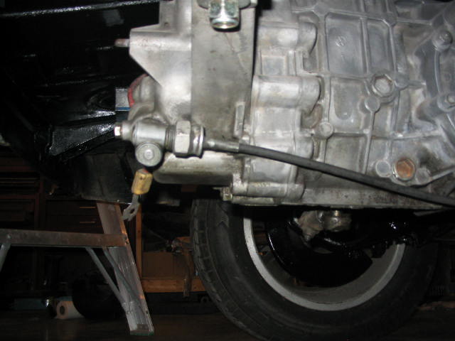

Speedo cable back in, New fuel lines in and routed. They are installed and routed together inside shrink tube.
New Clutch cable, throttle cable, go in tonight.

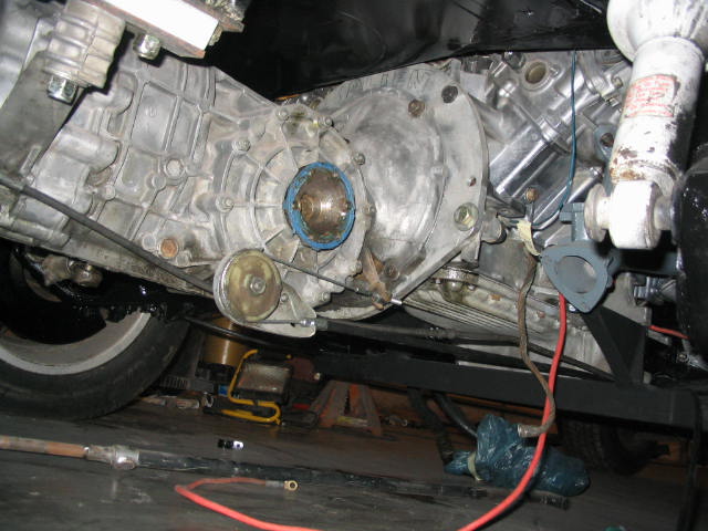

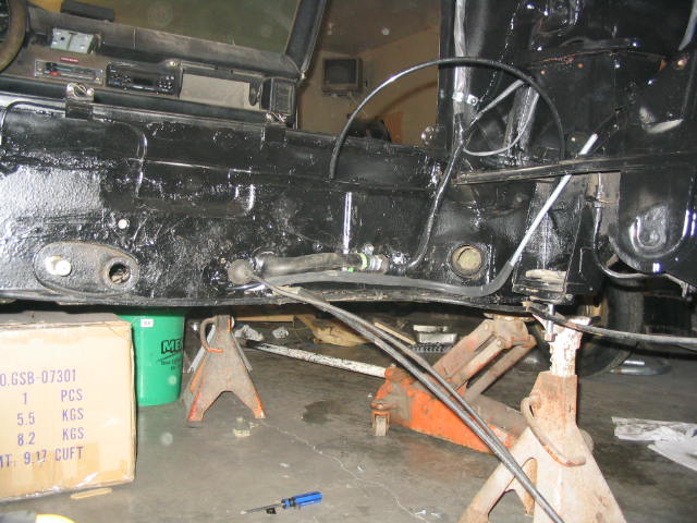

everything is back in the tunnel. Motor is now on the mounts. Everything clears at the bulkhead. Speedo cable length is fine. Clutch cable is connected.

speedo cable...

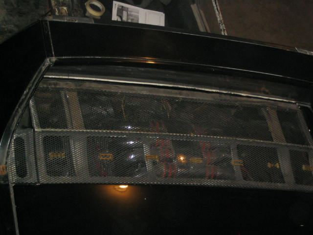

Full screen engine lid. Tomorrow is a big garage clean up day and I start connecting the engine electrical. The clock is ticking!

What kind of tranny mounts are those in your photo?

Custom made by me like the rest of this thing. The mount is made out of flat bar and high durometer plastic. (commercial cutting board material (IMG:style_emoticons/default/laugh.gif) ) It moves the assembly back 1.5"
