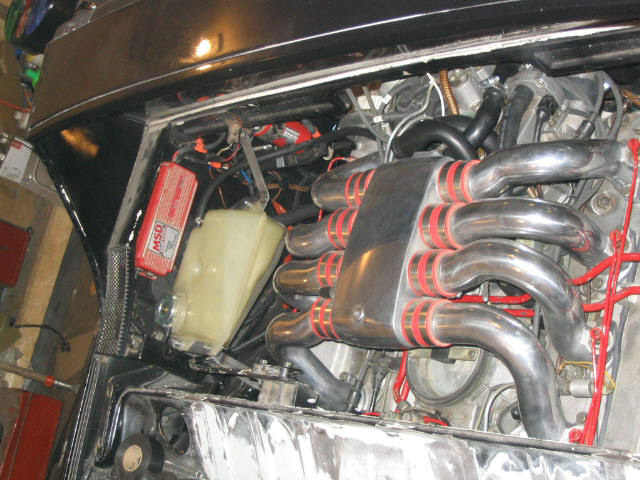

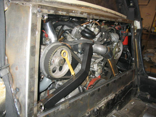

I'm close on the cooling system. Here's my surge tank.
rick 918-S
post May 17 2004, 08:29 AM
Post #203
Hey nice rack! -Celette
Posts: 21,324
From: Now in Superior WI
Member No.: 43

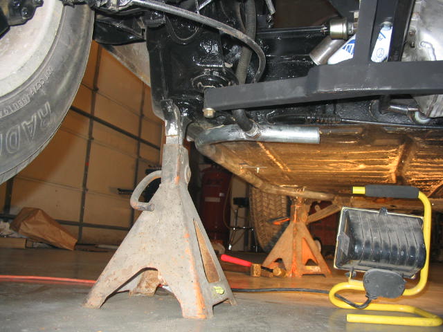

here's my lower surge tank connection.
rick 918-S
post May 17 2004, 08:32 AM
Post #204
Posts: 21,324
Member No.: 43

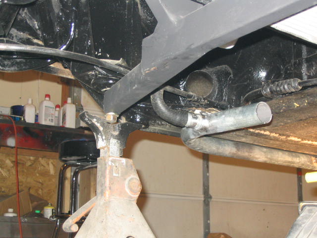

here's my left side water passage.
rick 918-S
post May 17 2004, 08:35 AM
Post #205
Posts: 21,324
Member No.: 43
Clearance is tight. I used 1" X 3" tubing on the return side to gain some clearance

(IMG:style_emoticons/default/ohmy.gif) I think nutted on the screen (IMG:style_emoticons/default/biggrin.gif)

Ya'll stand back there is a genious in the house. That has got to be the coolest solution to piping I have ever seen. You da man Rich. (IMG:style_emoticons/default/welder.gif)

The firewall attaches with dzus fasteners? (IMG:style_emoticons/default/ohmy.gif)

I filled the cooling system and ran the motor. Fans came on fine. I'm mildly concerned about a small purge from the coolant overflow that occurred just before the fans came on. But the temp gauges (Two, engine and radiator were close to equal at approx. 185 deg.
