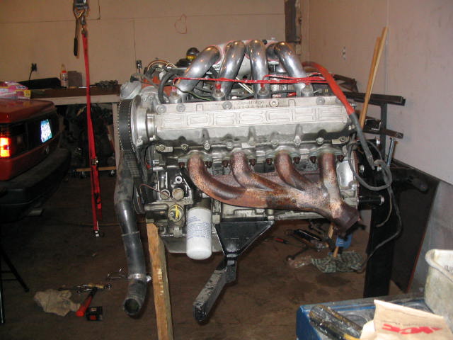

I had a long conversation with a guy in Texas that was developing a Supercharger for the 928. We got on the subject of headers because I thought I may have problems clearing the axles. He told me he dyno tested the best headers against the stock cast manifolds. The stock units made more power on the big end. Porsche usually knows what their doing. I trust them. I am going to re-design my exhaust this year though.
anyone need a used 928 conversion exhaust? (IMG:http://www.914world.com/bbs2/html/emoticons/wink.gif)
Those exhaust manifolds are not exactly the type that really need to be replaced by headers.
(IMG:http://www.914world.com/bbs2/uploads/post-2-1138084204.jpg)

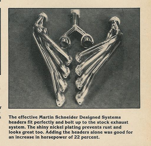

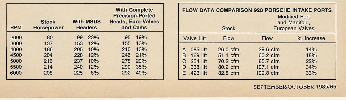

Rick, too bad we can't stuff a pair of these MSDS's in there (IMG:http://www.914world.com/bbs2/html/emoticons/biggrin.gif)
On our test car we could smoke the tires into 3rd. From "VW and Porsche", 1985.
Marty

...nuther out of the archives: When the engine builder Greg Brown, Anaheim CA. did some other tweaks--he really got this CIS 928 going strong !

In the crate -o-parts there was a set of the later foctory stainless tube exhaust manifolds for the SOHC engines. The local 928 guys told me that these are better than the cast ones for a slight power boost. And after all isnt that what life is all about (IMG:http://www.914world.com/bbs2/html/emoticons/cool_shades.gif) (IMG:http://www.914world.com/bbs2/html/emoticons/mueba.gif)

The later tubular units AFAIK are for the intro year model 1986 32V engine (2 bolt head) which may /may not fit the earlier engine (16V). The later 1987 928 32V engine (3 bolt head) will def. not fit onto the 16V heads. The guy didn't lie to you about a slight HP increase over the cast units...we only make +14% HP over the later Porsche manifolds as opposed to +22% over the cast. If you are hurting for space/ tight fit, my suggestion is to go "Extrudehone" and clean out a ton of breathing space out of the cast manifolds (IMG:http://www.914world.com/bbs2/html/emoticons/laugh.gif) Free HP
