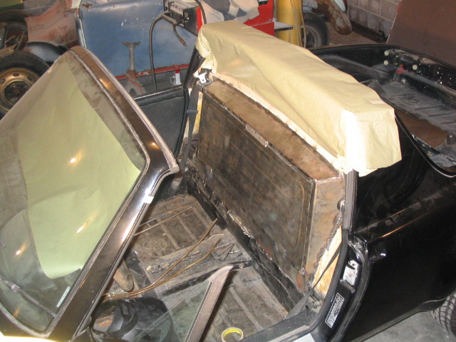

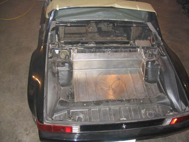

Back in the trenches. We made a coool rear trunk panel.

that car is gona be way to cool when it's done. What are you going to do about the firewall? Making a removiable access panel?

Thanks all. Glad your enjoying my madness. I though about making a removable access panel but there isnt anything tha can really be serviced from back there anyway. In hindsight I really didnt need to remove the stock floor and rear trunk bulk head once I figured out how to move the motor forward. So the new panel is really fixing a mistake. (live and learn for the next one (IMG:style_emoticons/default/confused24.gif) )
If I had a parts car I would just section back in a stock floor. the only mod would be a small dog house over the fuel distributor like the V8 chevy guy use with the HEI distributor.

QUOTE(73/2.0 9fourteen @ Jan 10 2004, 11:53 PM)
Eric
Yes in the passanger compartment. Were just about finished with that too. Film...er ahhh... Photos at 11:00 (IMG:style_emoticons/default/lol3.gif) I havent figured out how I'm going to check the oil yet. the dip stick is in the front. I need to quit procrastinating and bring my custom oil pan back to the TIG welder for one more mod. (IMG:style_emoticons/default/smash.gif)

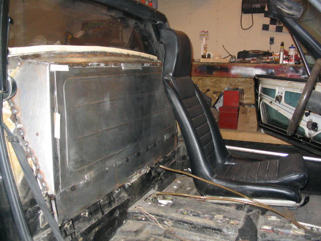

Progress

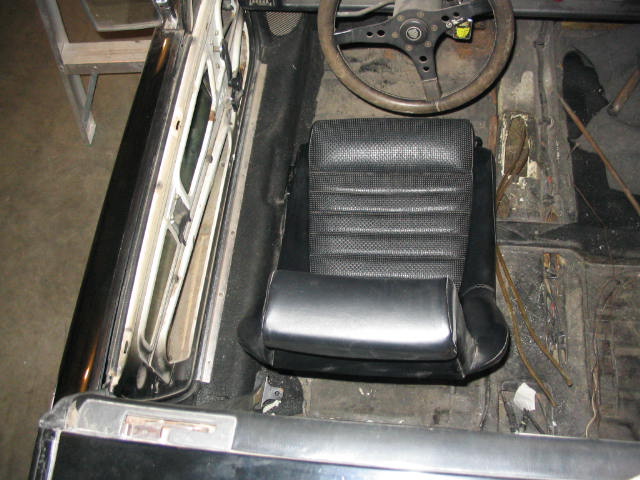

another angle.

one more.

Hi this may or may not help. There are flexable dipsticks/sleeves available. You can mount them anywhere within reason.

I'm 5'7" with a 32" inseam. I have about 4" behind the seat to the new firewall.
jonwatts
post Jan 14 2004, 01:00 AM
Post #60
no rules, just wrong
Posts: 2,321
Joined: 13-January 03
From: San Jose, CA
Member No.: 141
I'm sure you've said this before, but how much leg room are you losing because of the firewall re-engineering? Probably only a problem for drivers over 6 feet tall (and we all know aliens is shorty folk anyways).
