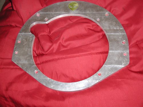

Did you also use this part? (IMG:style_emoticons/default/beerchug.gif)
