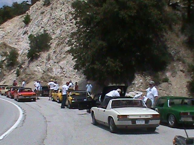

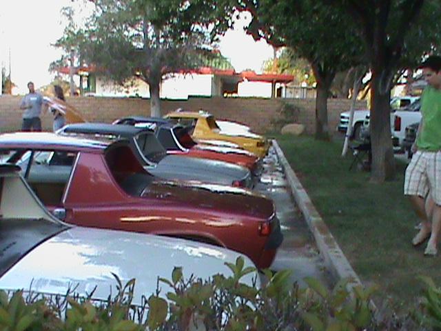

Some photos from Mnt Wilson and Lancaster.

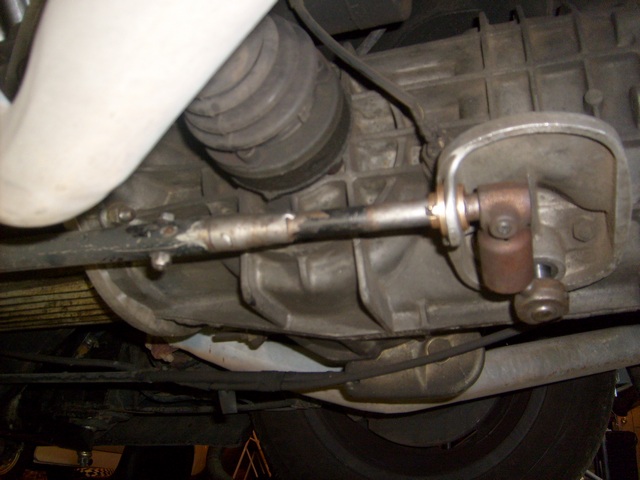

I have been fighting an issue with my shifter since last fall when we attended the RCR in Huntsville. It has gone out of adjustment twice. I was loosening the pinch clamp in the tunnel and realigning the rods. (I have tail shift lingage to a side shift tranaxle) Well, it went out of adjustment again the other day. I slid under the car to see if there was any other cause I was missing like a worn bushing or something. I was moving the rod checking for play when I noticed the rod was moving inside the dog foot on the side shift end. I tightened up the cone screw and BAM! The car never shifted so good! duh! (IMG:style_emoticons/default/screwy.gif)

In my quest to improve my shifting I have been wanting to replace my rear shift bushing. Here's a link to a two piece bronze bushing I made from parts I picked up at Menards.
http://www.914world.com/bbs2/index.php?showtopic=99331
Here's the end result.

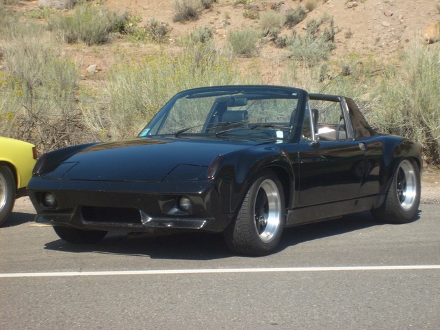

Here is a couple photos from our trip to the "RRC 09" We met some new friends and we excited to see some familiar faces as well.
Our hosts were were very attentive. The food was great! the camp ground was a fabulous idea, Monument National Park was awesome, and Gateway Museum was a site to see!
We were presented with the long distance award. All in all, I think with the driving we did while in Colorado we logged over 3000 more miles this year.
The gathering
Art shot
Monument
The topic of this thread (IMG:style_emoticons/default/assimilate.gif)

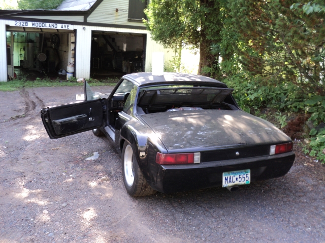

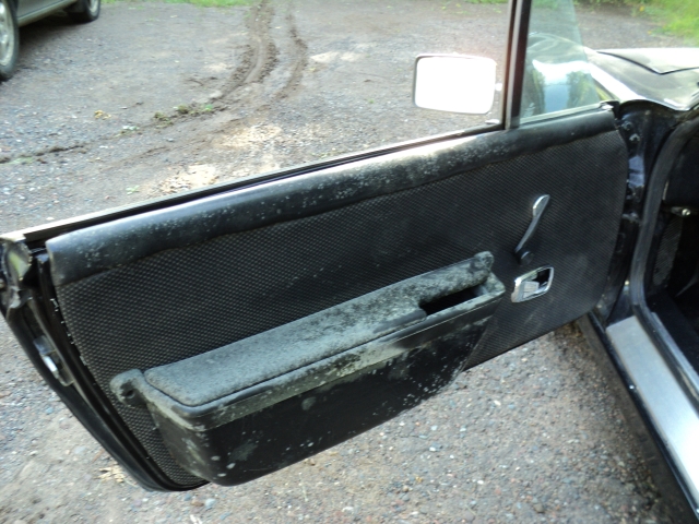

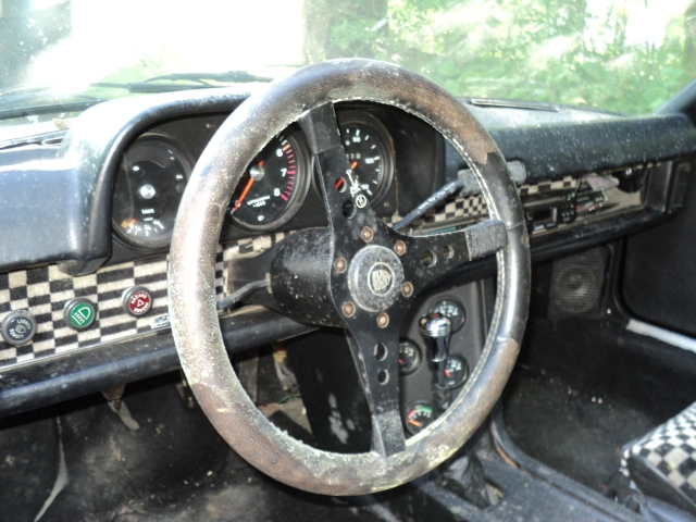

Well, I hurt the transaxle in the Alien last fall after returning from the RRC. I wasn't going to even pull the car out of storage this year. I have been busy trying to get the Ravenna car done. But I had some set backs so I decided to fix the transaxle in the Alien. Here's how the car looked when I pulled it out of storage. Damn good thing I didn't let this sit until next year! (IMG:style_emoticons/default/yikes.gif)
We had heavy rain here several time this year and water got under the door of the storage garage. With the hunidity the interior of the car turned into Mold!
rick 918-S

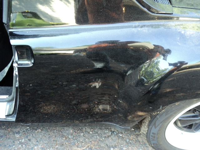

Then something was walking on it. I think a cat got into the garage!

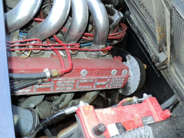

Engine is covered in corrosion!

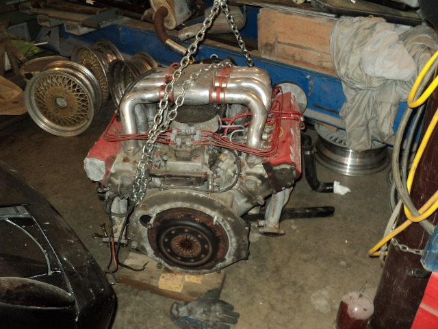

So, the engine is out, the rear tires are bald, the brakes are torn down, transaxle is apart, the car is dirty and the interior is covered in Mold!
