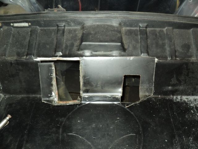

I needed to clean up a couple cutouts in my rear trunk. When I redesigned my throttle linkage I had to make some clearence. The cutouts were rather unsightly. So, here's the redesign.
Here's the before.

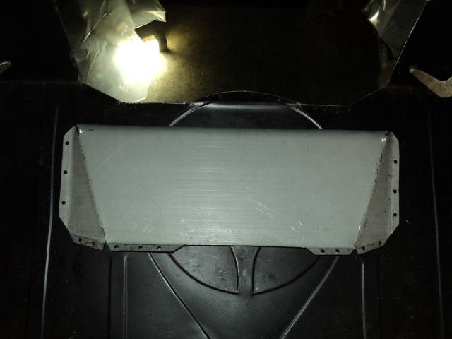

Here's the panel I made.

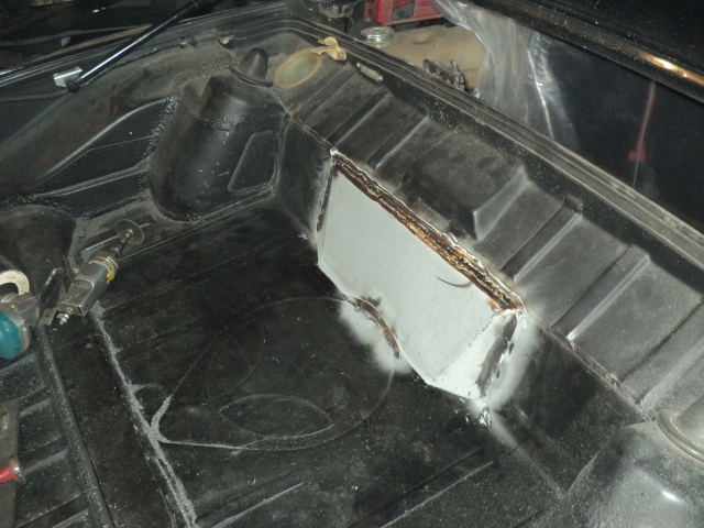

Here it is welded in.

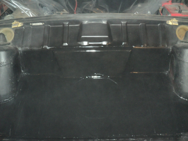

Done ready for the engine.
