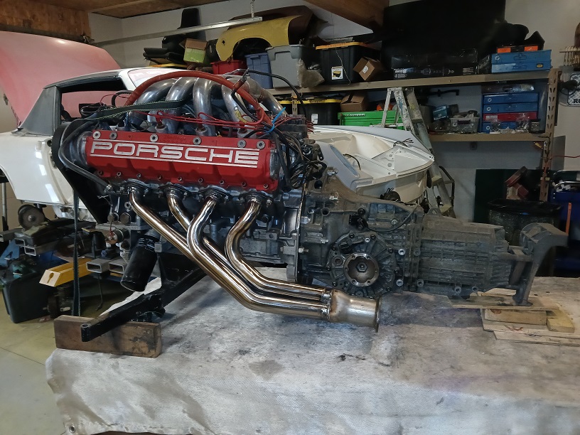

post Jan 20 2025, 06:20 AM
Post #783
Hey nice rack! -Celette
Posts: 21,324
From: Now in Superior WI
Member No.: 43
Even though it was minus 16 yesterday I managed to get some serious garage cleaning done. I wanted to move the Celette with the 6 out and move the Alien back in but there was no way I was opening the overhead doors.
I finished the left side header on Saturday night. As soon as it warms up to above zero I wanted to get the engine off the operating table and back under the car. By the way it's minus 17 today. (IMG:style_emoticons/default/dry.gif)

QUOTE(rick 918-S @ Jan 20 2025, 04:20 AM) *
Great header fab work Rick! love the custom wide radius bends you have created. Room for an X or H pipe ¿¿(IMG:style_emoticons/default/welder.gif)

QUOTE(Maltese Falcon @ Jan 20 2025, 09:53 AM) *
(IMG:style_emoticons/default/marty914.jpg)
I was thinking about that yesterday. When I did the last exhaust I added what I would call a balance pipe between the two mufflers. Maybe not ideal but it was something.

QUOTE(rick 918-S @ Jan 20 2025, 08:32 AM) *
Balance H pipe will fit in there easier than X...results will be beneficial none the less !

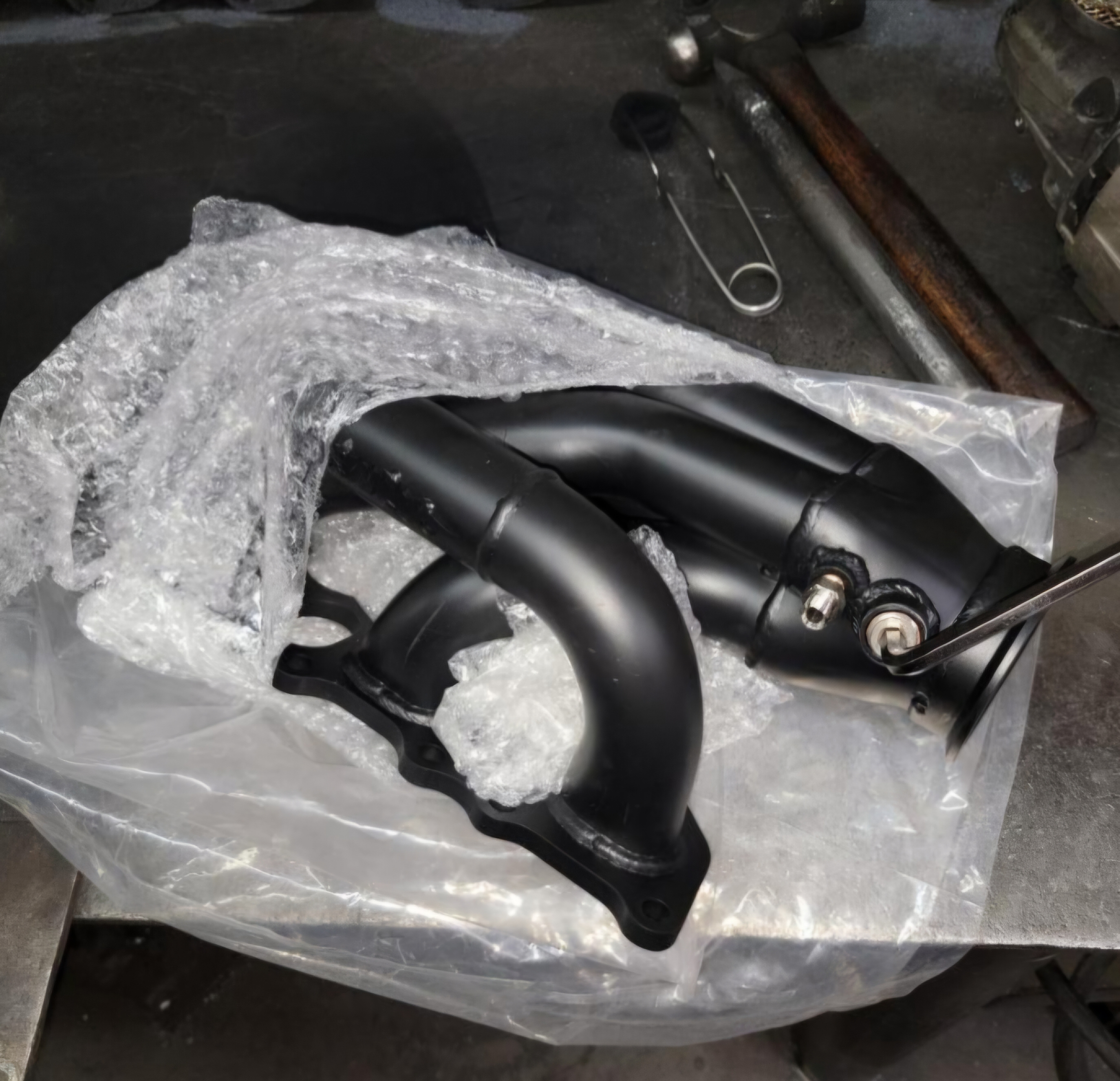

Long tube = best for Tq/Hp >>good on you for making these work ! I'm using these shorties on the v8 Cayenne forced induction engine, no problem on hp loss...just dial in another 2,3,4 psi on the Steamwheel !.
Tight fit in a 914 with lots of hardware, so hence the shorties.

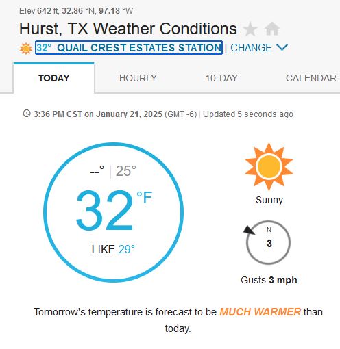

ClayPerrine
post Jan 21 2025, 03:44 PM
Post #799
Posts: 16,567
Joined: 11-September 03
From: Hurst, TX.
Member No.: 1,143
QUOTE(rick 918-S @ Jan 21 2025, 03:17 PM) *
Sandy sent me a text - 44 with the wind chill today
Ok.. I have to post this...
Tomorrow's high temp... 52 degrees.
(IMG:style_emoticons/default/poke.gif)
