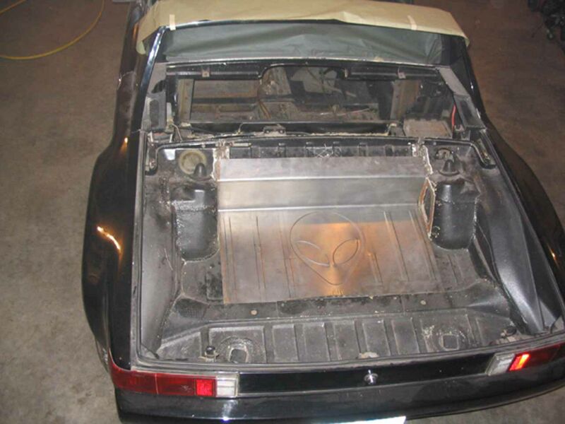

You dry state guys have no idea how good you have it. After another round of removing dirt soaked oil it's on to the prep work to repaint the bottom of the car. I think I first did this around 1995...
The Alien lives on.

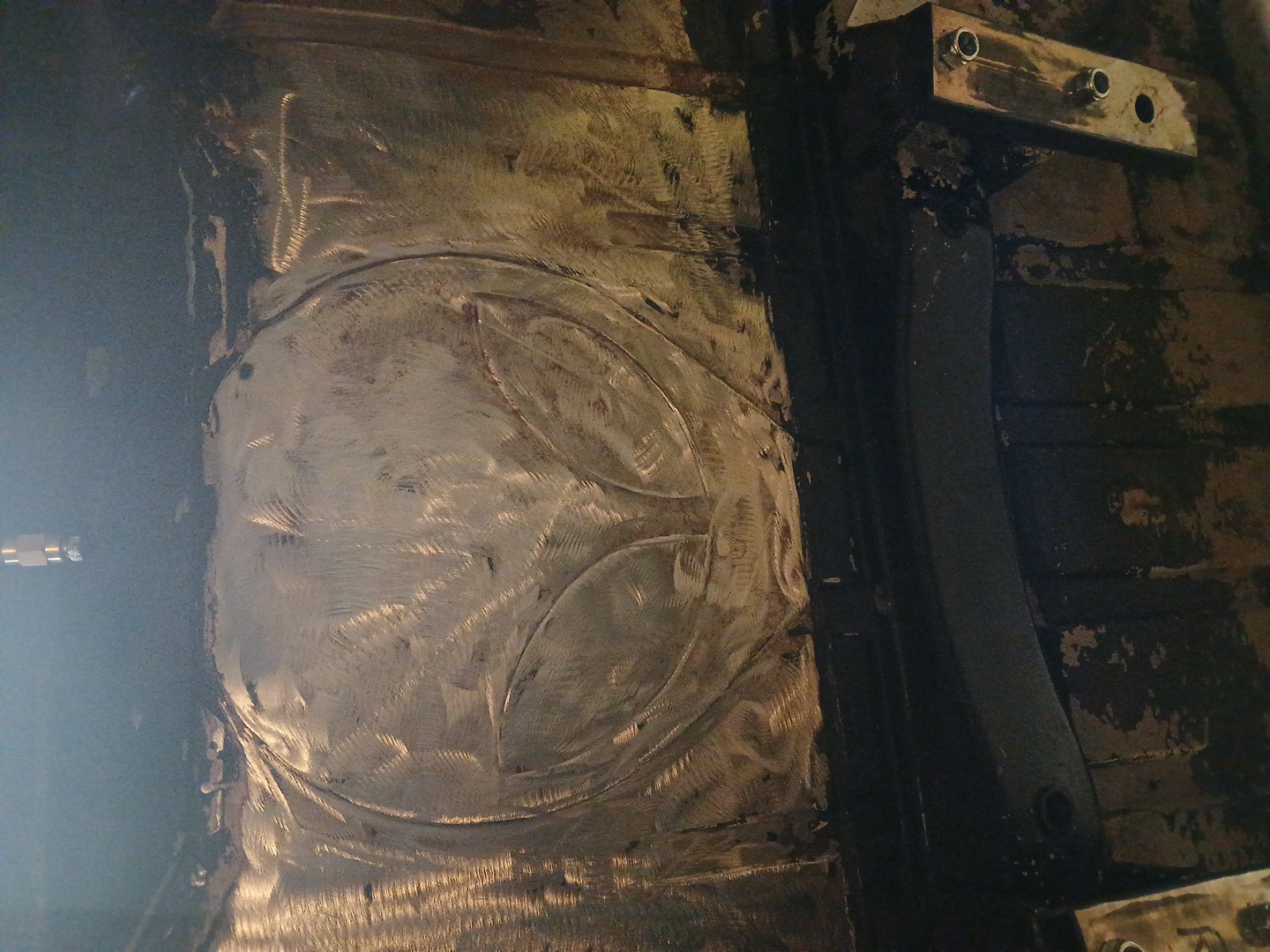

That's awesome Rick! Did you make that stamping by hand 30 years ago?
rick 918-S
post Jun 23 2025, 06:56 PM
Post #844
Hey nice rack! -Celette
Posts: 21,324
From: Now in Superior WI
Member No.: 43
QUOTE(jd74914 @ Jun 23 2025, 01:19 PM) *
I painted the car in the mid to late 90's. When I did the transformation to the 928/901 conversion me and the boys did this to the trunk floor around 2003. Did it with a bead roller. The other photo is from under the car.

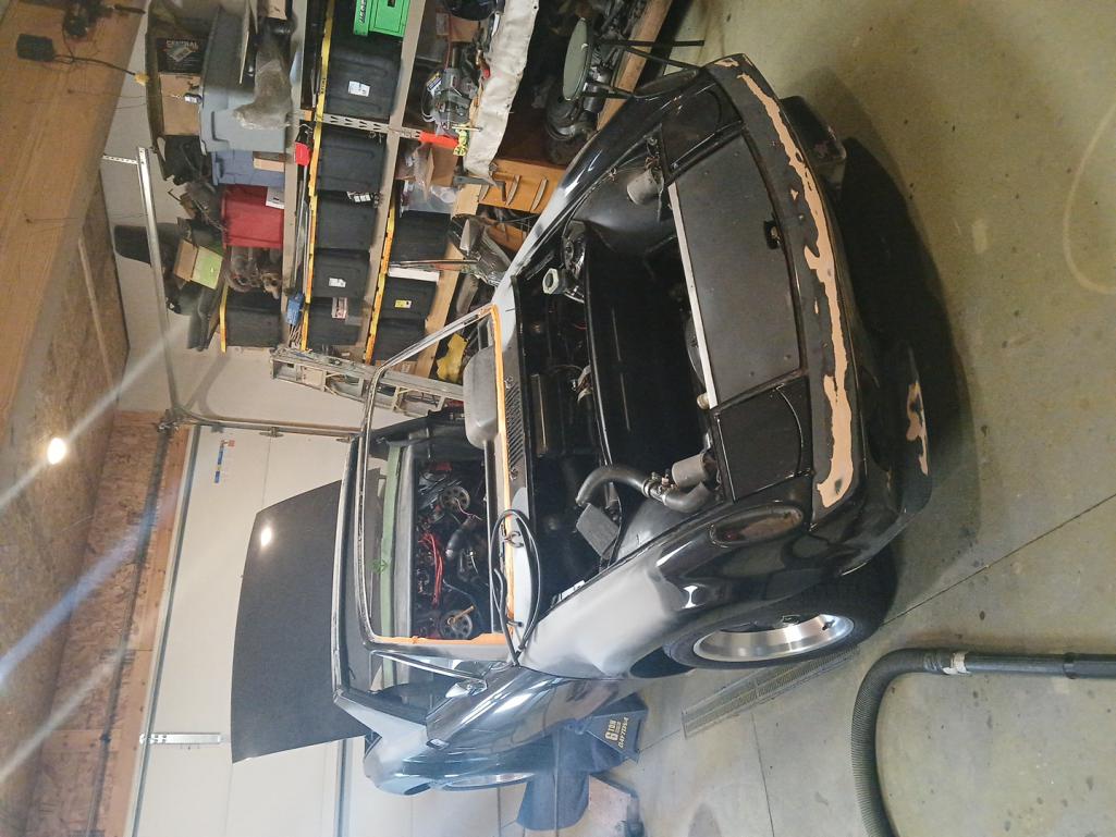

Just doing some time consuming stuff. Fixing wiring connections detailing stuff that looks like it hasn't been touched since 2003 be c cause it hasn't (IMG:style_emoticons/default/dry.gif) more progress coming soon. (IMG:style_emoticons/default/shades.gif) (IMG:style_emoticons/default/assimilate.gif)

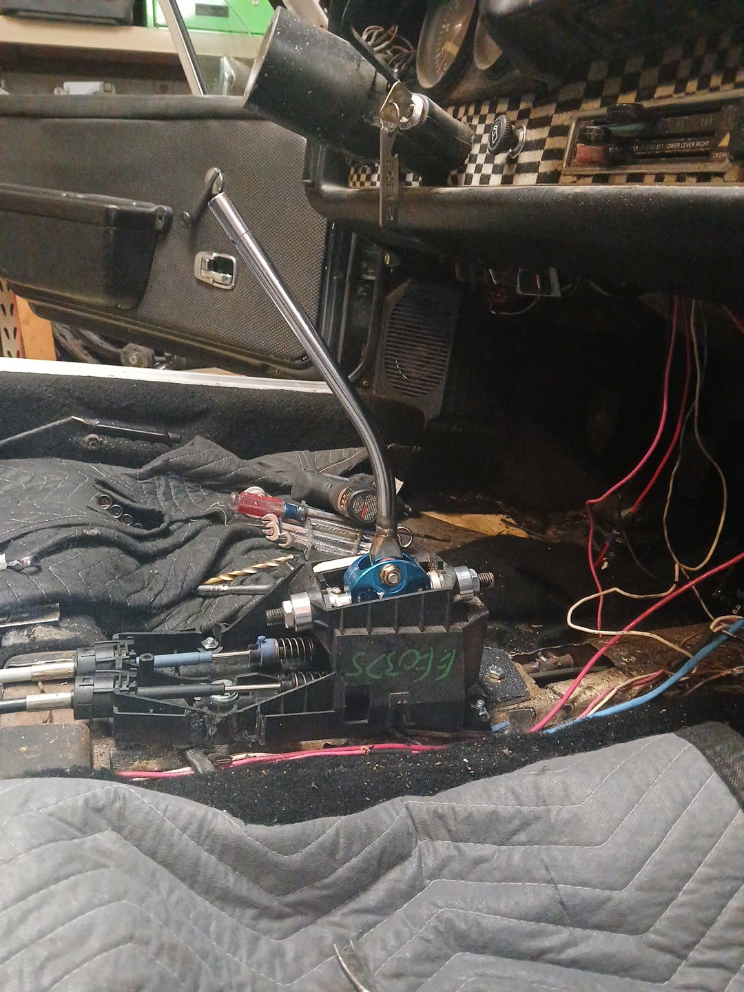

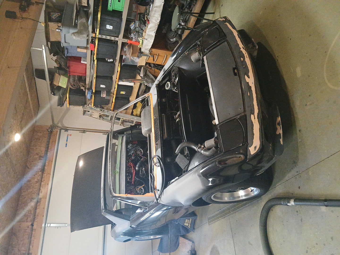

Boxster cable shifter with a 914 lever. I added the short shifter kit first. Then added the 914 lever. The throw is about the same as stock but crisp and positive.
(IMG:http://www.914world.com/bbs2/uploads/post-43-1753637469_thumb.jpg)
Gee.. where have I seen that before??? (IMG:style_emoticons/default/poke.gif)

Depending on the final feel I may shorten the lever a little. Working on building a console. The last one built by a friend of mine was too narrow and short to install over the Boxster shifter.

I started with mine about the same length as yours. Ended up way shorter to get the feel I liked.
And I have a custom console planned for mine too. But I don't know what to do with the face of the console. I was thinking about a full sized PCCM unit from a Boxster/Cayman. You can pick them up cheap these days.

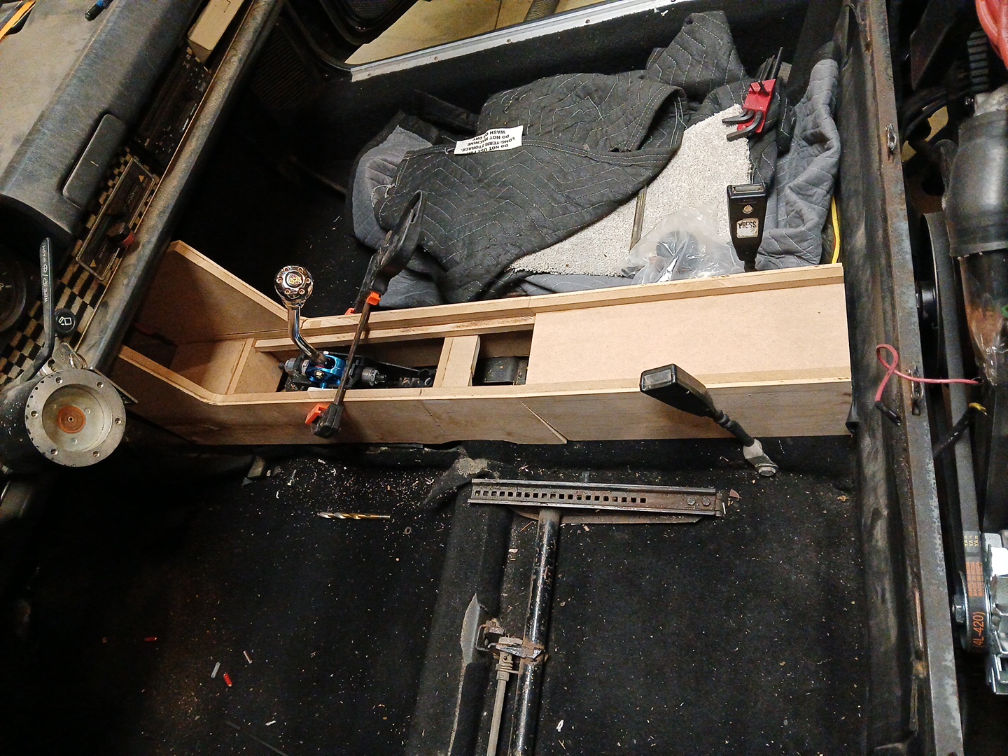

Roughed in the console. I like the stock style console. It is very hard to make something like a stock console and get it to fit over the shifter. I cut a bunch of plastic off the shifter housing and it.is still tight. The biggest issue is the neutral gate. There is a plastic rocker that sticked up pretty high the moving the shifter all the way to the left.Attached Image
rick 918-S
post Jul 29 2025, 09:31 PM
Post #860
Posts: 21,324
Member No.: 43
I used 1/2 MDF and bonded 1/4 plywood to the outside. The MDF is hollowed on the left side of the shifter to allow some width to the top rail but allow the console to move as far to the right as possible
