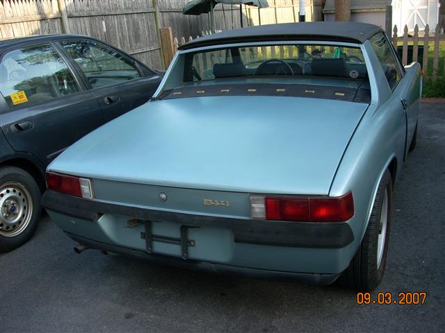

can you give us a photo of the car
From the rear of the car, along the passenger side so we can see the profile of the full passenger side of the car, taken while kneeling down. from that we can see how far off the door and the rear quarter is.

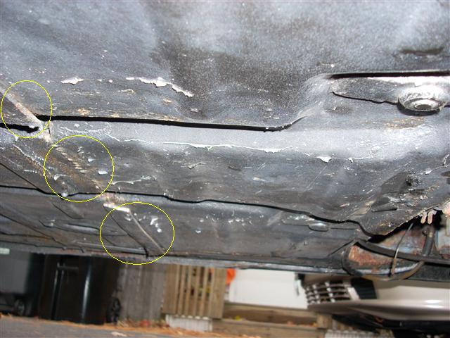

That pic of under the car looks like the car was sectioned as you can see a welded
seam
roadster fan
post Oct 26 2007, 12:25 AM
Post #36
Project Frankenstein !!!!!!!!
Posts: 1,009
Joined: 24-November 05
From: Aptos, CA
Member No.: 5,184
I think Craig is talking about these spots. In the center area you can actually see the weld beads. It looks like the other areas I circled are some type of reinforcement. It looks to me like the back half of one car was added to the front of another, also.
I will get you a picture of the bottom of my car tomorrow so you can see what it should look like in that area. You may try to find differences in paint color in hidden areas in the front and rear, that would help confirm also.
If it is a good running car, you can probably recoup your investment by parting it out, so dont feel too bad if you decide you can't live with it as is.

QUOTE(Travis Neff @ Oct 25 2007, 02:02 PM) *
Here is a pic from the rear of the car. I think if it is a bad hack job I can live with it for now ( as long as it is safe ). If I can get a 4 or 5 good years out of it I would be happy.
