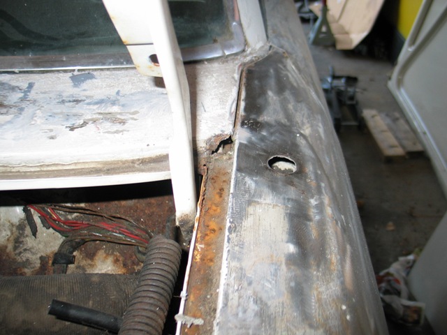

I'm sure I'm not the only one to see rust in this spot. This is the intersection of the front trunk channel and the front cowl. I have the same issue on both sides. How have others repaired this?

This is a very hard area to repair. The only way to fix a very rusty area is to cut it out and re-weld in new metal. You may be able to find a donor that has a section you can cut out and weld in. Or, you may cut out only the rusted areas and weld in pieces. In this area, it is hard to get to the bottom of the joint, so it is hard to fix. Goog luck. JoeO

we cut out a piece of the fender and then as Joe says fabricate a piece. We have the replacement stamped patch panel in the works but it is not ready yet

When I fixed that spot on mine I cut the fender, then bent up the metal in a vise (since its a relatively small length), welded in the patch and then fixed the fender. I don't know how your fender is, but mine was already pretty messed up so cutting it didn't cause too much trauma.

My fenders are great. So, a lot of this (IMG:style_emoticons/default/sad.gif) to have to consider cutting them up there. They'll need to be cut to add the steel flairs but that seems relatively easy in comparison to this. Any photos of your repair?

Sorry, I just looked and I only have the after re-welding and filling pictures. It wasn't too tough to do, the section was just a PITA. It was one of the last pieces I did because I really didn't want to try working there.
If I was to do it again, I would recommend cutting the cowl off. Then I would fit the metal to the cowl and weld anything you can't get on with the fenders on. After that I would put the cowl back in place and weld the remainder or the seal channel back on.
Its not really a hard repair, just tedious. Good luck (IMG:style_emoticons/default/smile.gif)
