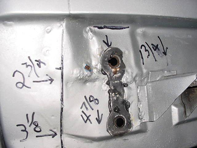

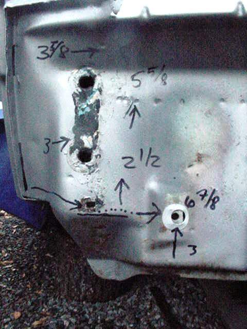

these should get you in the ballpark jim. demensions are to approx the hole centerlines. let me know if you need other shots.

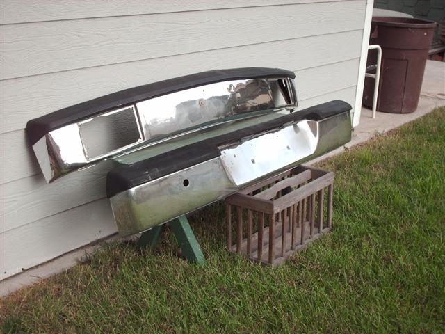

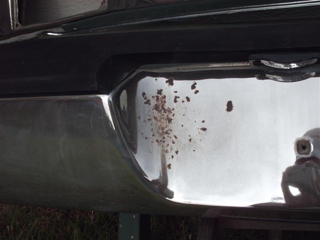

Is all re-chroming pretty much the same process. Is there anything in particular one should be sure the process includes. Both bumpers are in good condition, one has a small ding, the other is shedding some chrome. Ss picture below.
Most of the places I have been to sub out the chrome work to place outside my immediate area.
Got the studs...read your thread.
boxstr
post Nov 4 2007, 09:48 PM
Posts: 7,522
Joined: 25-December 02
From: OREGON
Member No.: 12
Jim I think that smaller chrome shops are harder to find these days. Most of them are into production work. I think Leamon had a shop that had a great price.
The one shop I use here in Portland is Oregon Plating. They do very high quality work , and you pay for it. The reason for higher price is triple plating, that means more dipping and more brass to help hide flaws. Check around and get quotes and ask the shops what you get for the money.
I have tried another place close to CAMP 914 in Oregon City, but I was not happy with the finished product.
One thing that I have been told is let the chrome shop take care of any flaws or dent removal. By doing it yourself you can cause more work, more money.
CCL
craig downs
post Nov 4 2007, 11:25 PM
Posts: 770
Joined: 25-November 05
From: mira loma ca.
Member No.: 5,189
Problem is a lot of chrome shop are owned by flakes so make sure you go to one that is recommended. Don't skimp ether and definitely go with a triple plating the look is
so much better
