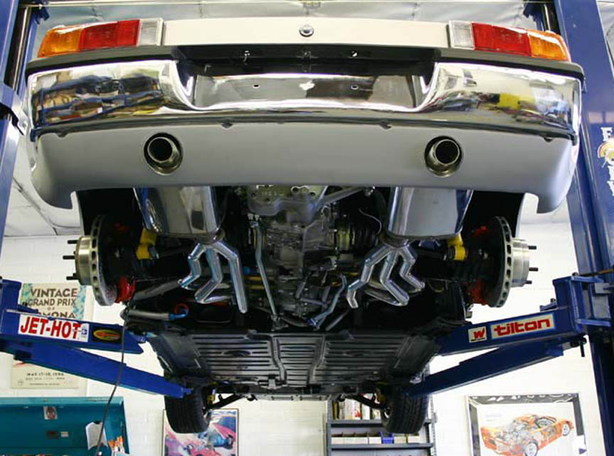

post Nov 18 2007, 01:39 AM
Resident German
Posts: 42,517
Joined: 21-January 03
From: Oakland, Kalifornia
Member No.: 179
PMS mufflers ...
nice sounds and not too loud at all.
(IMG:style_emoticons/default/bye1.gif) Andy

Enigma
post Nov 18 2007, 10:59 AM
Posts: 34
Joined: 4-November 07
From: Ontario Canada
Member No.: 8,298
Would you know what is the diameter of that M&K muffler?
I need to make sure its going to fit under myh rear valance as
the car has the 916 style bumper.
Cheers
PRS914-6
post Nov 18 2007, 01:34 PM
Excellence Magazine Project 914 3.6
Group: Retired Members
Posts: 1,278
Joined: 20-May 06
From: Central California
Member No.: 6,031
QUOTE(Enigma @ Nov 18 2007, 08:59 AM) *
6"
