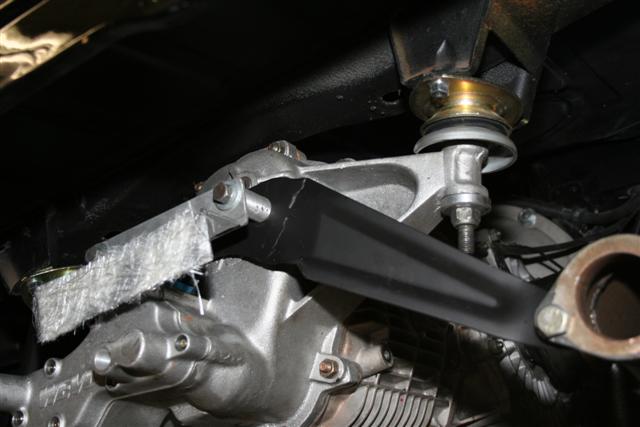

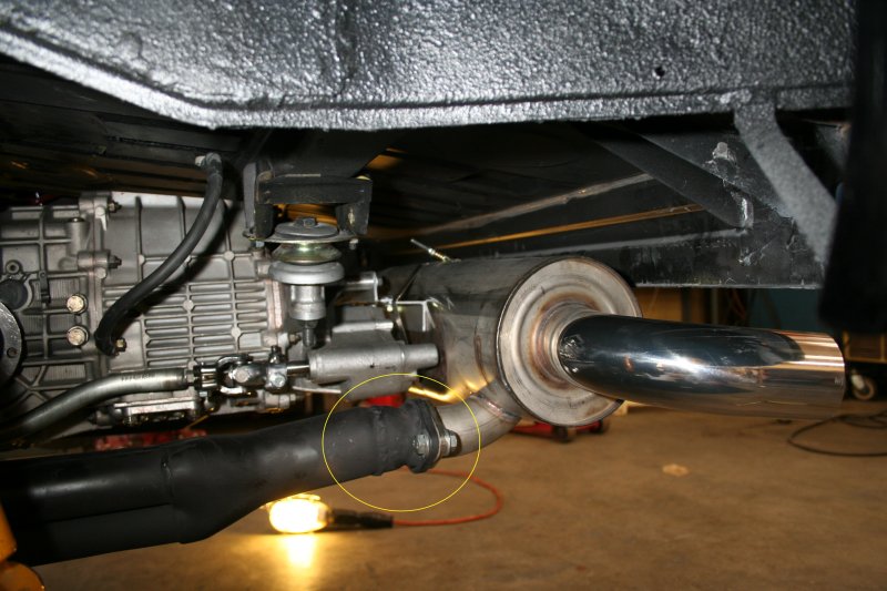

I used a M&K. I extended my headers a couple of inches. Here are some pics...

QUOTE(PRS914-6 @ Nov 17 2007, 11:11 PM) *

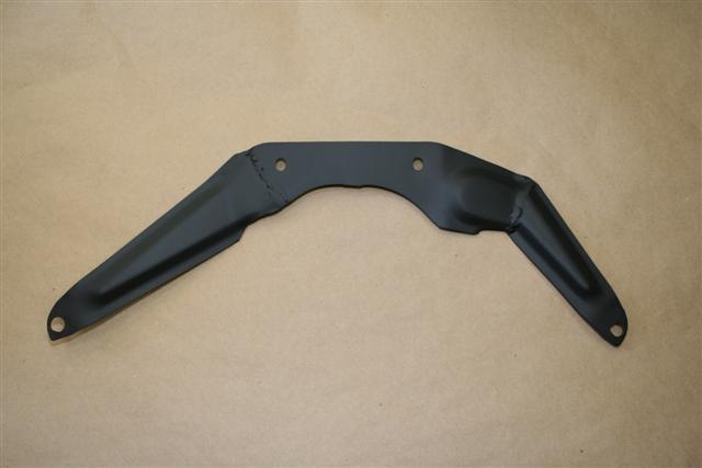

Brackets....and home made header extension (yes cut off the flange and weld on) Parts can be bought at any muffler shop.

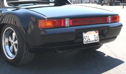

East coaster
Mine:
http://www.914world.com/bbs2/index.php?sho...&hl=muffler

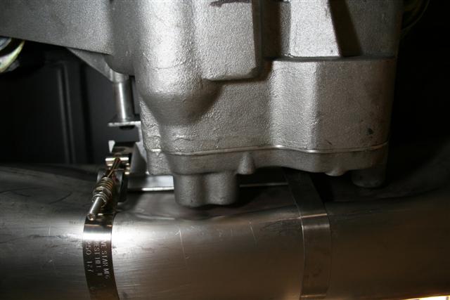

Ok,
This is what I ended up with, I only had 4 1/2 Inches of clearance between the Wevo end case and the 916 valance.
This is a new steup offered by PMS.
