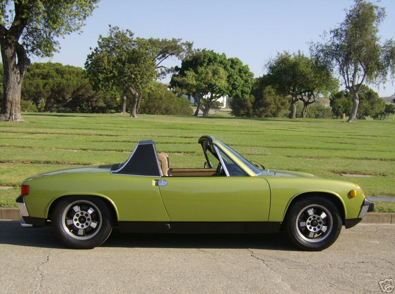

oh, and here's a pic of the new girl.

that is a beautiful color!
no help from here on the topic at hand though.. sorry...
but nice car

Nice car!
