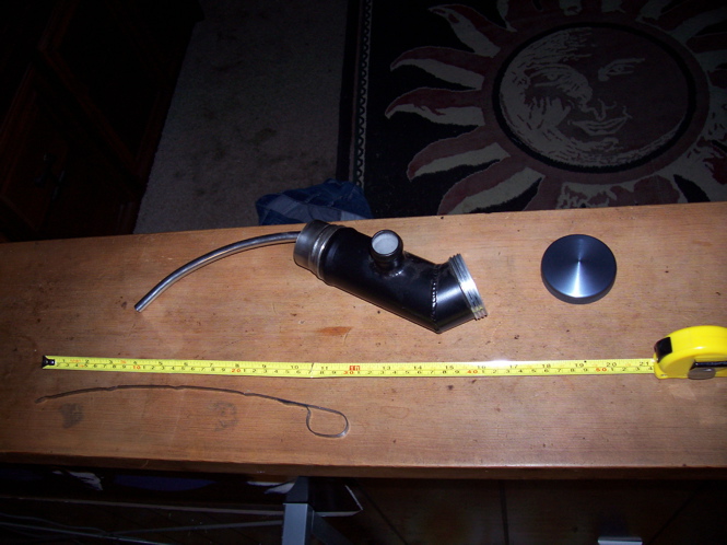

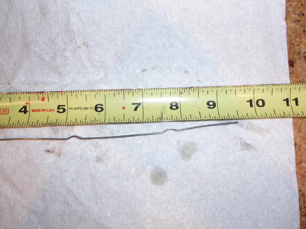

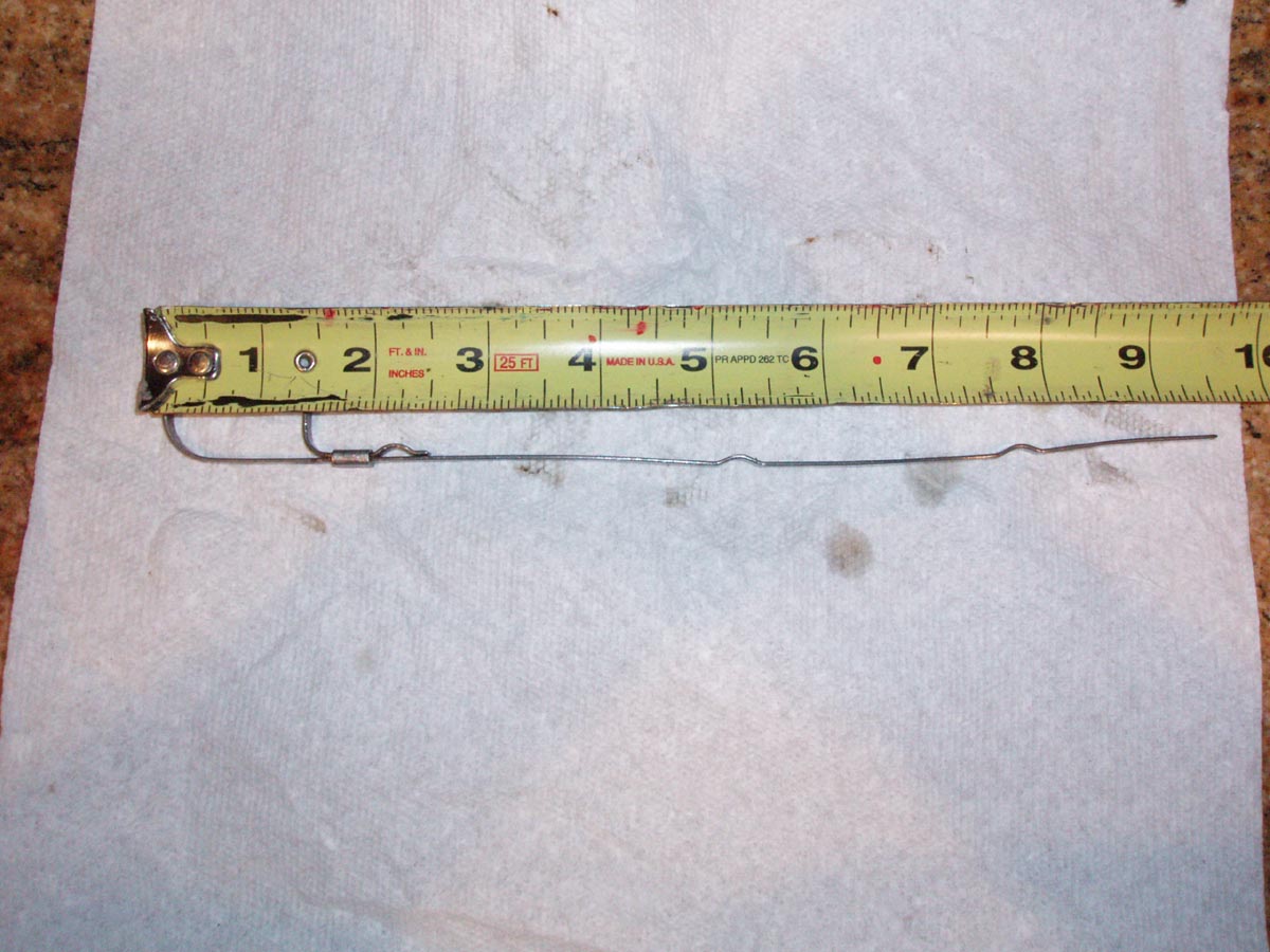

Mines even shorter than his... (IMG:style_emoticons/default/sad.gif) just over 9"
(IMG:http://thesey.com/pictures/dip1.jpg)
(IMG:http://thesey.com/pictures/dip2.jpg)
(IMG:http://thesey.com/pictures/dip3.jpg)
(IMG:http://thesey.com/pictures/dip4.jpg)
(IMG:http://thesey.com/pictures/dip5.jpg)

here is a ???????
smokey
post Nov 19 2007, 07:44 AM
Posts: 533
Joined: 15-June 07
From: Freedom Ca
Member No.: 7,816
12 inches .
