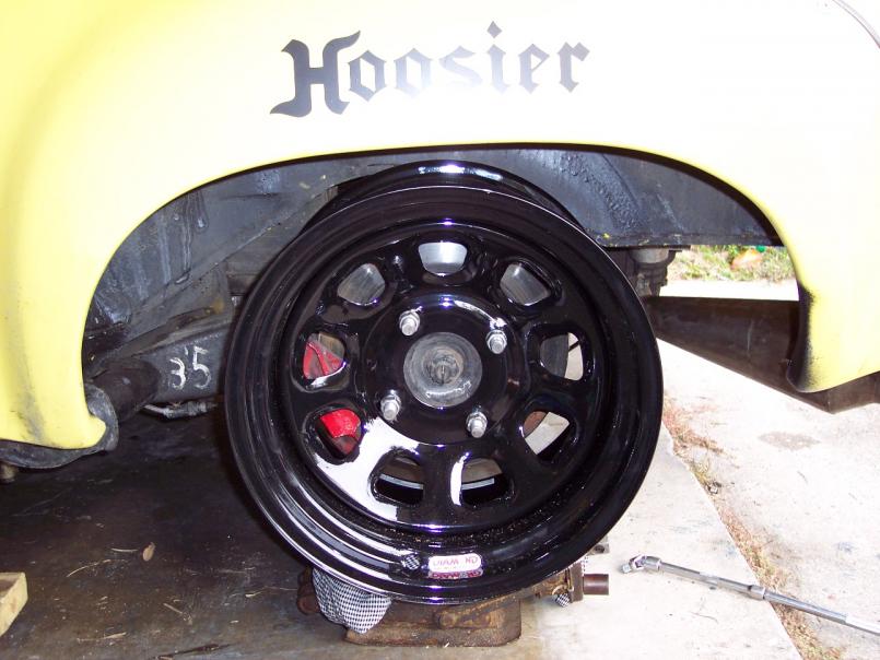

15 x 10 wheel and a 22 x 9.5 x 15 Hoosier slick PERIOD no bigger
I got my new wheels for the rear in Saturday. Diamond Racing made me a custom set in 6 days with shipping. Backspace is 5.75" and that's all that matters. 19 lbs and $295.00 for the pair shipped.

What does the wheel and tire weight together?

tire is 15
wheel is 19

That is TIGHT! Both in the teenage dialect, as well as in the classic definition. (IMG:style_emoticons/default/wink.gif)

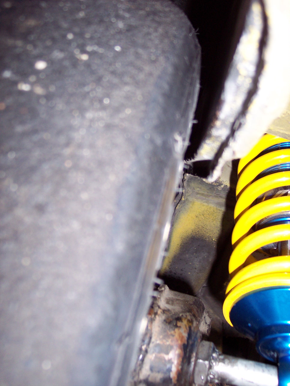

How's your inside clearance?

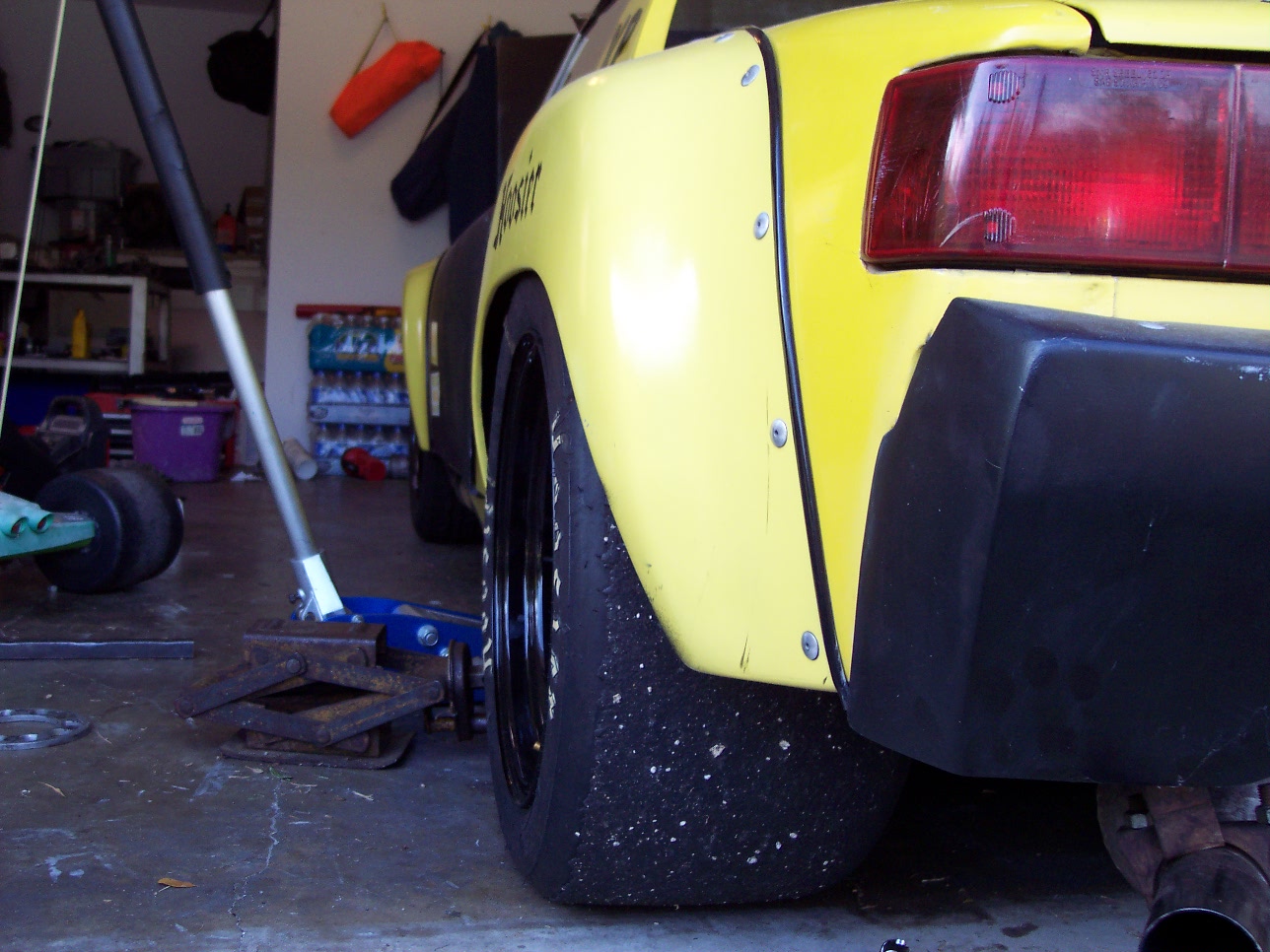

I'm curious to hear how close the inner wheel well clearance is. The slick size you mention 22x9.5-15 has a listed section width of 10.7" on a 10" rim. Does that agree with what you can measure? If so, then there's hope that the new 275/35-15 radials MIGHT fit under off-the-shelf GT flares.

Right now I am worried about ripping the suspension consoles off the car. Cage and ear re-inforcements are in the works.
This is my 2nd set of these wheels and they are pretty dang tough.
I watched the NASCAR race when Kenseth broke out the center of an AERO wheel. Shit happens.

I now know exactly what size Kiezer to have made However I am torn between these tires out back and Goodyear R250 Cantilevers up front on 8" wheels.
The A6 Ho's are 35 aspect ratio so should be a bit lower profile side wall. Have you tried to find a used set of 275/35-15 Hoosiers. I just want to do a test fit. Near impossible.

How are your flares held on and did you have to build out the body?

Fiberglass GT flares are held on with large head pop rivets and medium strength RTV adhesive. No massaging of the structure but I did cut off the entire lip and ground it smooth. there is a roundish edge lip left over from the mold as it formed the corner so it gives me a bit more strength.

I would worry about sidewall flex....

Shouldn't be too much as this is the size rim that the tire was designed for.
and if it rubs well I olny got 2 Diamond rims made not Like I bought a full set of CCW's
