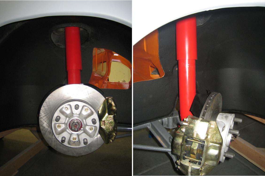

So finally got the correct Koni inserts for my Koni struts yesterday, was thinking I should wait to assemble but could not resist doing something with the new parts. All went together great except for the backing plate, I thought there was something wrong as it interfered with the rotor. After messing around for an hour finally figured out they were just bent, bit of tweaking and all is good.
Just need some tie rod ends and some wheels and it wil be a roller !!
When I was over at Renegade a couple of weeks back they had a car with the 17" Fuchs and they looked great, on my shopping list.
