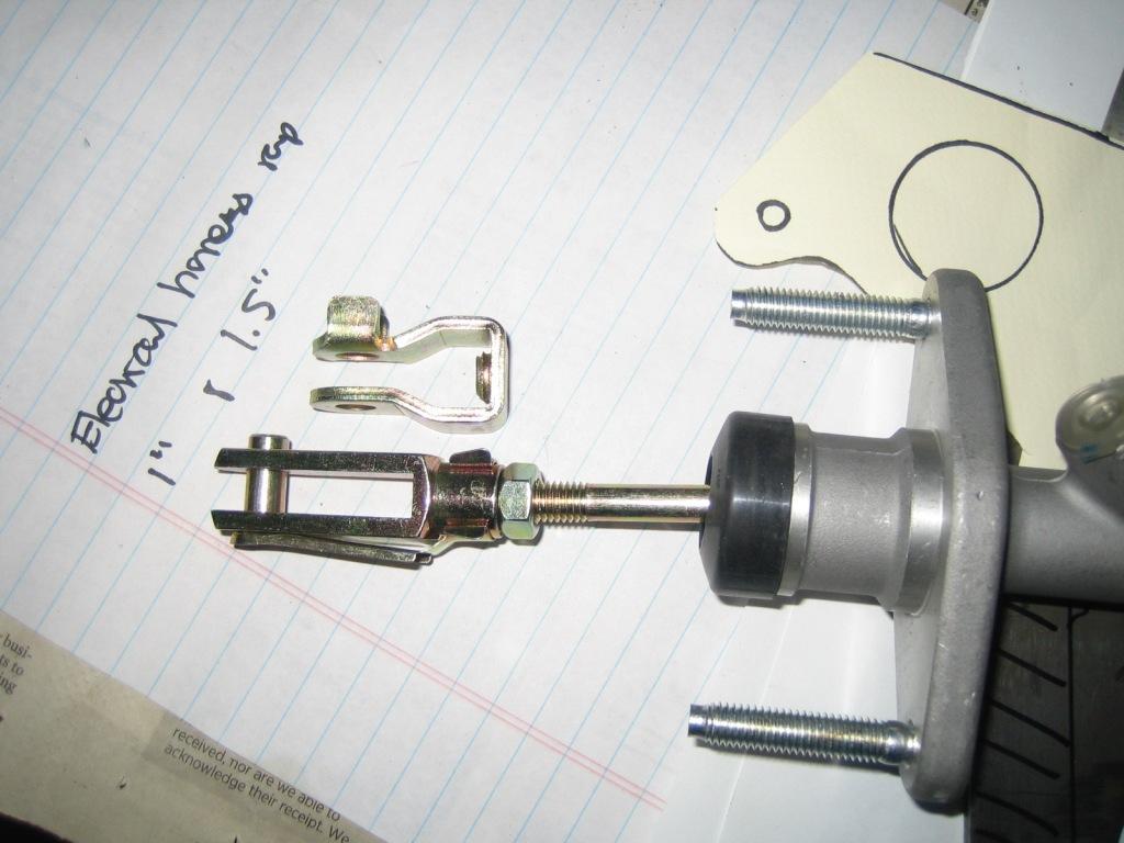

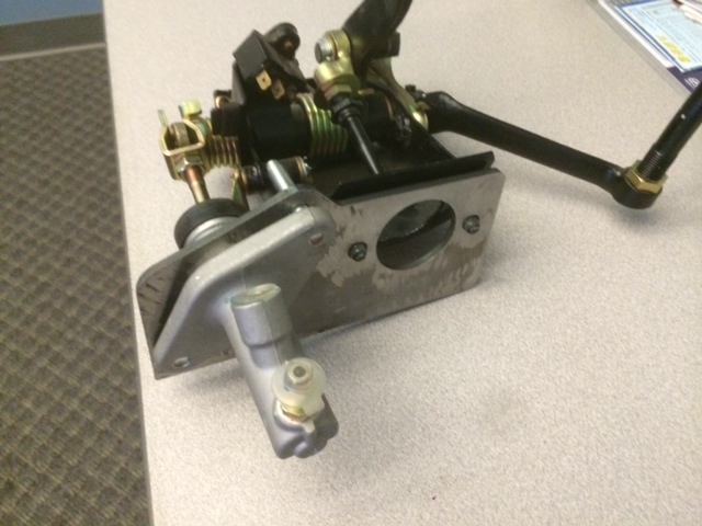

I was originally going to modify the Subaru clutch for a cable but with recent excellent solutions posted by others for the hydraulic setup I am going down that route.
Willwood setup is on its way but I am pretty sure I don't have room for it as my coolant house is in that area, the Civic unit is much more compact and I think it will work. Later this week when I get back in the garage I will know for sure.
Someone at work was kind enough to make the bracket I need, the Clevis joint that came with the Civic unit may need to be replaced with one that has more reach also.

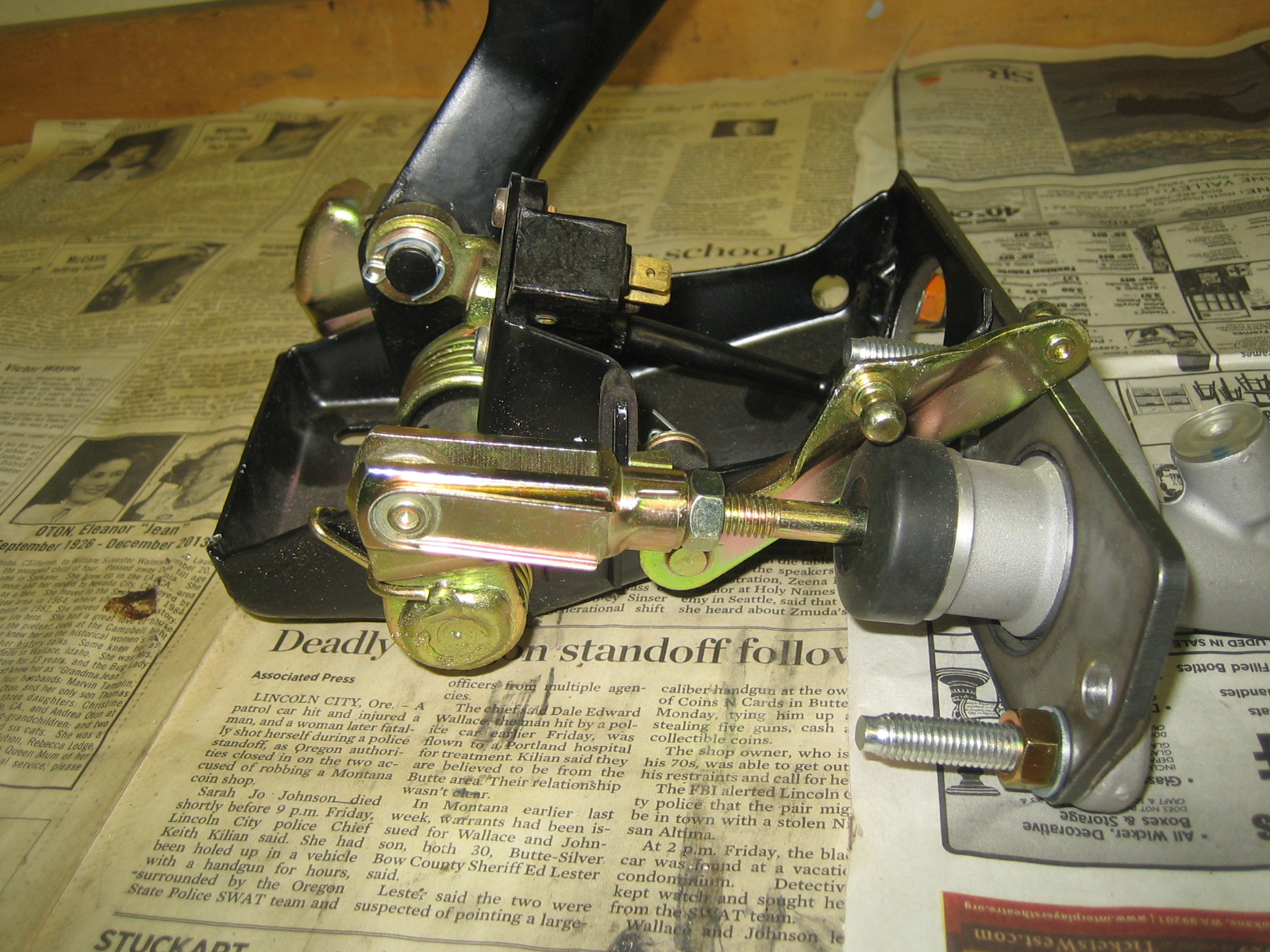

Looks nice Chris! The Civic master will definitely work, Bob has used it. What size are the threads on that? This is the clevis we used on the Wilwood:
Clevis
It's 5/16...

QUOTE(Chris H. @ Jun 17 2014, 07:31 AM) *
Clevis
It's 5/16...
Thanks!, the Civic is M8 so this might work
M8 Clevis

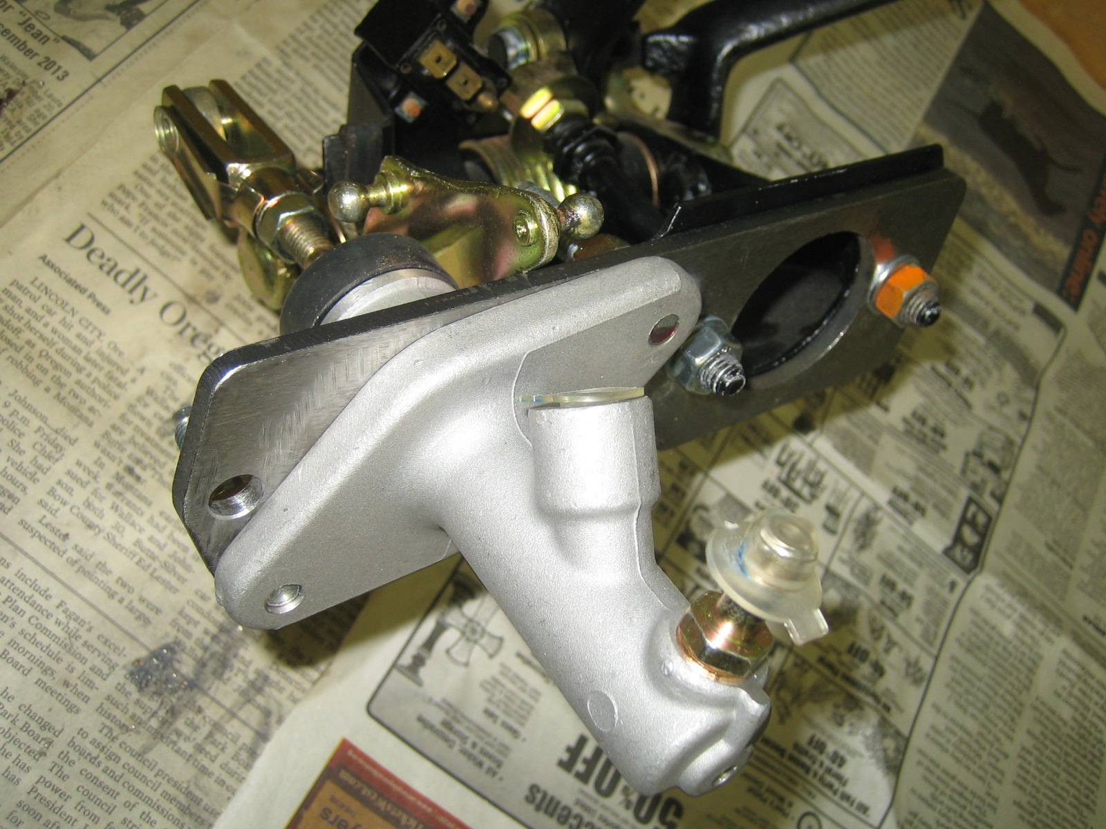

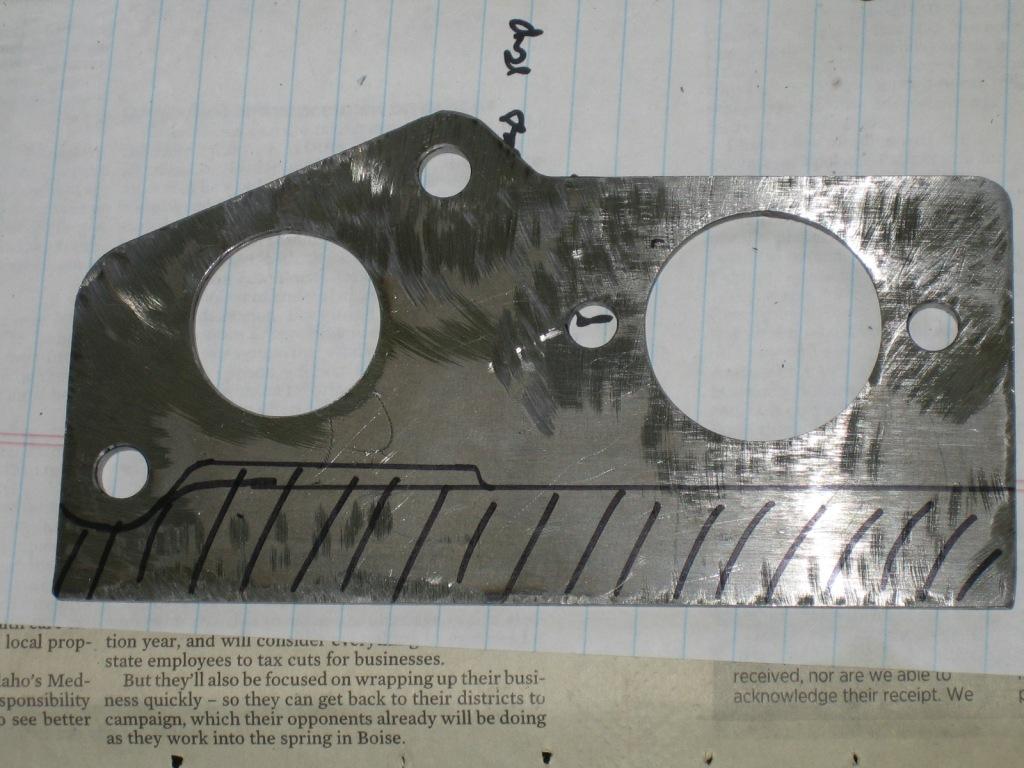

Got the new clevis and looks like it will be better than the one that came with the Slave.

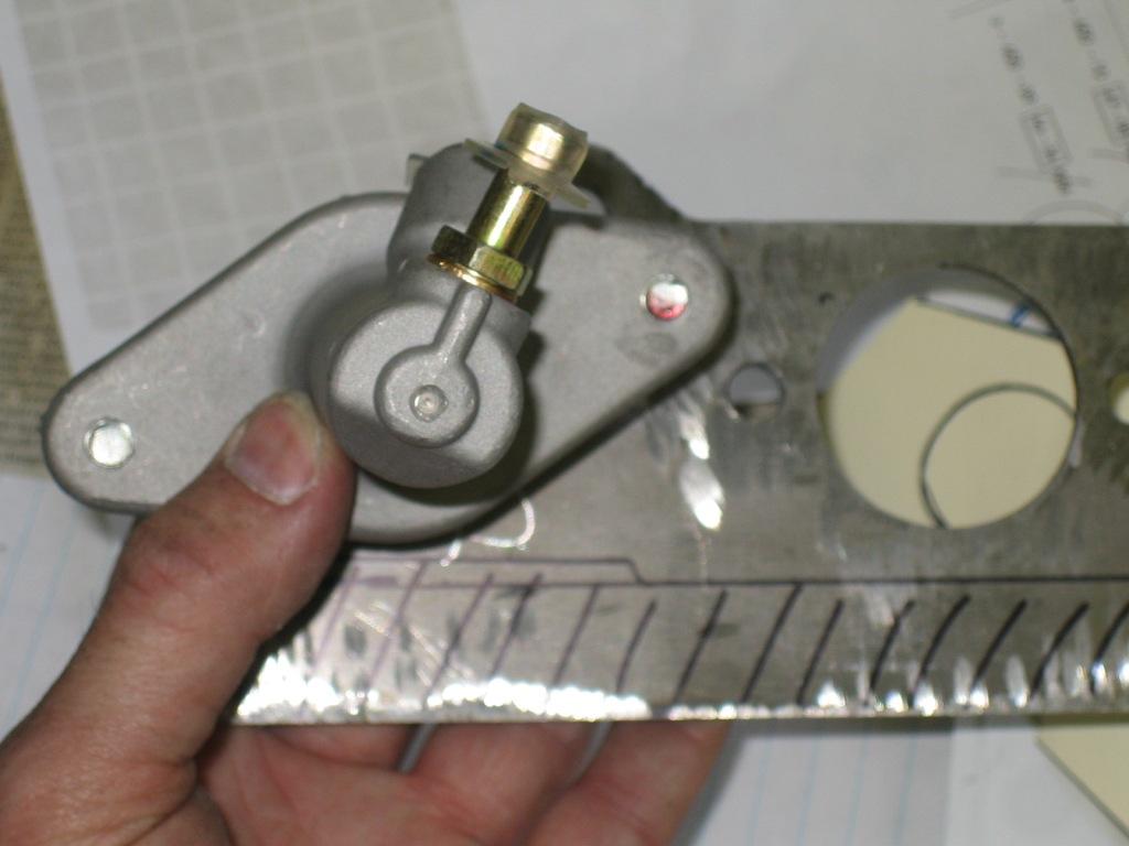

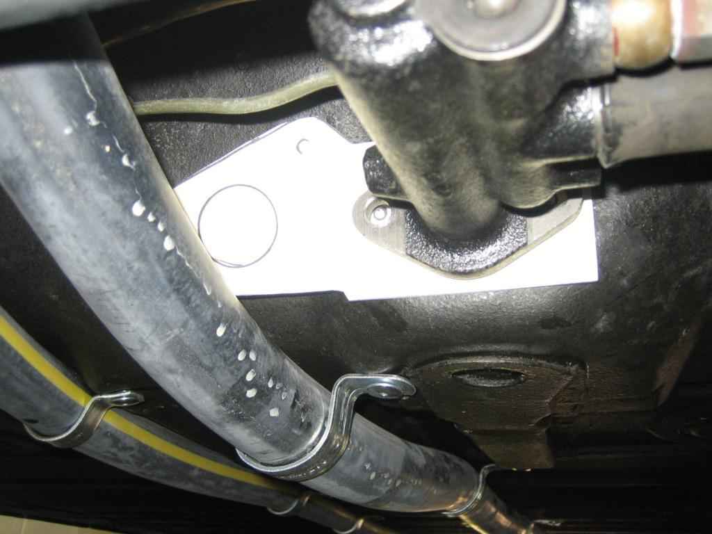

That is the good news, bad news is that the bracket I have will not work, the clearance with the coolant hose is making this a challenge. I mocked up a template.
I need to rotate the master cylinder clockwise by a few degrees so the lower mounting hole is raised.
You can see the how much material needs to be removed on the next bracket compared to the one I have.

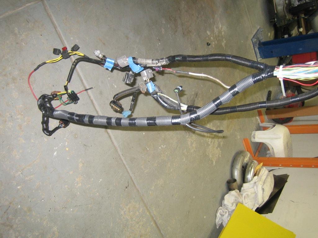

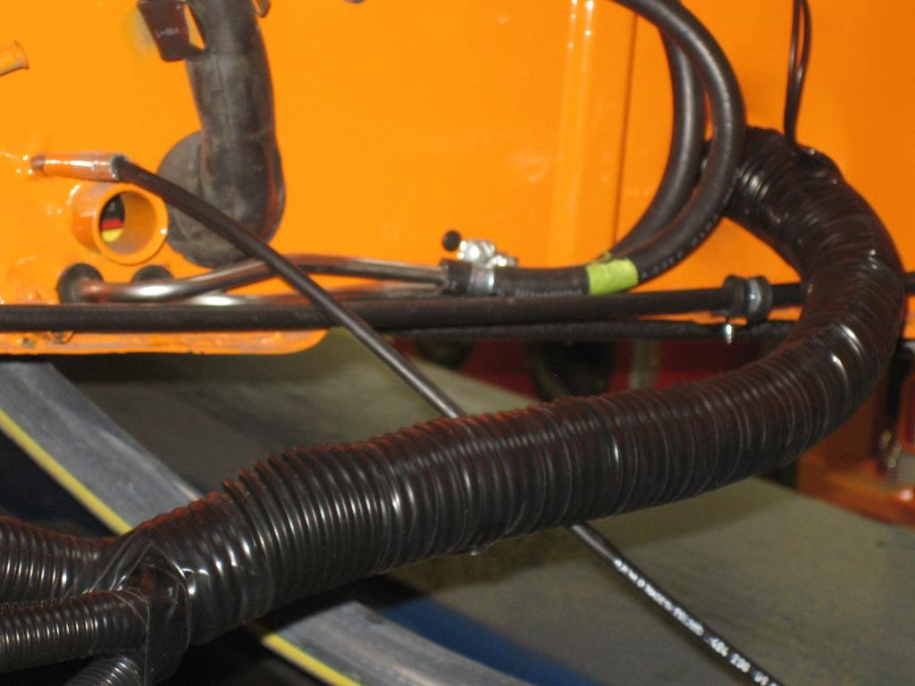

I have the engine harness all wrapped now, engine can go back in which will tidy up the clutter on the garage floor.

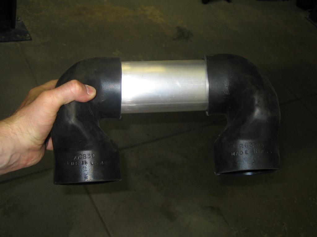

Have been looking for a while for tight radius 180 degree silicone hose for the intercooler connection but no luck, however, found these Cobra heads which will do the job nicely (need to trim the pipe obviously).

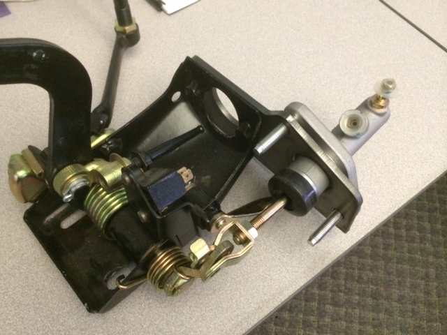

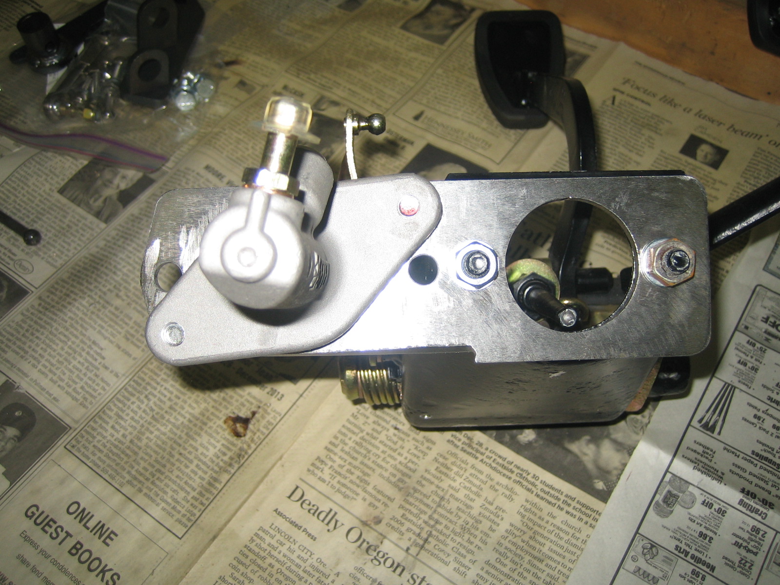

Clutch Master Bracket #3, I think this one is going to work. Fingers crossed.

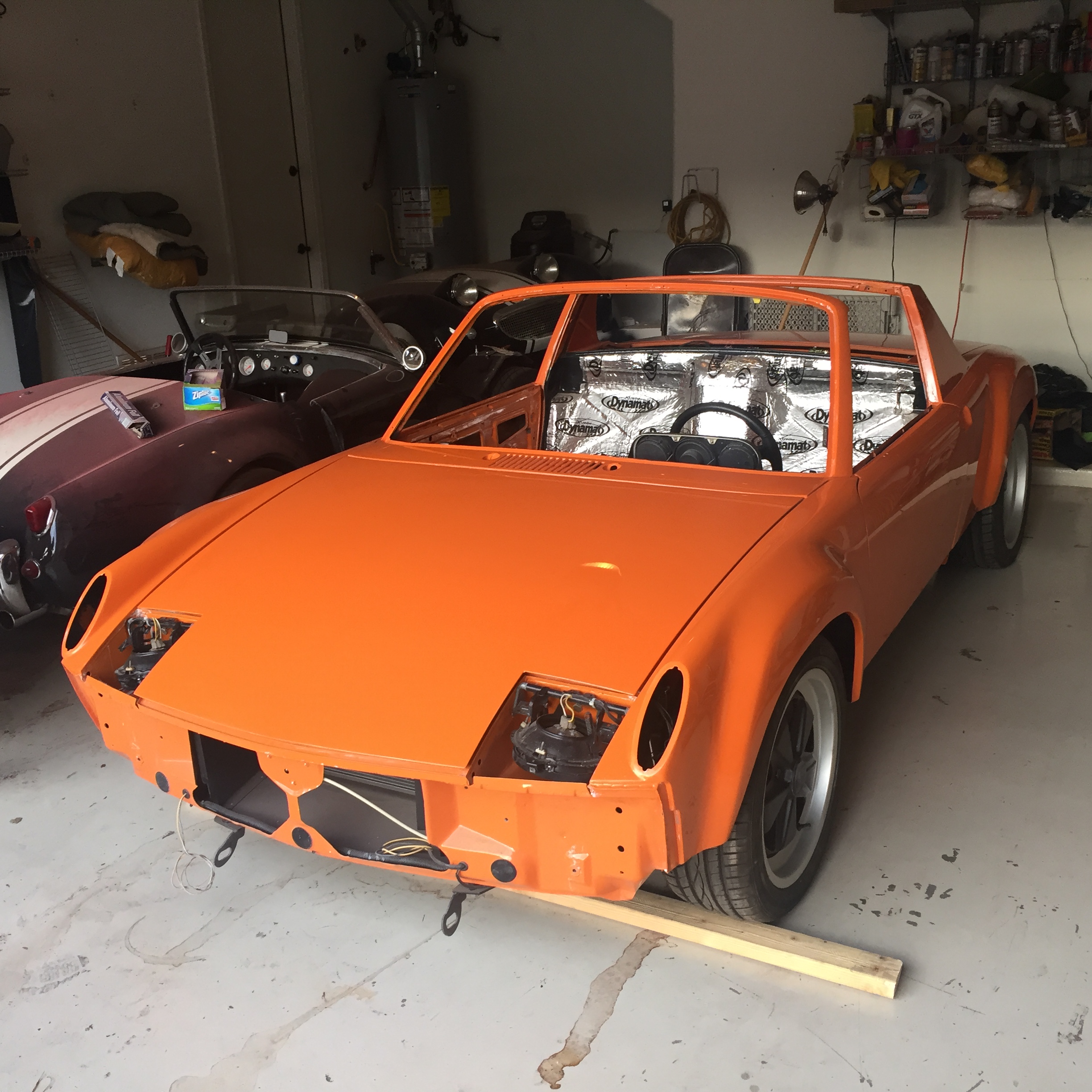

Just got the car back from paint. It is L30E which I put a pearl mid-coat into. I have six boxes which just showed up from 914 rubber with a whole bunch of interior parts in it. Next steps are interior installation, I am installing a larger intercooler and a bigger turbo. Sometime in the next couple of weeks the car will head to the dyno shop to get the car running.
