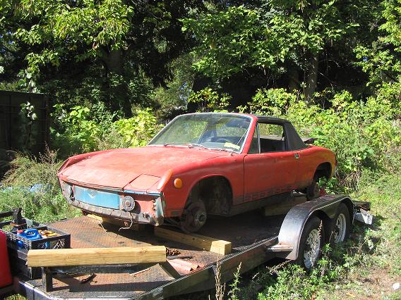

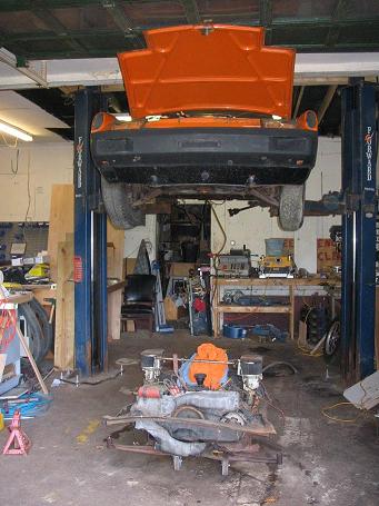

Here are a few pics for ya, Kapt. I will document my progress as I go forward.
1975 Parts Car
1973 Parts Car
