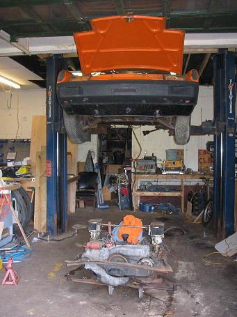

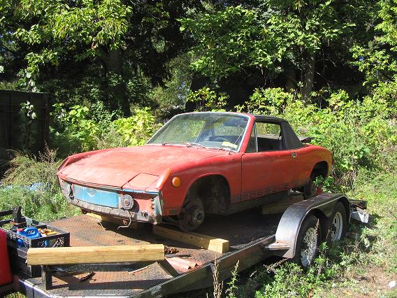

flippa
Dec 11 2007, 12:13 PM
Thanks for all the advice.
I will plan on having the injectors serviced, replacing the fuel lines & firing it up before pulling the engine out of the car.
Here are a few pics for ya, Kapt. I will document my progress as I go forward.
1975 Parts Car
Click to view attachment1973 Parts Car
