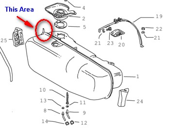

bperry
post Dec 11 2007, 06:38 PM
Lurker
Posts: 477
Joined: 16-February 04
From: Dallas, Tx
Member No.: 1,661
QUOTE(McMark @ Dec 10 2007, 09:20 PM) *
The tanks are the same in all years. It's the expansion tank that is different. Getting a spare to fix up is a good idea, but don't assume it's clean. Get a spare and clean it out and coat it, or send it out for galvanizing. Then install it. Maybe some new steel lines at the same time. (IMG:style_emoticons/default/wink.gif)
I don't think this is entirely correct. I believe that the tanks are identical but there
is a difference with some mounting tabs that are welded on the tank relating to the
expansion tank and charcoal canister that are different.
I attached a picture that shows the area that I believe is different.
--- bill
