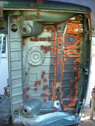

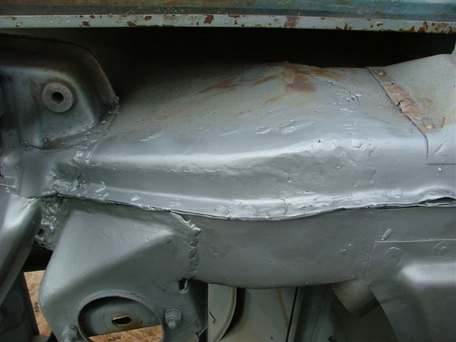

FourBlades   Hell hole finally makes it to primer heaven! ...   Feb 2 2008, 07:44 PM
SirAndy   nice progress! :trophy: did 'ya add th...   Feb 2 2008, 07:46 PM

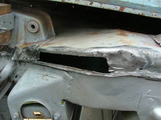

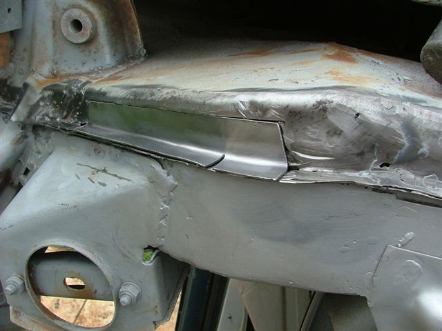

FourBlades   Cut rust out of front of passenger long. Notice t...   Feb 2 2008, 07:56 PM

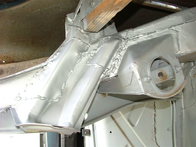

FourBlades   Innermost sheet metal welded in. Sleeving the i...   Feb 2 2008, 08:03 PM
FourBlades   Welded and cleaned. Nothing better than shiny new...   Feb 2 2008, 08:10 PM

FourBlades   Note that I use weldable primer on anything that w...   Feb 2 2008, 08:22 PM

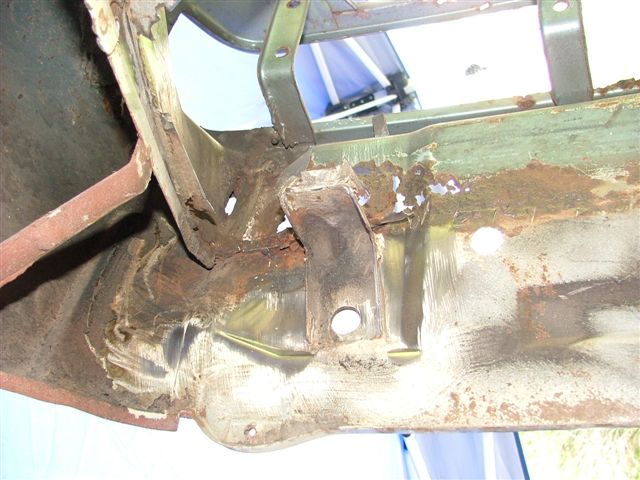

FourBlades   Fixing the driver side footwell and long. It is m...   Feb 22 2008, 06:44 PM
FourBlades   :blink: :blink: Peeling the rust bucket onion :...   Feb 22 2008, 06:53 PM

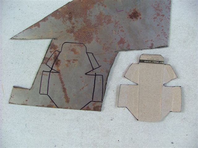

FourBlades   Rebuilding the first layer of the onion. Made a p...   Feb 22 2008, 06:58 PM
FourBlades   Rebuilding the second layer of the onion. Made a ...   Feb 22 2008, 07:14 PM

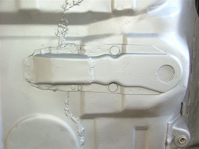

FourBlades   Fixing the driver's side jacking point. I cut...   Mar 31 2008, 08:31 PM

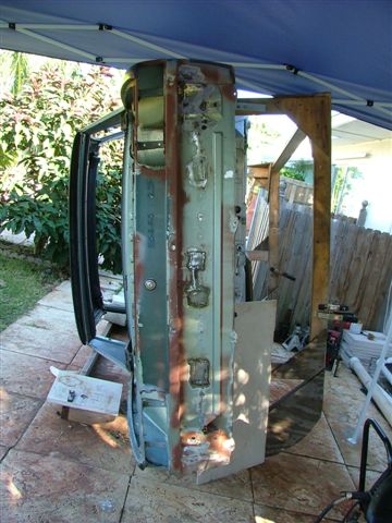

FourBlades   Flip Your 914 the CSOB Way I got fed up with work...   Apr 13 2008, 06:15 PM
FourBlades   Flip Your 914 Part Deux When the car was tipped a...   Apr 13 2008, 06:21 PM
slow914   dude, that is badass   Apr 13 2008, 06:50 PM
TROJANMAN   Flip Your 914 Part Deux It's like a 914 ...   Apr 15 2008, 08:38 PM
ericread   Flip Your 914 Part Deux It's like a 914...   Apr 16 2008, 12:15 AM
FourBlades   No, it is cheap ass! I think this cost about ...   Apr 13 2008, 06:59 PM
Bartlett 914   Looks pretty good. My car is on a rotisserie. It i...   Apr 14 2008, 09:04 AM
FourBlades   Mark, My motivation for doing it this way was to ...   Apr 15 2008, 08:13 AM
Gint   That's kickass! Thanks for posting that.   Apr 15 2008, 08:21 PM
tracks914   That's just insane!!! For the 914 ...   Apr 15 2008, 09:14 PM
McMark   Either way you were gonna be famous. This way you...   Apr 16 2008, 02:16 AM
tdgray   Congrats... now there is thinking outside the box....   Apr 16 2008, 08:28 AM
Eric_Shea   Way to go... cool thread! :trophy:   Apr 16 2008, 09:12 AM

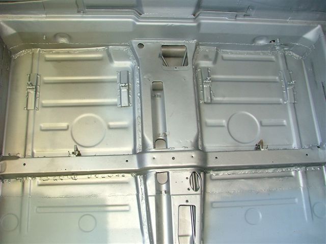

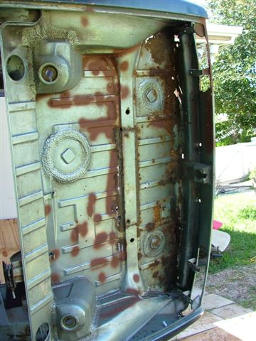

FourBlades   Finished welding on the floor pans and primed them...   Apr 25 2008, 12:03 PM
FourBlades   Primed front of passenger compartment and floor pa...   Apr 26 2008, 05:44 PM

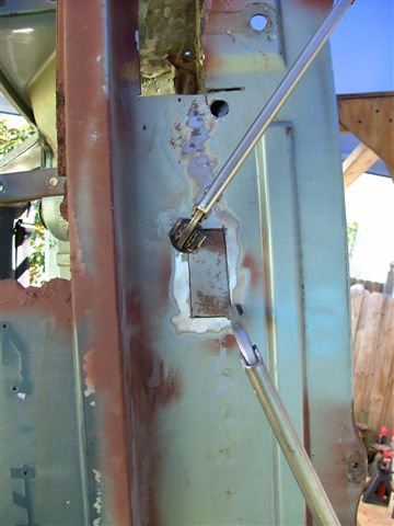

FourBlades   Building the armageddon proof clutch tube!...   May 29 2008, 08:11 PM
FourBlades   Took me a while to figure out what tubes and cable...   May 29 2008, 08:23 PM
