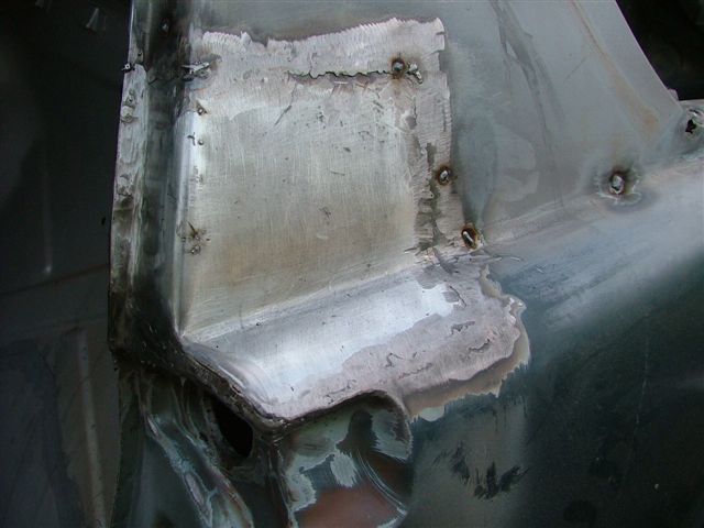

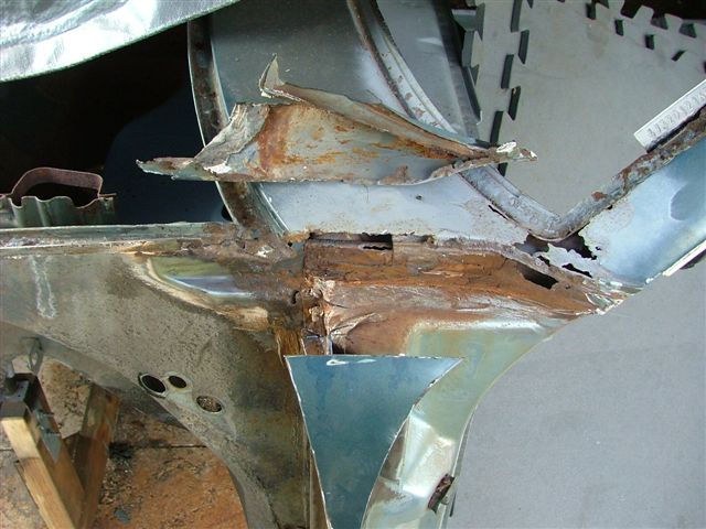

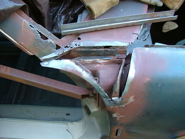

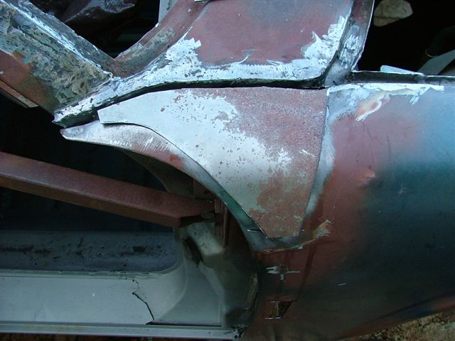

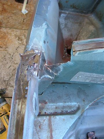

Started working on fixing the driver side cowl and front fender joint. This seems
like a complex part of the car where a bunch of different panels come together.
Bottom of the door pillar is also rusted out.
Cut off most of the fender to see what was going on.
Clean it up and cut away the bad parts. Hit it with some metal ready.
Rebuild the area from the inside out. I am not completely sure how these
panels went together. I was really torn between retaining the drain (rust)
channel between the fender and the cowl and just welding it all up solid.
Some people say you car will crack there if you weld it solid.

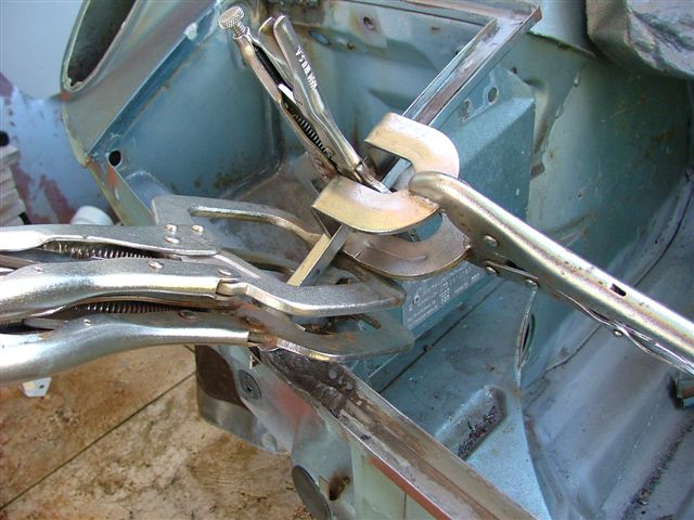

First patch going on.

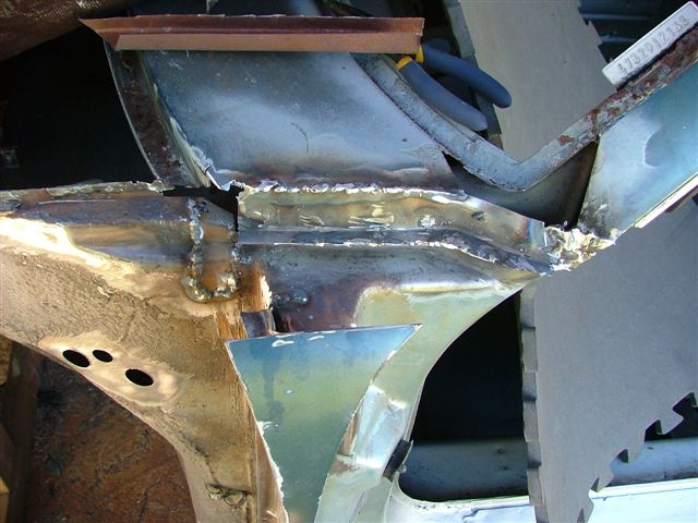

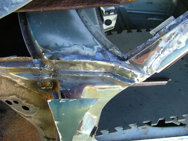

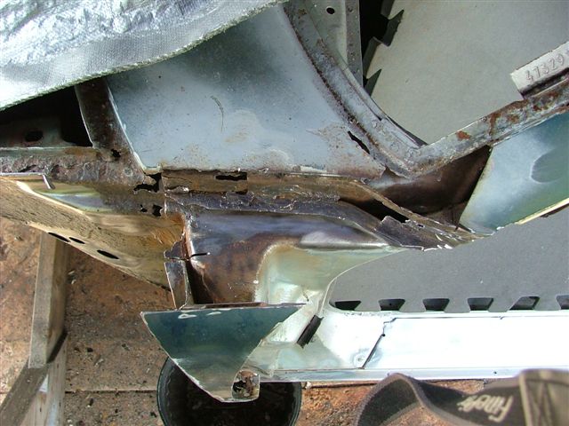

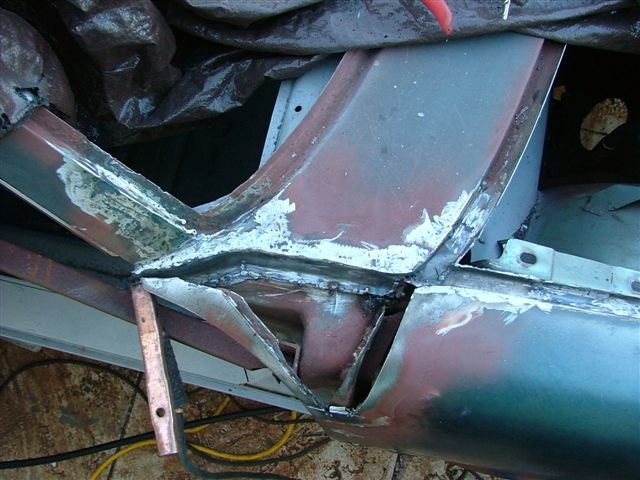

First two patches welded on.
A patch made from a windshield surround a board member used to protect a
windshield they shipped to me. The irony is the windshield metal from the cut
up donor car is far better than the rust bucket I am rebuilding.
More patches for the windshield surround.
Still more patches to the rain gutter and front corner of the cowl.

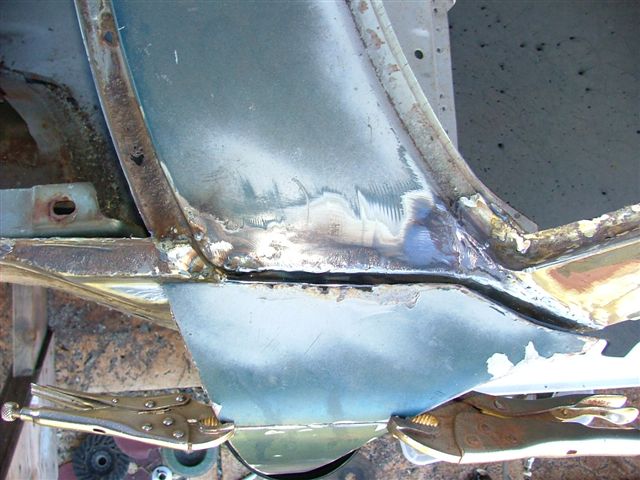

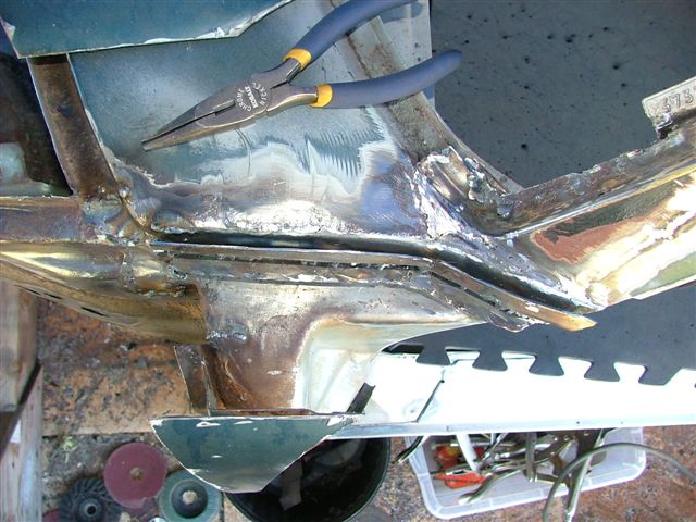

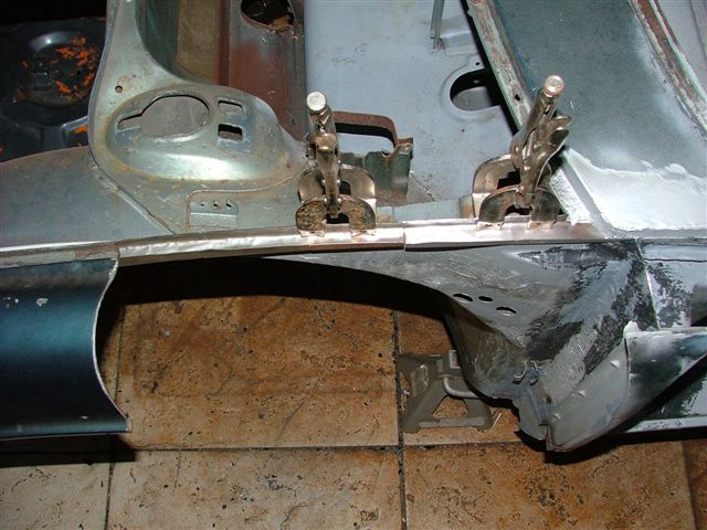

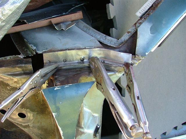

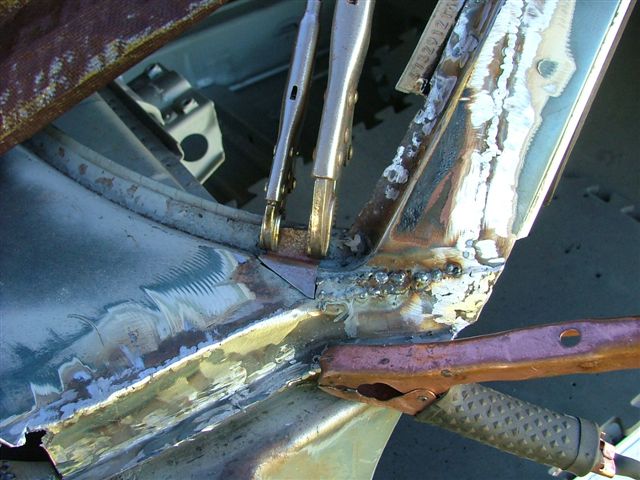

Rebuilding the rain gutter had me really stumped for a while. There was nothing
left of the original metal on my car to look at as a pattern. I decided to weld on
some pieces to form the gutter and then weld the fender to them. I don't see how
Porsche ever spot welded this area together because I can't see how they
accessed both sides???
Here is how the fender will sit. It will be seam welded to the top of the gutter
pieces. I need to make sure the body lines from the hood to the fender and
cowl are all correct.
This far took me about six hours. At least an hour was just trying to figure
out how to proceed.
I think this repair might end up being a tenth of a point deduction in a concours.
I may have to give up my dream of a Pebble Beach Best of Show Trophy...

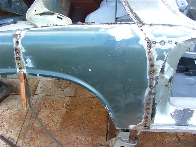

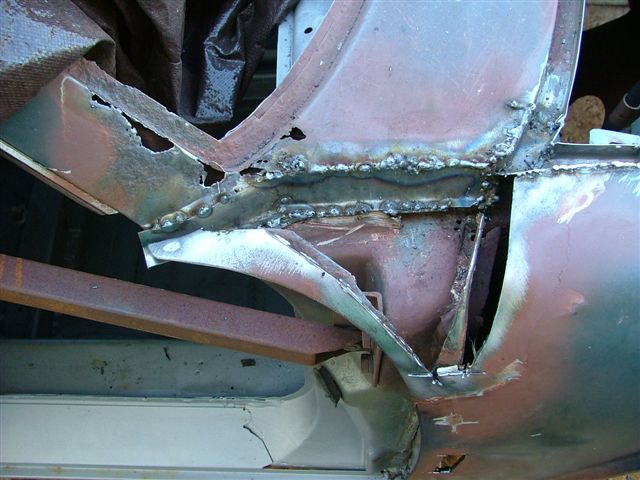

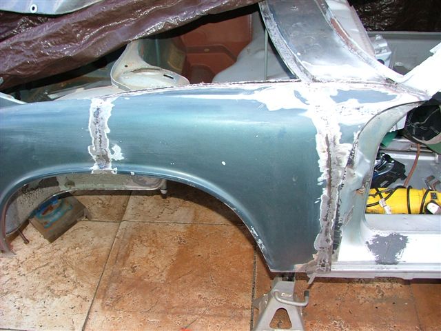

Fixing the cowl and fender - The Second Day

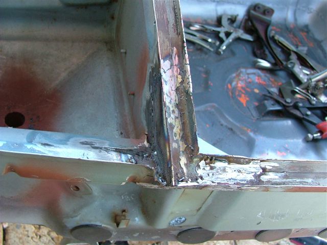

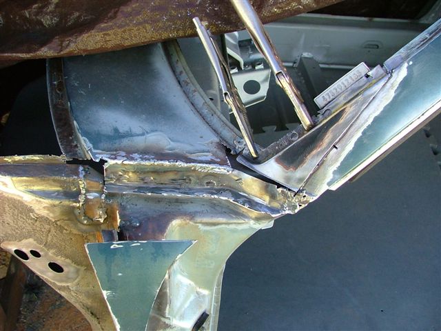

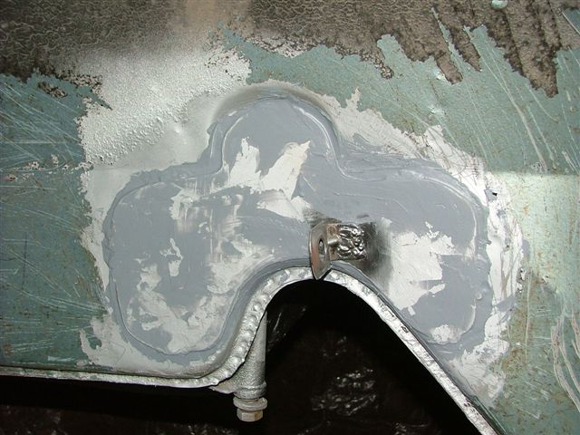

While I was in there with the fender cut off, I made a reinforcing plate for the
anti-roll bar mount, rewelded the brake line clip, and seam sealed it.
Made up some replacement hood channels.
Welded them on.
Tacked the fender pieces back in place.
Added tacks little by little until they were solidly welded, then ground it down.
After I put on 40 coats of hand rubbed bondo it will be a 10 footer. (IMG:style_emoticons/default/rolleyes.gif)
The whole cowl and fender repair took about 20 hours spread over multiple days.

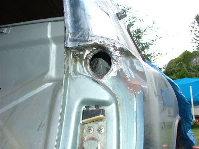

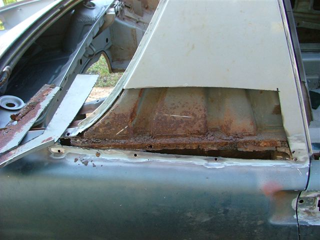

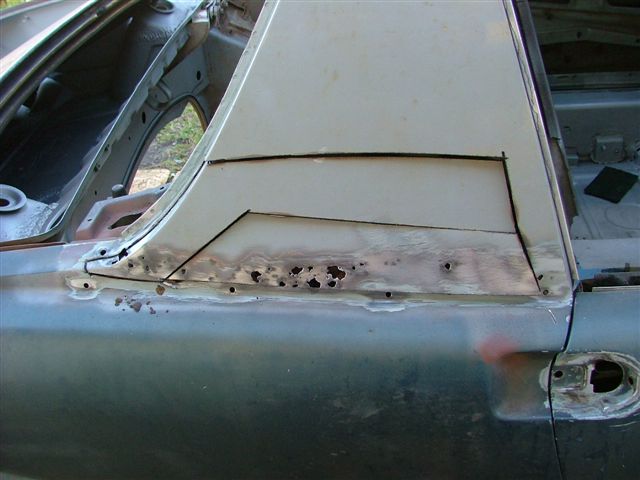

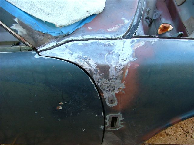

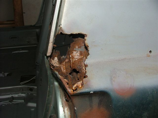

Fixing the driver's sail panel. This hole provides a little too much ventilation. (IMG:style_emoticons/default/smile.gif)
Cut away all the rusty stuff. Unfortunately the metal tube connecting the door
vent to the interior vent was rusted to nothing. I decided to weld up the driver
side interior vent and lose what was left of the tube. I will keep the door vent
but seal it up just to keep a little more stock look. You can see two patches I
made and welded to the interior.

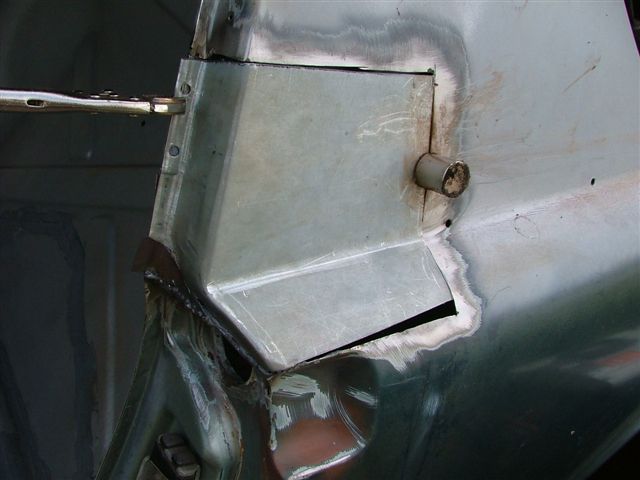

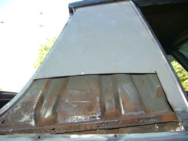

Fitting a piece of the AA sail panel. This is a tricky area to get to fit right.
Somehow I screwed up on fitting this patch and left a big gap.

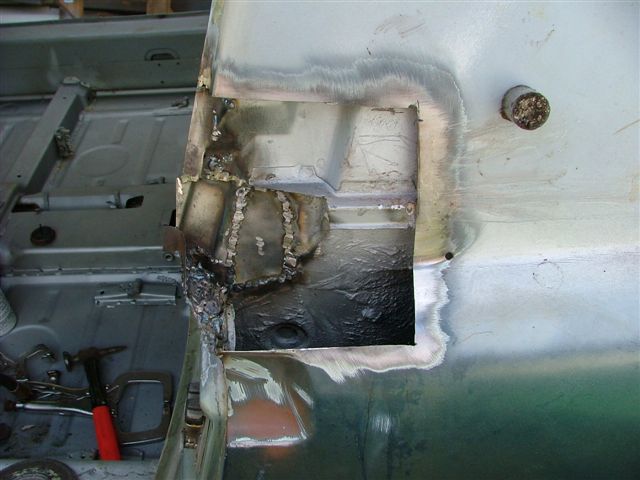

Welded up and ground down. Still needs some more smoothing. I also welded
up all the trim (rust) holes. I plan to glue on any trim to avoid these leaks.
The area above the door vent was pretty thin. I built it up from the top using
weld beads. I backed it up from the outside with pieces of copper sheet. This
is going to need more work to look decent.
Making these weird shaped, little patches is very time consuming. I'd much rather
weld up a hell hole or plug weld an inner long replacement.

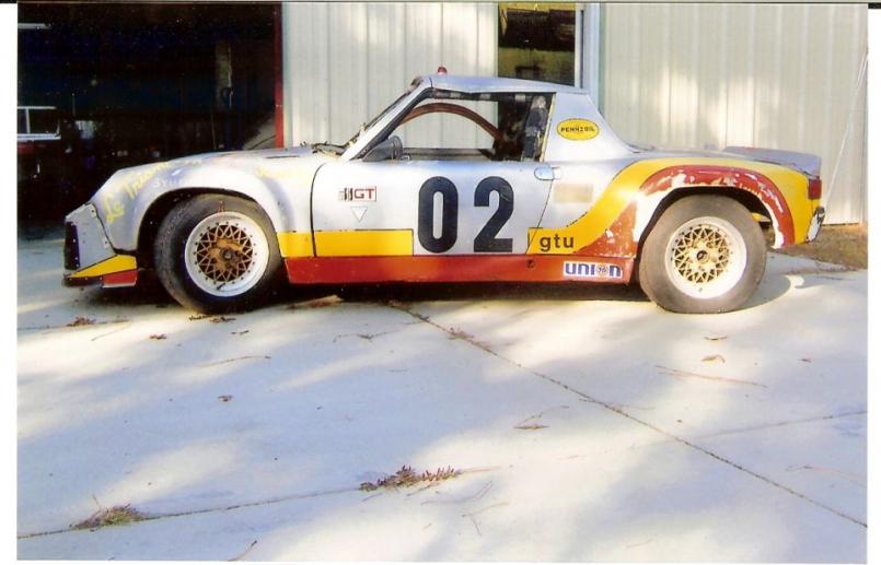

That is right. I was debating joining the group buy for flares but I want to get it on
the road, and I am ready to move on from bodywork. Maybe later.
I have 6x16 fuchs and was thinking of 205/50s to be sure they will fit.
I have a pair of 7x16 fuchs I could use on the rear. Gonna order tires this
week so I need to decide what brand and size to buy.

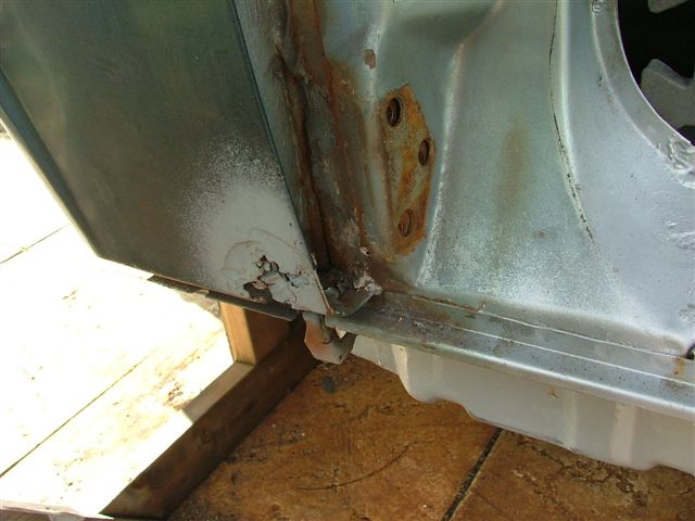

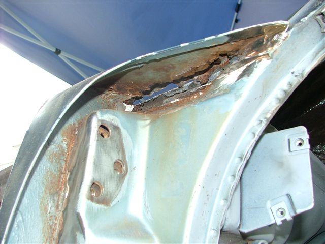

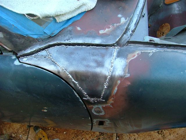

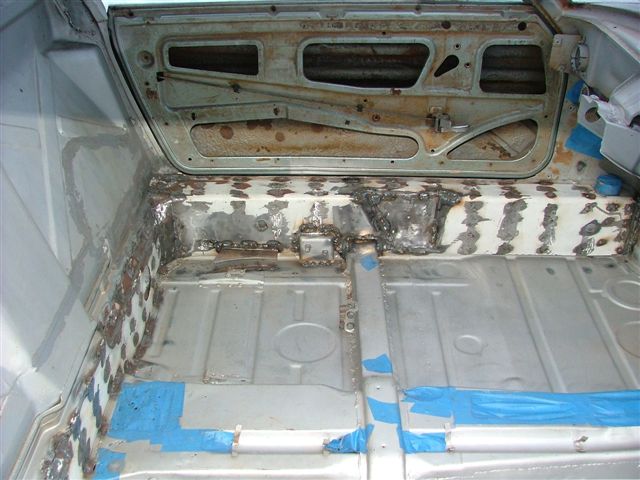

Fixing the passenger side cowl and fender. Cleaned it up and cut out the rusted
metal. When I got the car I sprayed the rusty areas with rustoleum rusty metal
primer. No cleaning or anything first. It did a good job of preventing the rust
from getting any worse over the last year.
Patched up the hood channels.
Patched the side of the cowl.
Patched the windshield surround and ground it all up.
Started making a patch for the fender and ran out of gas for the day.
I know there is a right way to attach a fender to a 914 and I am pretty sure
that this is not it...

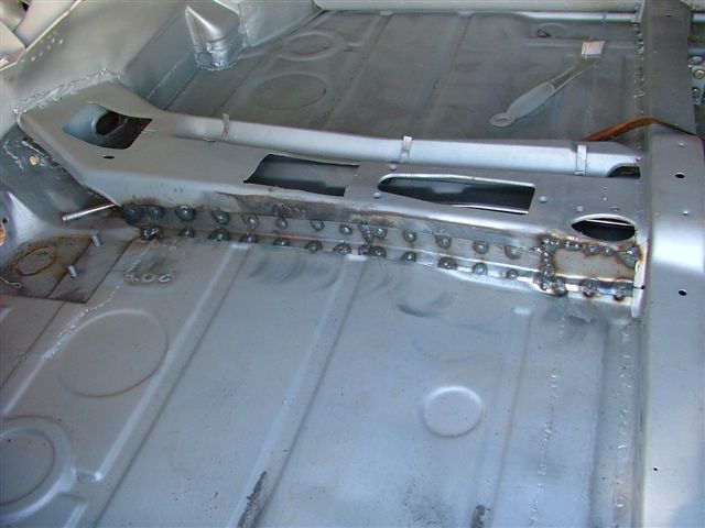

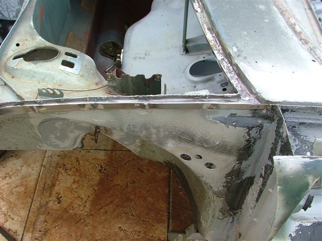

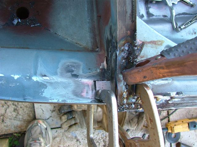

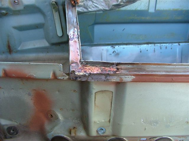

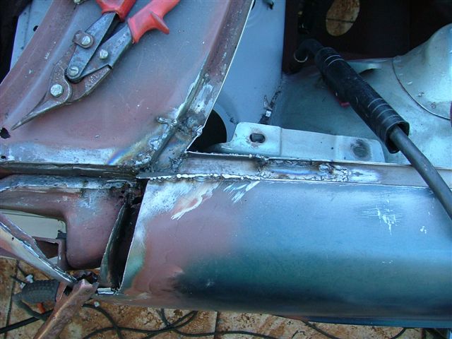

Cleaning up a few last areas. Welded on the last bits of the tunnel.
Cut the rust out of the passenger headlight bucket.
Pass me another f-ing clamp.

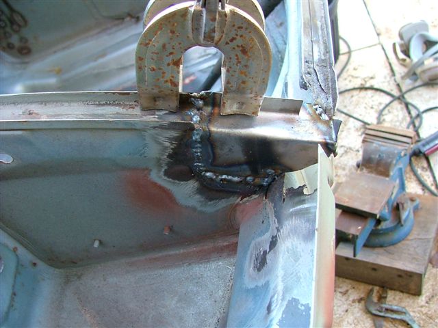

Weld up the rain gutter using a piece of copper backing behind it.
Grind the welds so far.
Weld on a patch on the bottom of the hole.
Grind it kinda smooth.
Almost time to get out the wagner power painter and a gallon of exterior latex...

just a few little holes:
Open it up and see why people say 914s rust from the inside out.
Cleaned it up, not too bad. I'll have to fix this another day. This area seems
designed to trap dirt and water thrown up by the rear wheels and cause rust.
Porsche could have designed a better way to seal up this area. The foam they
sprayed in here was where the rust was the worst.
There always seems to be just one more rust hole...
