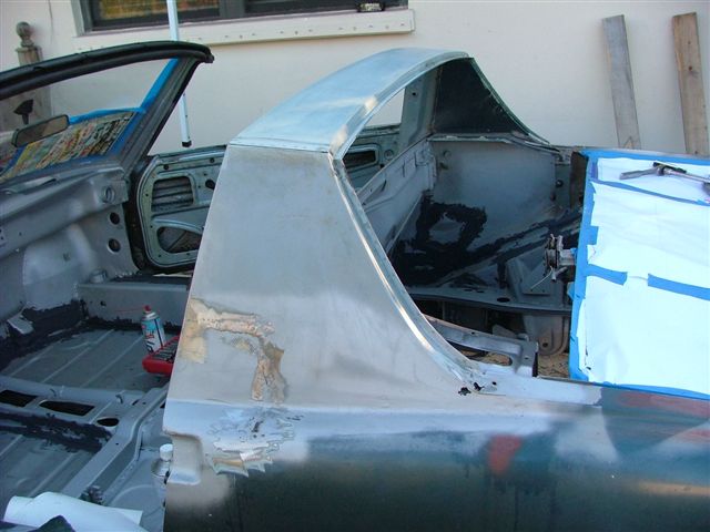

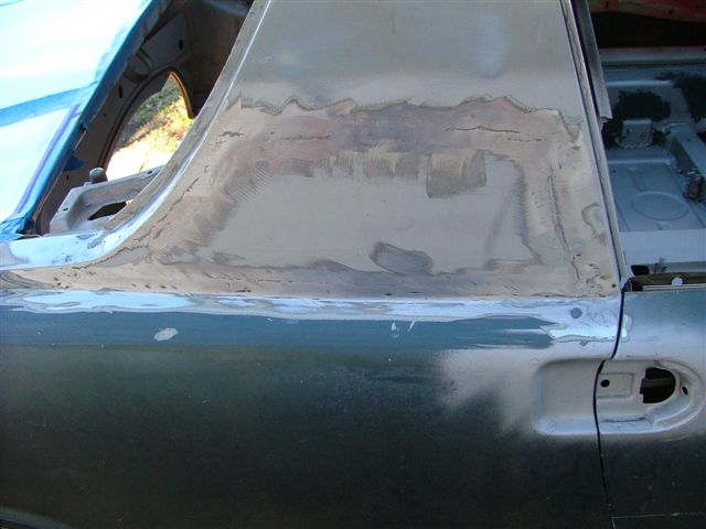

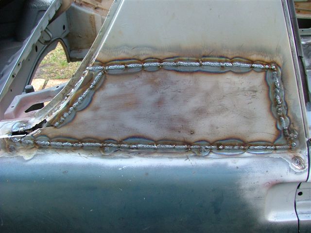

Had a few minutes today to weld up the passenger sail.
Still needs another small patch.

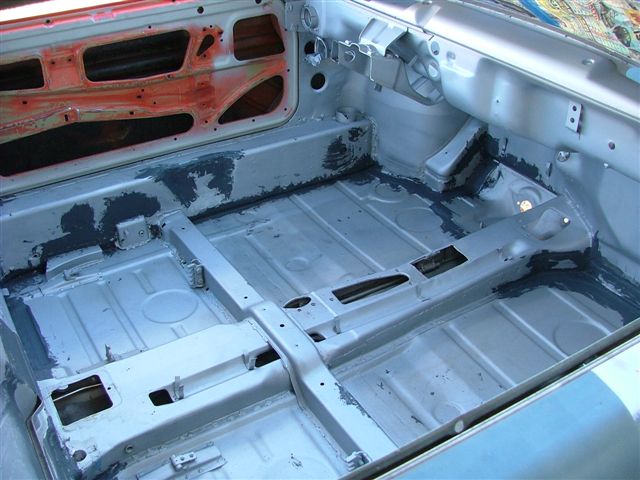

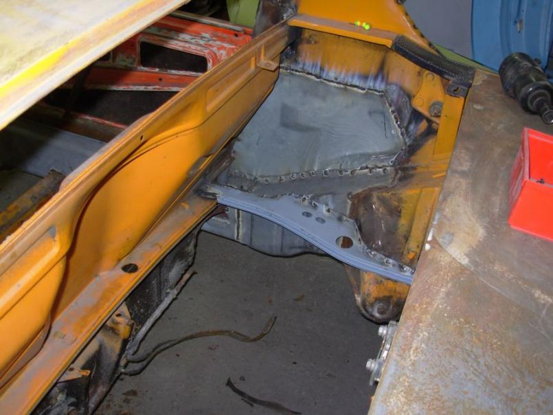

The cleanup continues. Ground the passenger sail panel.
Seam sealed the engine bay and passenger area. I really globbed the sealer on.
The so called brushable sealer is really a pain to put on neatly.

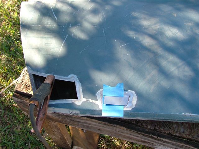

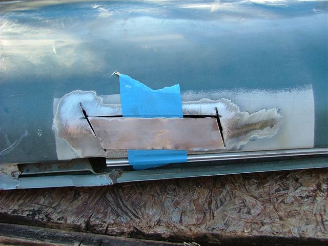

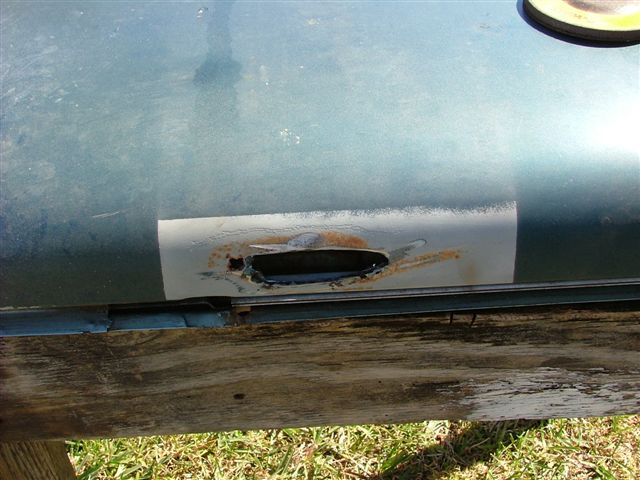

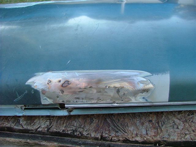

Spent 6 hours today fixing my passenger door. I sand blasted the inside as much
as I could to remove all the rust. There were 5 areas which had rusted through.
The PO thoughtfully fixed this hole by putting on a layer of plastic tape and then
painting over it. (IMG:style_emoticons/default/mad.gif)
Any newbie knows you need at least 2 layers of tape for it to be considered a
permanent repair. (IMG:style_emoticons/default/laugh.gif)
Remember this when you are inspecting that newly painted car that is for sale.
This atrocity was actually pretty well hidden unless you looked for it.
I hope it does not hurt the "originality" of the car by not repairing it again with
tape, but I thought maybe metal would be better.
Using tape behind the patch helps hold it flush. This works better than taping
on the top of the patch because the mig wire just pushes the patch off the tape
that way. Welded and ground it down.
Fixing some other holes.
Ground them.
I was using an air gun to cool the welds as I went, but I must have overheated
the door skin because I ended up warping it nicely. There are a couple high
spots and one big oil canned spot. I tried shrinking it with a propane torch and
wet rag but it did not help much.
So how do I shrink these spots?
Metal shinking disc? At least I've seen it done that way in other restos.
Just found a link: Linky

Those shrinking disks scare me. I have heard of them exploding and cutting
people up badly. Maybe that is just me being paranoid.
I tried using acetylene and managed to remove the oil canning (think pressing in
on the metal and it snapping back out) but could not completely flatten it. This
is partly because you can't get to the back of the panel due to the door beams
but mostly due to the fact that I don't know what I am doing.
Seam sealer: I believe you use it on all welded seams except the outside skin
of the car. The layers of the paint job should protect these seams from water.

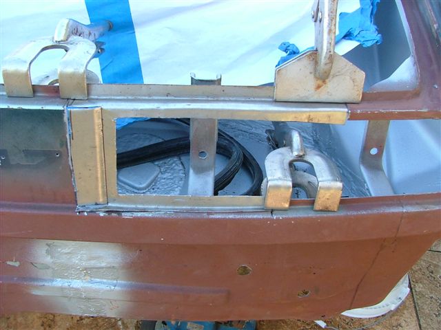

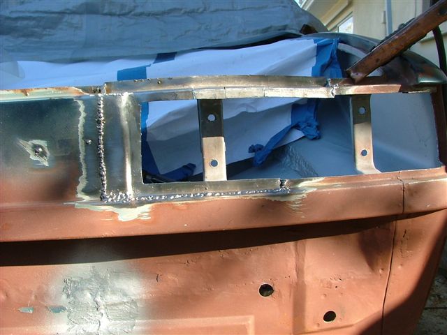

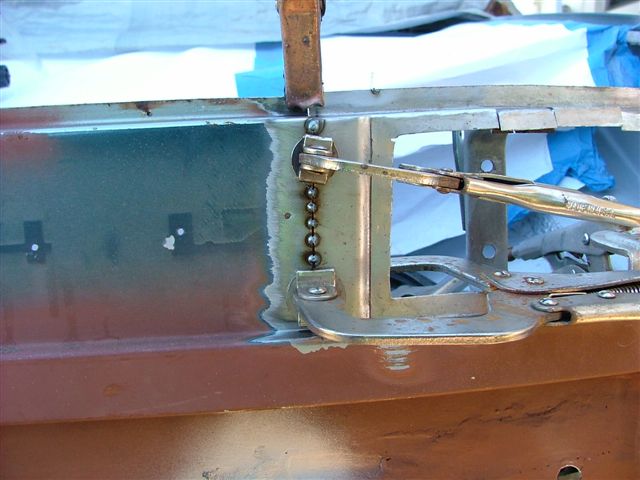

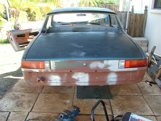

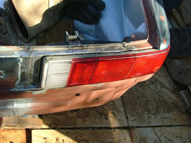

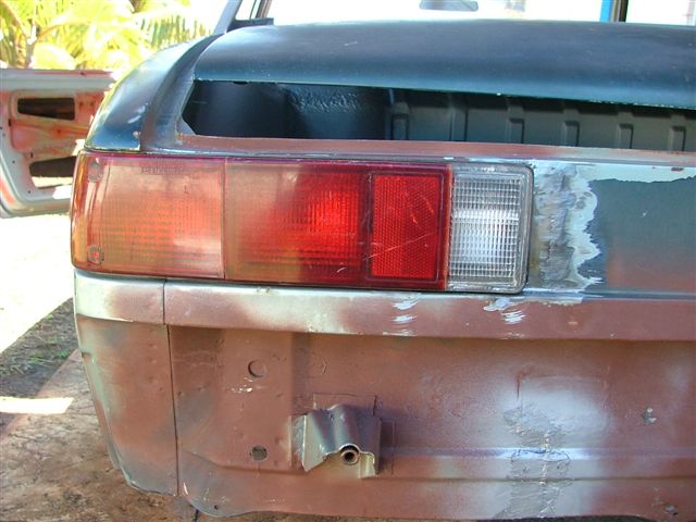

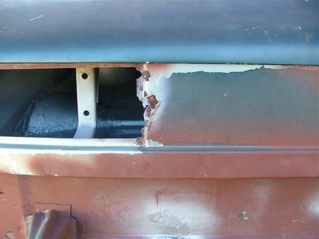

Passenger tail light opening was horribly rusted. I cut it out and made a
replacement piece. This took a hour or so to make using the flimsy little
brake I have.

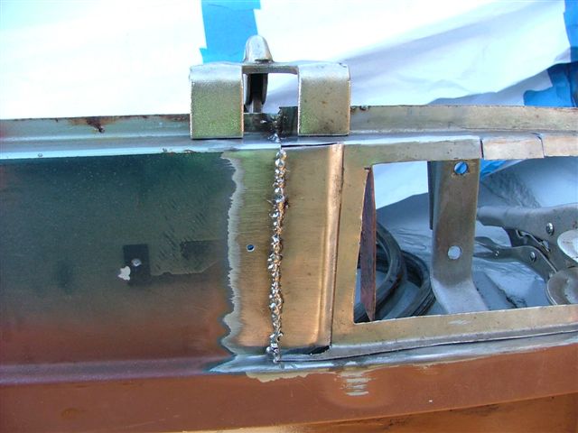

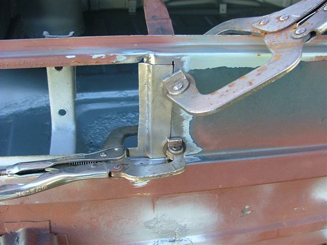

Clamped a piece of flattened, copper pipe behind the seam. I really tried to
weld slowly to avoid warping this thin sheet metal.
Put on a few tacks, stop, take a picture, wait a while.
Keep on until it is fully welded.
Slowly welded the rest. Using a copper backer makes a really big difference.
I like to use a lot of clamps to also take up some of the heat.
Test fit the tail light. I needed to do some trimming and hammering to make
it fit like this.
Painted and ready to rust out all over again.

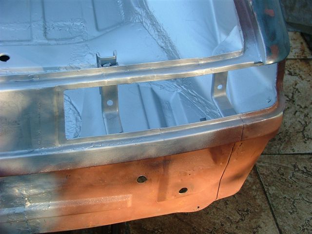

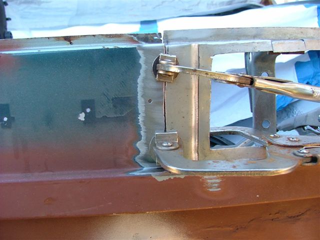

You call this a rust spot??? Pfffftttt!
I guess I have to fix it...
All welded and grounded up. Checking the tail light fit.
Wow, the tail lights and trunk lid still fit.
Now working on stripping the old paint and troweling on the bondo.

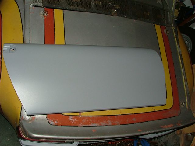

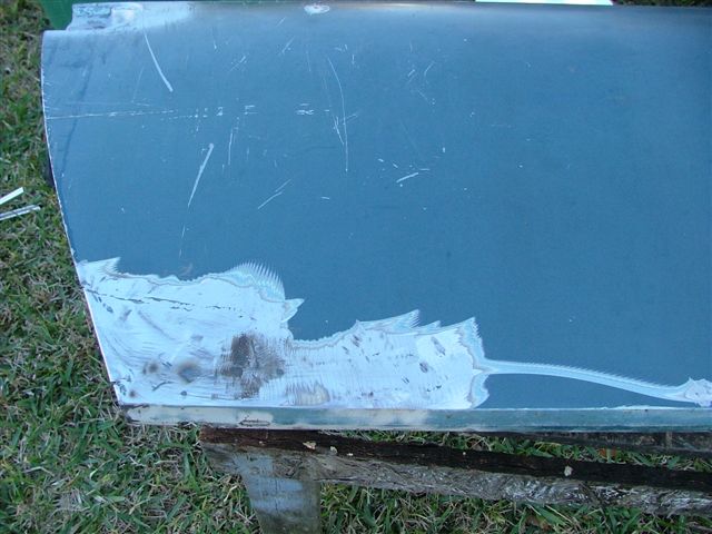

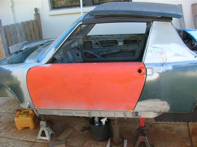

I refurbished my old passenger door. It took about 4 or 5 hours and about
a gallon of bondo to smooth it out, ok, maybe a quart. (IMG:style_emoticons/default/blink.gif) This is the
door I was welding on a few days ago.
I used my new fuji turbine sprayer for the first time and managed to put a
nicely orange peeled couple coats of epoxy primer on it.
Here it is resting on the IMSA car to keep it out of the weather. It looks better
in the picture than in reality.
