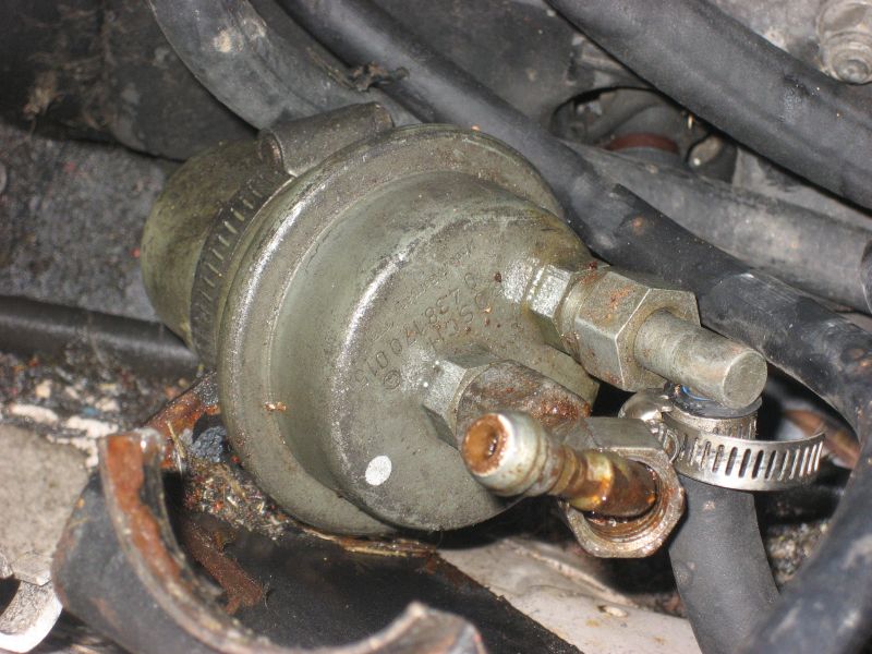

First, I was under there cleaning stuff up. I noticed this on the passenger side of the trans.
I assume that it is the throttle cable, but being this is my first /6, I need to confirm.

rick 918-S   Yes, that's your throttle linkage. I think you...   Dec 17 2007, 08:51 AM
