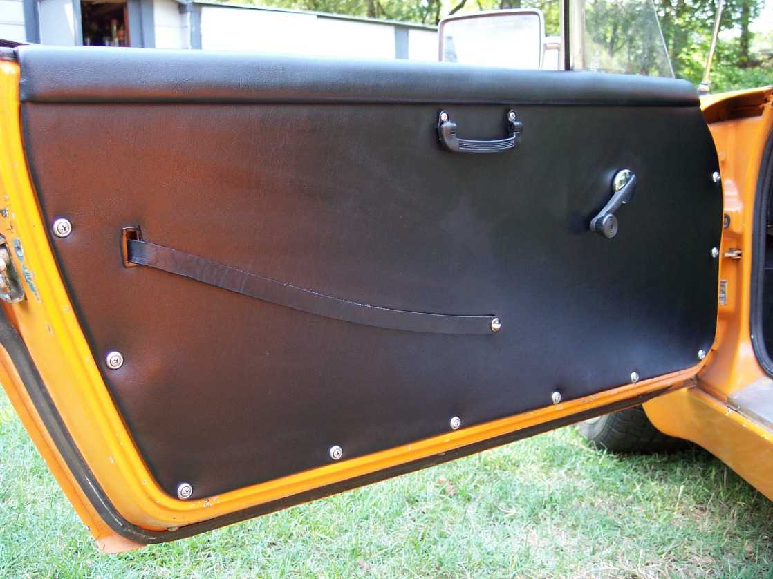

I like the looks of the standard panel. Will it have a pull? Perhaps a red one like on the 911 RS?
We are still scratching our head on how to do that. The main problem is engineering a way to lock and unlock the door from the inside as the lock unlock mechanism is intergrated with the latch handle. Any thoughts?
Bob
BTW the pic you posted is of our 911/912/930 RS America offerings, where did you find that pic? Was it from our website www.appbiz.com ?
I was thinking of keeping the handle, but just adding a red pull, so I guess it wouldn't be exactly like the 911 RS panel.
I did a google image search and that photo was one of the first ones that came up.

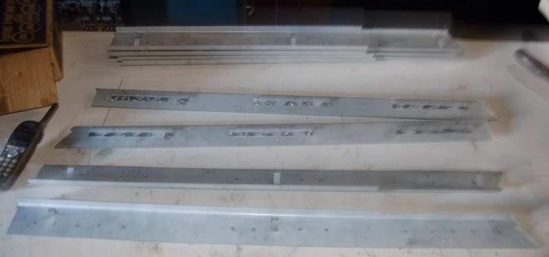

Our 914 panels have a formed galvanized steel top section. We spent a year trying to get these panels right, we tried forming particle board (like some of the OEM panels), we tried vaccum forming it, we tried fiberglass. We just were not happy with the results. In the end we found the steel top was the way to go. The factory used steel on some 914 panels, but most were formed particle board.
Unlike the factory "formed particle board panels" ours are very easy to recover, and can be redone again and again. You pretty much destroy the factory ones trying to recover them.
I'm attaching a pic of the top portion of our panels. As you can see we are serious about this project and have spent quite a bit on tooling to get these right .
Again keep your comments comming, positve or negative and lets build a good product together!

That looks like serious job ou want to do.
I think you go the right way if you can provide the panel the customer wants. So many 914's, so many panels ...

Looked at your post on the recovering, very good work, BRAVO!
Our top piece is a bit easier to recover, we have a channel that is spot welded to the face so you merely slide the wood or cardboard strip under it.
Again really really nice work on restoring the old panels

Alright I spoke with Bob yesterday, nice guy. He sent me a picture of the 'GT' panel and quoted me (as a PCA member...:-) a total of $220 to make them with the supplied door pull hardware that I have and EVEN offered to emboss the edge of the door strap whith a machine that they had found in a barn....original Porsche stuff!. Anyway once the holidays are over I'll be sending him my stuffso he can make a panel just like this.......
I BELIEVE I purchased the door pull and stuff from Ebay??? Please remember I have been purchasing 'stuff' for this conversion for over 2 yrs...
Oh...he said the panels are masonite...stock type stuff. As my car will be a queen of the shop and dry road I am not too worried bout decay.

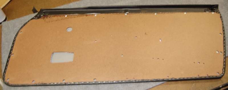

Here is a pic of the backside of the 914 panels right after uphostery. They can be reuphostered without removing the rivets that hold the steel top piece to the lower masonite panel.
