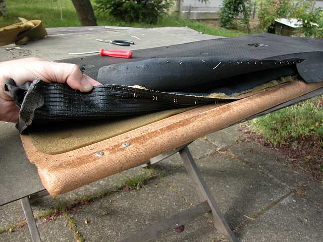

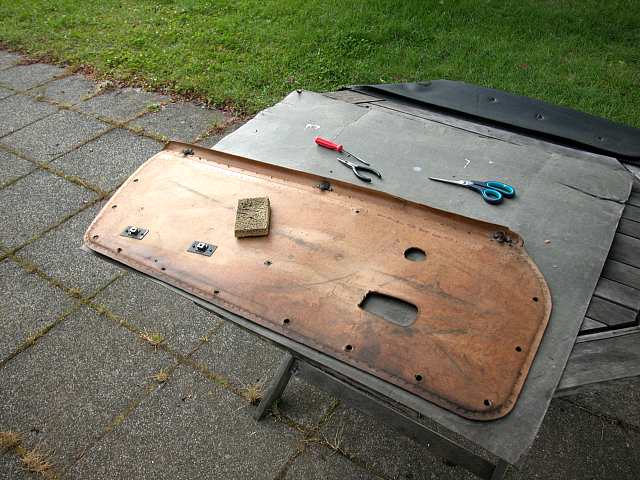

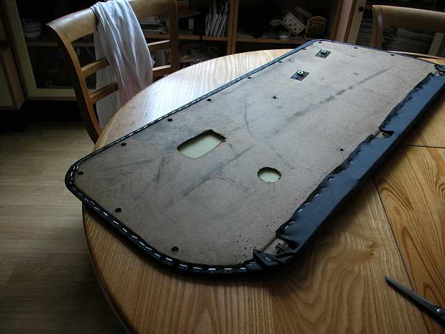

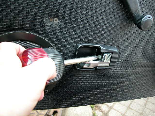

Now , its time to remove those ugly panels. I don't like speakers and WTF is this screw doing here ?
(IMG:http://www.914world.com/bbs2/uploads_offsite/johannes.roussel.free.fr-179-1274227825.1.JPG)
I assume you know how to remove panels ... I took pictures anyway ...
(IMG:http://www.914world.com/bbs2/uploads_offsite/johannes.roussel.free.fr-179-1274227829.2.JPG)
(IMG:http://www.914world.com/bbs2/uploads_offsite/johannes.roussel.free.fr-179-1274227833.3.JPG)

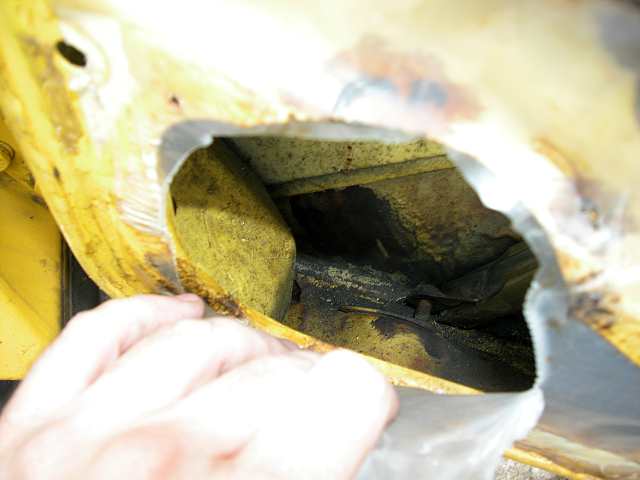

Look m'a ... no rust (IMG:style_emoticons/default/smile.gif)
(IMG:http://www.914world.com/bbs2/uploads_offsite/johannes.roussel.free.fr-179-1274227837.4.JPG)

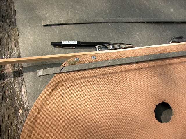

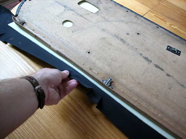

I found some panels with no holes ... The vinyl was in bad shape but the core panel was almost OK ... Tht's what I was looking for ...
First of all, I removed the old vinyl.
(IMG:http://www.914world.com/bbs2/uploads_offsite/johannes.roussel.free.fr-179-1274227839.5.JPG)

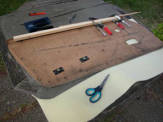

Now, let's clean this 30 years old dust
(IMG:http://www.914world.com/bbs2/uploads_offsite/johannes.roussel.free.fr-179-1274227843.6.JPG)

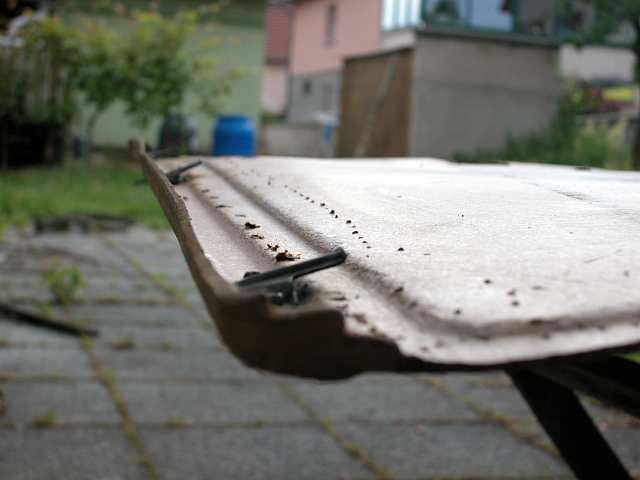

Not that straight, but steam will cure that
(IMG:http://www.914world.com/bbs2/uploads_offsite/johannes.roussel.free.fr-179-1274227846.7.JPG)

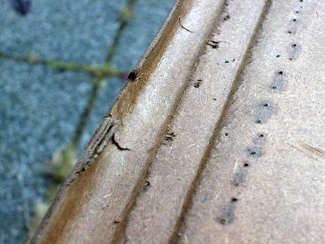

Some repairs will be needed too
(IMG:http://www.914world.com/bbs2/uploads_offsite/johannes.roussel.free.fr-179-1274227850.8.JPG)

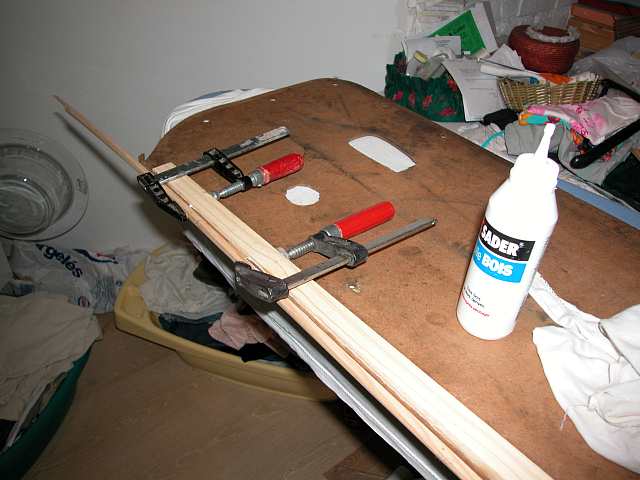

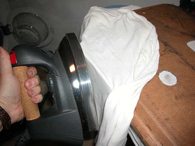

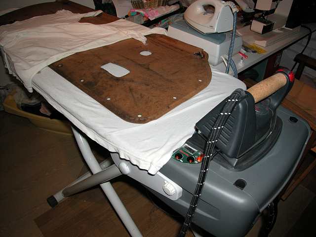

With a good steam iron I got the panel straight again

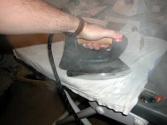

Ready for some steam ????
(IMG:http://www.914world.com/bbs2/uploads_offsite/johannes.roussel.free.fr-179-1274227939.1.JPG)
This gonna be straight again ... Done that while my wife was out. She better doesn't see that (IMG:style_emoticons/default/smile.gif)
(IMG:http://www.914world.com/bbs2/uploads_offsite/johannes.roussel.free.fr-179-1274227942.2.JPG)
(IMG:http://www.914world.com/bbs2/uploads_offsite/johannes.roussel.free.fr-179-1274227945.3.JPG)
A bit of glue ... to repair what you have seen before
(IMG:http://www.914world.com/bbs2/uploads_offsite/johannes.roussel.free.fr-179-1274227949.4.JPG)

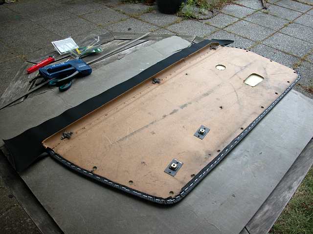

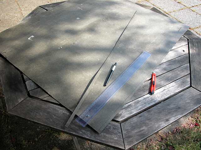

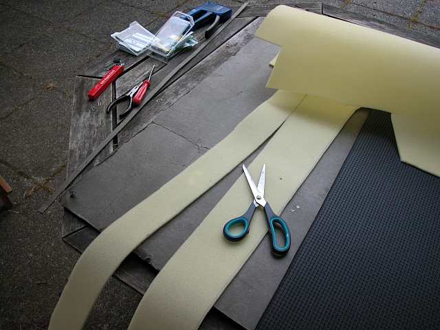

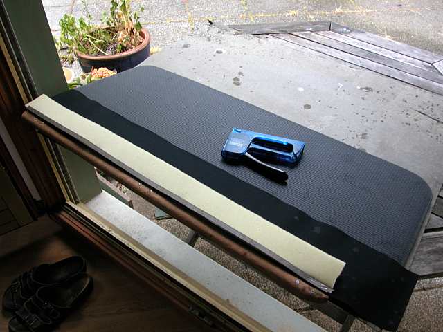

While the glue is drying let's cut two bands of heavy paperboard. This one is 2mm thick
(IMG:http://www.914world.com/bbs2/uploads_offsite/johannes.roussel.free.fr-179-1274227953.5.JPG)
Cut it to the right length
(IMG:http://www.914world.com/bbs2/uploads_offsite/johannes.roussel.free.fr-179-1274227956.6.JPG)

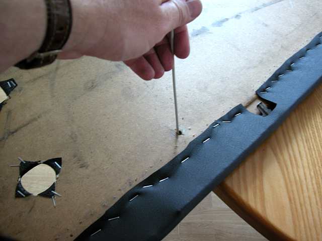

A few staples to maintain the foam at the right place
(IMG:http://www.914world.com/bbs2/uploads_offsite/johannes.roussel.free.fr-179-1274227961.7.JPG)

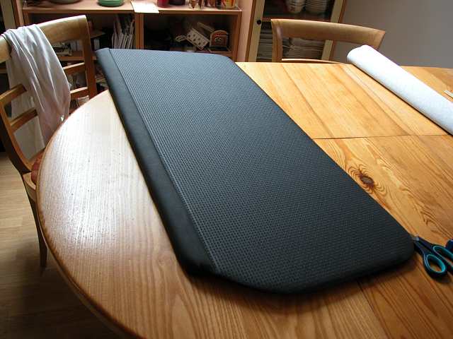

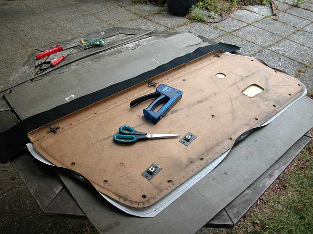

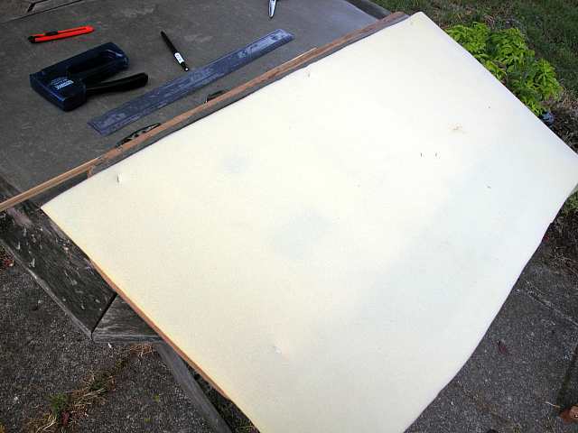

Cut the foam to fit
(IMG:http://www.914world.com/bbs2/uploads_offsite/johannes.roussel.free.fr-179-1274228004.1.JPG)

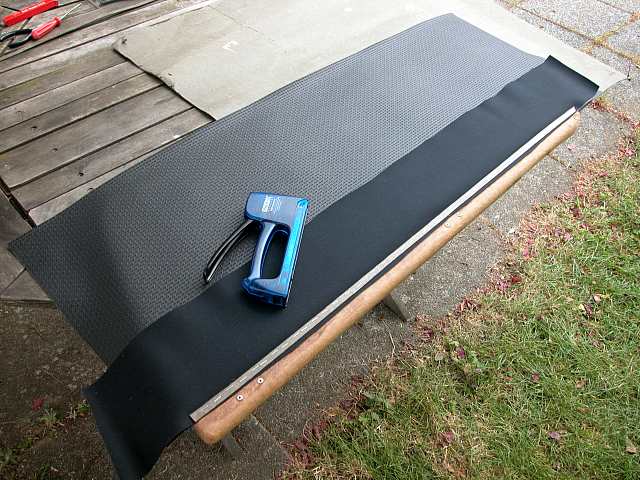

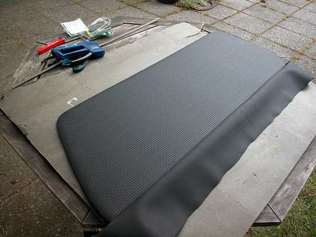

Put the large basketweave vinyl and the small smooth vinyl. Smooth vinyl must be reversed ... the first paperboard band and stapple ! Use long stapples this time. I used 6 mm this time
(IMG:http://www.914world.com/bbs2/uploads_offsite/johannes.roussel.free.fr-179-1274228008.2.JPG)
Cut the basketweave vinyl so it fits.
(IMG:http://www.914world.com/bbs2/uploads_offsite/johannes.roussel.free.fr-179-1274228013.3.JPG)
Stapple ... short stapples needed . I used 4mm
(IMG:http://www.914world.com/bbs2/uploads_offsite/johannes.roussel.free.fr-179-1274228017.4.JPG)
Nice ! no folds (IMG:style_emoticons/default/smile.gif)
(IMG:http://www.914world.com/bbs2/uploads_offsite/johannes.roussel.free.fr-179-1274228021.5.JPG)

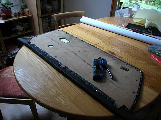

Stapple the foam with the second band of paperboard ... over the first band
I know, this is not the way it was done on the original door, but this way I avoid using glue ... I hate glue, it has to dry and it stinks !
(IMG:http://www.914world.com/bbs2/uploads_offsite/johannes.roussel.free.fr-179-1274228109.1.JPG)
(IMG:http://www.914world.com/bbs2/uploads_offsite/johannes.roussel.free.fr-179-1274228115.2.JPG)
(IMG:http://www.914world.com/bbs2/uploads_offsite/johannes.roussel.free.fr-179-1274228118.3.JPG)
Not bad for a beginner (IMG:style_emoticons/default/smile.gif)
(IMG:http://www.914world.com/bbs2/uploads_offsite/johannes.roussel.free.fr-179-1274228123.4.JPG)

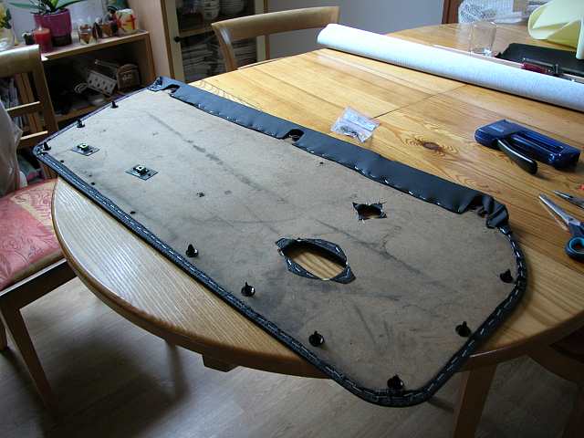

Make the holes
(IMG:http://www.914world.com/bbs2/uploads_offsite/johannes.roussel.free.fr-179-1274228214.1.JPG)
(IMG:http://www.914world.com/bbs2/uploads_offsite/johannes.roussel.free.fr-179-1274228218.2.JPG)
New attaches
(IMG:http://www.914world.com/bbs2/uploads_offsite/johannes.roussel.free.fr-179-1274228223.3.JPG)

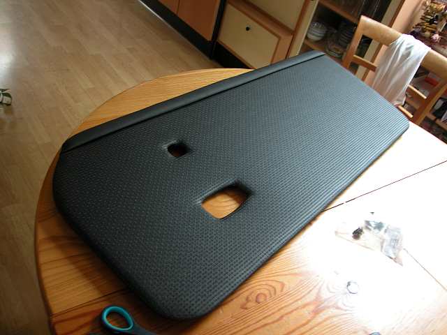

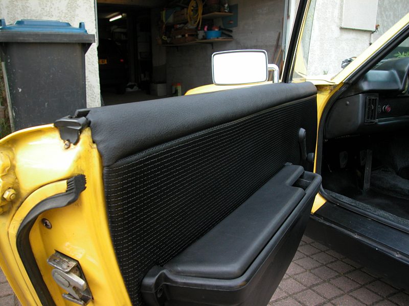

Et voilĂ  ...
(IMG:http://www.914world.com/bbs2/uploads_offsite/johannes.roussel.free.fr-179-1274228259.1.JPG)
(IMG:http://www.914world.com/bbs2/uploads_offsite/johannes.roussel.free.fr-179-1274228262.2.JPG)
