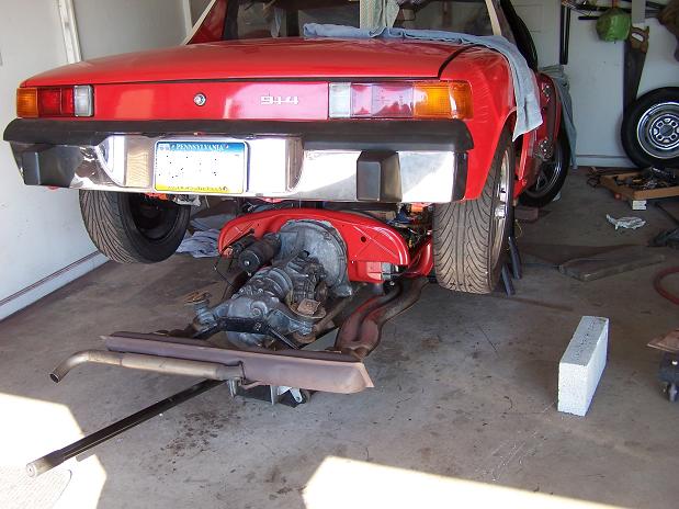

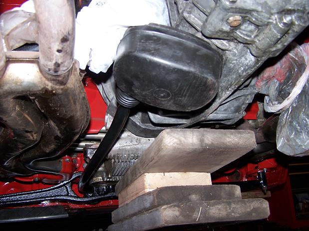

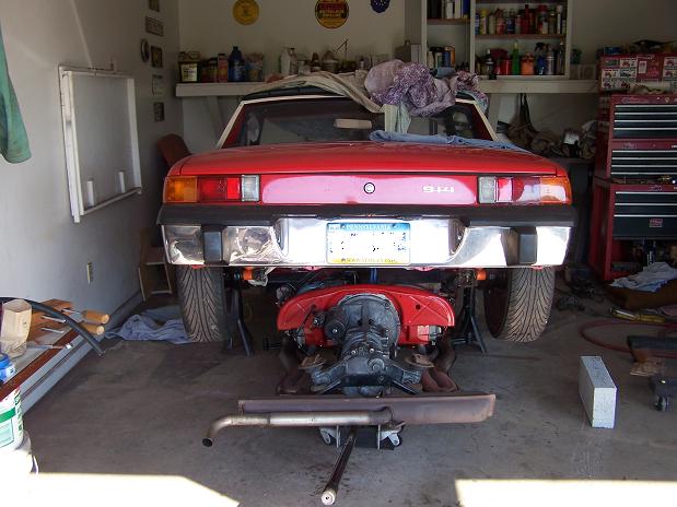

Engine is installed!!!
It was a one man job. I used a piece of 2x8 by 16 inches under the engine and tranny and kept adjusting the position of the jack until the engine was perfectly balanced.
Only had 2 snufus:
1) The fuel injectors+hoses stuck out just a little too far and had to be removed before installation.
2) I jacked the car up so high that I couldn't get the engine totally in with the jack. I got the engine bar secured but the tranny was about 8 inches low with full jack extension. So I temporarily supported the tranny and got several more 2x8s and put them on top of the jack to get the necessary height.

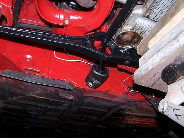

My 71 is now a sideshift car.

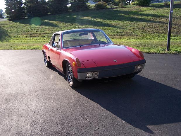

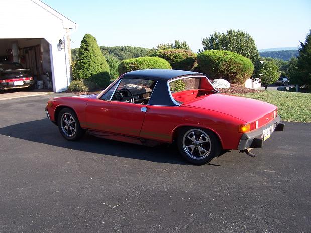

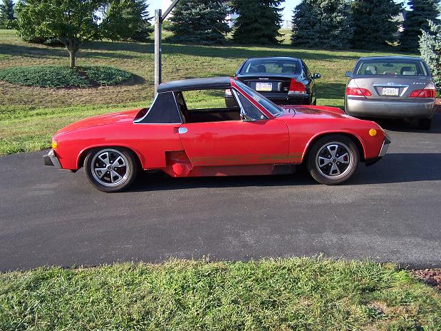

First Drive!! It runs ok, doesn't idle real nice but gets along when on the gas.
The car is registered and insured so it is technically drivable. Yeah it has a hole in the fender. I'll tack on the piece cut out just to get it inspected.

PA State inspected! (IMG:style_emoticons/default/piratenanner.gif) (IMG:style_emoticons/default/cheer.gif) (IMG:style_emoticons/default/aktion035.gif) (IMG:style_emoticons/default/smilie_pokal.gif) (IMG:style_emoticons/default/KMA.gif) (IMG:style_emoticons/default/beerchug.gif)
I had to put the e-brake cables in as well as the e-brake handle for the inspection.

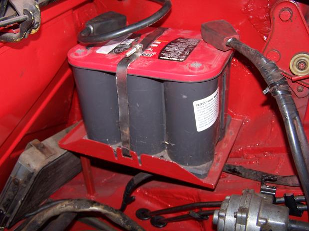

The last order of business for the inspection was to tie down the battery. My mount is a FLAPS special that originally held the battery secure in the trunk. I used the mount when I relocated the battery to the engine compartment. I made the hold-down straps out of 18 ga steel and drilled a hole for the bolt to secure everything. The battery is rock solid.

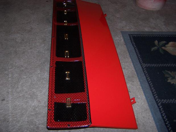

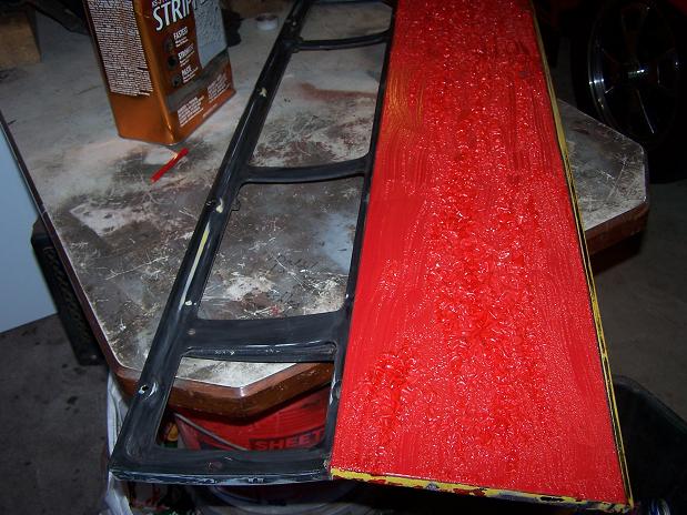

Then the "While you're in there" syndrome took over and now I'm stripping and painting the entire engine lid. So a missing "S" has led to a full strip and paint of the engine lid.

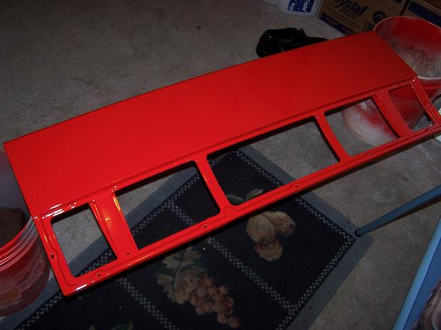

Strip paint in the morning, prime and paint all in one day.

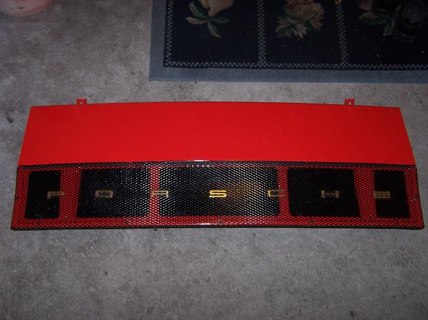

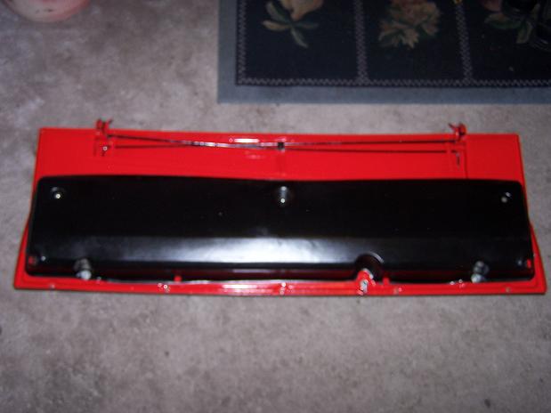

Got the engine lid back together. It's amazing how much work it took to put the "S" back on the lid. (IMG:style_emoticons/default/poke.gif)
But it sure does look pretty.

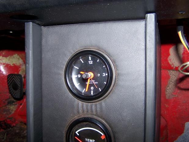

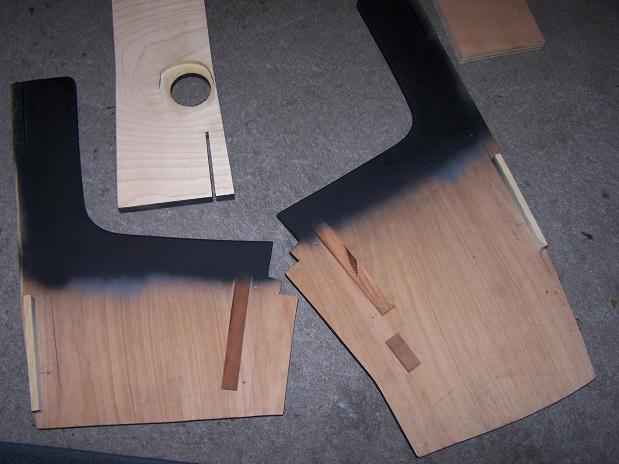

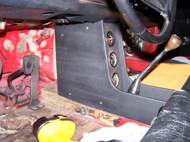

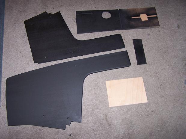

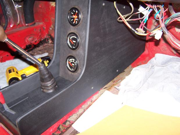

I made a center console (actually this is the 2nd one) from wood using the original as a starting template.
The sides are high enough that they wedge in between the floor and the dash and thus do not need any securing straps.
I made the opening for the shifter to use the original shifter boot so I don't need one of the vinyl console ones.
An original gauge faceplate sits right in the slot of the bottom panel and just rests between the 2 side panels.
Spoke
post Nov 17 2010, 08:47 PM
Post #192
Jerry
Posts: 7,438
Joined: 29-October 04
From: Allentown, PA
Member No.: 3,031
Install goes like clockwork.
Speaking of clockwork, this is the 3rd clock I've installed in the console. The first 2 were the motor driven type that originally came in the 914. Both have had some gear degradation leading to clock failure.
This one is a later model VDO unit that I got off of evilbay. This one is a quartz driven clock with second hand. It was originally a 2inch clock that I modified an original 2-3/8 inch case to accept the clock mechanism. I used the original 2-3/8 face, protective clear face and bezel.

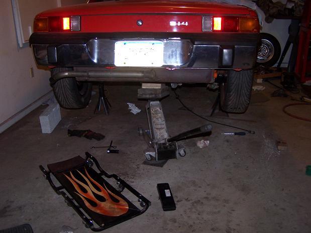

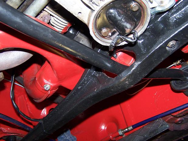

Got the oil temp sender installed. Had to make the gasket between the seal plate and protection plate. Yea, no leaks.
I ran the wire along the engine bar and up through the grommet for the alternator wires. I put the wire in heat shrink tubing to protect the wire under the car.

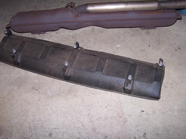

Remounted the muffler heat shield. I mounted it before with bolts instead of rewelding it back on.
This worked good when I decided to clean up and paint the bottom of the car. Only took about 5 minutes to reinstall.

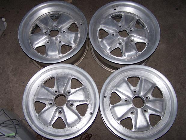

Just arrived this weekend.

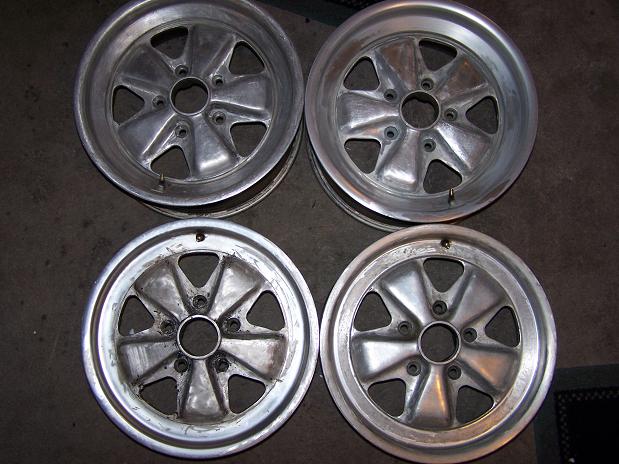

They're not pretty but the price was right. 6x16 and 7x16 Fuchs for $400 shipped.
I need to clean these up but that's ok since I need to procure the necessary 5-lug suspension pieces before mounting. Will be looking for 911 struts with 3.5inch calipers.
I plan to polish the rims and petals and paint the background black.
Spoke
post Dec 8 2010, 06:57 AM
Post #198
Jerry
Posts: 7,438
From: Allentown, PA
Member No.: 3,031
Removed the anodizing with EZ-Off.

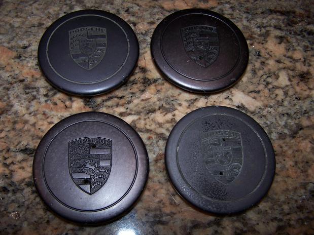

Oh, yeah, the wheel deal included center caps.
