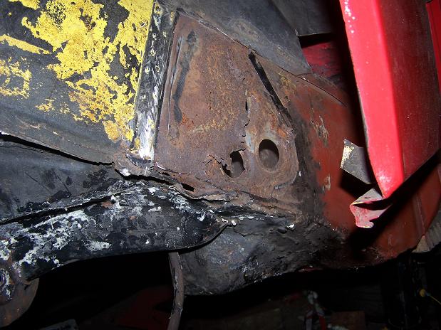

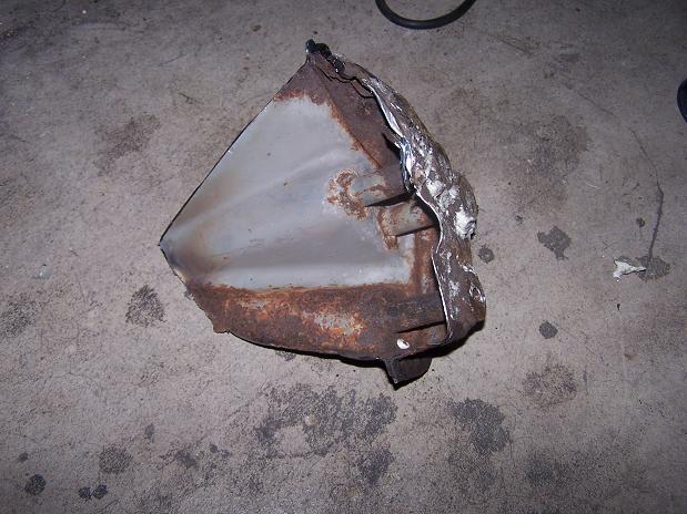

After some deliberation, I decided to investigate what is under the outside suspension pickup. There used to be more metal under there.
There is still some metal left on the pickup. I'll build up with new steel what has thinned out.

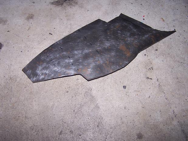

Home made clamshell ready to be welded in place. This will go from above the suspension pickup all the way to the jack support.

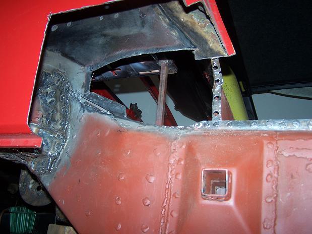

The suspension pick-up will be seam welded, then these 16 gauge plates will secure the pick-up on the long.
post Nov 16 2009, 04:17 AM
Post #71
Jerry
Posts: 7,438
Joined: 29-October 04
From: Allentown, PA
Member No.: 3,031
The suspension pick-up is welded on including the support plates.
The geometry of this corner is all messed up from the previous hell hole repair where the inside suspension pick-up was replaced and mounted about 3/4 of an inch too low.
This means for proper camber I needed almost 1 inch of shim plates. Since I would never be removing the inside suspensino pick-up, I decided to lower the outside suspension pick-up about 5/8 of an inch to minimize the stack of shims needed. This drop can be observed by looking at the support strap to the fender.

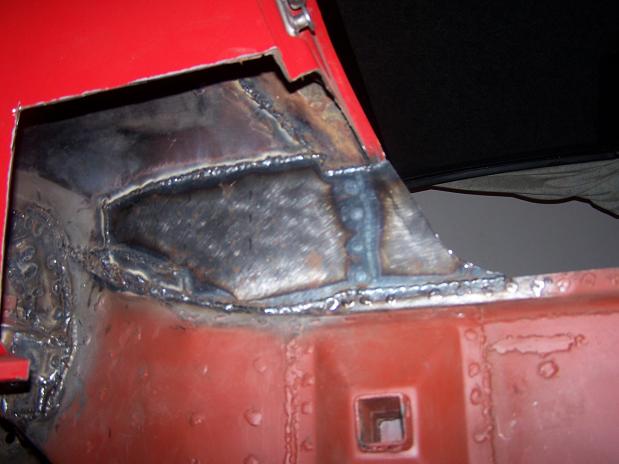

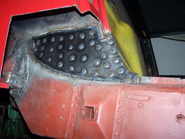

Finally time to patch up the hole looking into the hell hole. All work in the hole is done.
The replacement plate is 16 gauge.
post Nov 16 2009, 05:03 AM
Post #73
Jerry
Posts: 7,438
From: Allentown, PA
Member No.: 3,031
Support plates between inner and outer suspension pick-ups are welded in.
A PO repair to the inner fender wall only seam welded the new wall from the inside. Now the replacement piece is welded from the outside as well.

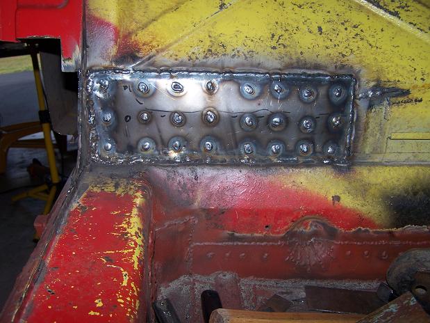

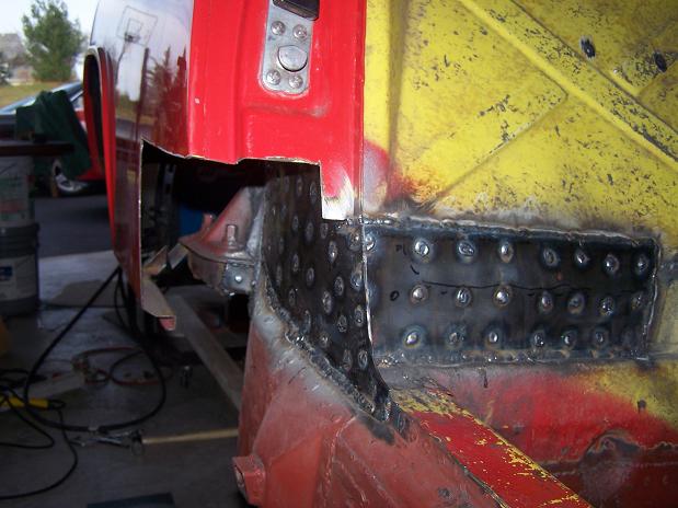

The original hell hole repair put that little patch on the firewall over the long. It's thin metal. I can't tell if 18 or 20 gauge. So I will put a support plate of 16 gauge over it.
Same thing with the inner fender wall. Another plate of 16 gauge will cover this area although it has a 2nd purpose. The front part of the plate makes up the seam around the door where the weatherstipping goes.
Plates ready to go.
post Nov 21 2009, 08:48 AM
Post #78
Jerry
Posts: 7,438
From: Allentown, PA
Member No.: 3,031
And Presto! The 2 plates may add a little bit to the rigidity of the chassis.

The passenger side engine shelf is a replacement. Here's the backside of the replacement engine shelf folded up under the existing metal.
It's a lot more fun welding 16 gauge steel versus half rusted 18 or 20 gauge, whatever the engine tin is. Also seam welded the part of the long over the rear suspension.
